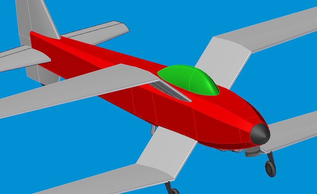

Pattern design according to the flyncajun
ORIGINAL: flyncajun
When I started designing Pattern Aircraft
I was told the Stab had to be lowered to keep the airplane from pitching to the belly on Rudder( wrong)
I was told SSS was Causing the airplane to pitch to the Belly on left rudder, But right rudder ,,Not so much (wrong)
I was told down thrust was how you kept an airplane from pulling to the canopy in a verical up line (wrong)
I was told you can`t get the mix out of a airplane because the SSS put unequal pressures on the surfaces,you just have to live with it (wrong)
I was told Wide tall fuses would fly terribe in the wind(wrong)
I was told a heavy airplane flew better in the wind (wrong)
I was told the airplane had to be built with wing, stab set to zero (wrong)
I was told there is no way to perform a Knife edge loop with no Mix purley on rudder command (wrong)
I was told anhedral stabs countered too much dihedral in the wing (wrong)
I was told you had to run the C/G back around 35 % so the airplane used just a little down elevator (wrong)
I was told you need minimun of 2 degrees right thrust (wrong)
I was told to start out with 1.5 deg down thrust (wrong)
I was told a forward canopy rolled better (wrong)
I was told fixed gear were less drag than retracts (wrong)
I was told there had to be a left rudder mix at low throttle (wrong )
I was told you cannot use Sharp leading edges on your wings and stabs the airplanes would be pitchy in flight (wrong)
I was told you cannot use counter balances on ailerons (wrong)
I was told you had to run deferential on ailerons to roll axially (wrong)
I WAS TOLD ALL BIPES HAD TO HAVE THE WINGS AT DIFFERENT INC. NEG ON TOP POS ON BOTTOM (WRONG)
I WAS TOLD TO USE UP THRUST ON THE BIPE( WRONG)
I WAS TOLD TO GIVE UP ON THE BIPE (WRONG) the guy who told be that went back to it after seeing mine HAHA
i WAS TOLD BIPES WERE TO COMPLICATED TO HAVE NO MIX (WRONG)
I WAS TOLD TO BE COMPETITIVE TODAY I HAD TO GO TO ELECTRIC (WRONG) had to throw that one in LOL

Can you tell us how you've come up with these, and more importantly how you've overcome some of these issues? This isn't meant to be an attack, I'm seriously interested, as I'm sure are quite a few other modellers.
RE: Pattern design according to the flyncajun
Recently the designer of the Spark e-mailed me and said He liked my Bipe and He was designing a Bipe, and wanted to know my Bipe setup.
I Had a weak Moment and gave a setup to him LOL
So you might be able to pry that one from him, But I cannot just give that info Out anymore. It has cost me 20 Years of my Life, I think it may be worth something.
I figure if you can Buy My designs, reverse engineer it, and just look at the common sense and experience in it, we both win
Every think I do to a design is proven purpose.
Every body knows when they eat a Cake "mostly "what is used to make the batter, and you know all cakes LOOK good ,How much of whats in the batter gives the outcome for the "good" cakes. The chefs never tell what the recipe is for the really good cakes, they would no longer sell the best cakes LOL
Every airplane designed today for competiton by active competitive pilots" Not the knock off look alikes" are worthy airplanes. It is the small details that are missed,what cannot be seen that seperates the knock offs, Competition and understanding of the needs of the airplane in competiton is what makes the really good designs. and they evolve from this. Thats Why My airplanes look like My Airplanes or CHip Or CPLR`s airplanes look like they evolved from a educated Idea. We have a philosophy that evolves from understanding What the goals are.
WE are involved enough and lucky sometimes to see the new power plants available ect. and design around this knowledge before the average guy even knows about new products are being developed around the corner.
An airplane that is not well thought out or designed , starts the chain reaction rolling, and the mixing begins. this mixing seems to be Mystical and we actually like that about it, it gives us endless hours of debate about what it might be. I go out and find what it is, refine it in the next design, and eliminate it. usually when you find the cause for one mix,it is actually the fix for two other problems. they have a way of compounding problems.
We waste our time putting bandades on the sore ,and not curing whats causing the sores. and our new radios actually enable this.
Ever notice every Bip out there has the same wing area ,Why every body copies what they think the other person my know!
I copy myself. and improve on what I know ,When I try to improve on what somebody els knows I fail.
Refinements come from understanding the Needs or Goals of what the Purpose is for the design, Everything done in the design needs to be in Harmony with the Purpose of the design. from the gear to the paint.
Available Power, for the most part, drives the advancement of the design and gives the flexibility in the setup Thats why Props are so effective in changing how a airplane feels , But most can`t feel the good or bad that prop may do to the setup of the design.
I try to design with everything in mind.
Most Guys don`t realize that by having thrust off set in the engine it actually robs power from the prop! this is a small but important detail.
Here is my secret in a nutshell.
Every thing you do the airplane that changes the force required to fly it straight ,causes three other problems (triangulation
This in turn affects Everything and I mean everything , we do to get the airplane to fly without mix. From throw to expo`s
Understanding what percent to make an airfoil,or how much wing area is required to make the aiplane fly without compromising the trim of flight, to how big to make the ailerons ,or how much fin and rudder to use, all contribute to the ability to trim the airplane without mixes.
Then having the skill to seperate these out and find the flaws in the setup, or design ,is what sets me apart ( in my oppinion )
I have had countless students to this philosophy,and very successfull students I might Add
All from a old Coon Ass from down the bayou.
Bryan
From personal experience I can say that a rearward CG makes the plane work okay in inverted flight but makes it uncertain in pitch when upright. Throw in anhedral stab with a rear CG and cross wind flying creates a whole nother set of problems.
I've found that stab anhedral does detractsome wing dihedral. Flatten the stab and yaw response is different, all other things equal. I've found that a small amount of down thrust does correct a pitch to canopy in the full power upline. But it can create other issues so I use the technique sparringly. A slight positive in the stab helps correct both an upline and inverted flight when CG is forward, between 25% and 30% MAC
No way anyone will convince me that a heavy model flies better than the exact same design does10-15% lighter. On CG, I tend not to useCG as a trimming criterion. I tend to calculate it'sideal position based on areas, area distributionand moments, and add 15% static margin. There is nothing magic about 15% static margin, it is something that I've settled on with experience.
I love the flightenvelope ofsmall LE radii. Occasionally I used larger radius on the wing LE in particular and have always been disappointed, Add to the list that thick wings create more lift than thin wings. Baloney! Thick wings are sluggish in pattern apps, plain and simple....
I don't subscribe to the tiny wing syndrome that has invaded patterndom. Properly designed, large wings have all the attributes we want plus they reduce loading, which enlarges a model's flight envelope. I don't subscribe to flared rudders or thick TE's. I don't subscribe to canalizers. Dorsals and ventrals, definitely, and not just on fuselages....
I don't think I've ever wound up with a model set at zeros all around. Tried to tweek the model's angles based on need rather than preconceived notions, particularly over the past 20 years as trim technique has been learned and refined. I think that's where Bryan is coming from too
Have never used aileron differential on a pattern model, only trainers with rectangular wings.
I use and recommend high taper ratios in wings, at least 3:1 root to tip. My current design sports 3.4:1. This enables a significant increase in wing area with no down sides in roll response. It also produces greater capability in cross wind.
I use and recommend low TVC (tail volume coefficient). I use TVC in pattern models around 0.6 and it has served great over a couple decades. Some, very few, commercially available models are getting down close to this at present. Most still play in the 0.8 TVC region.Stated simply,lower TVC produces more spritely performance which is super duper in todays schedules
I've found that, in every case where a single prop was turning CCW (front view), for a given and identical amount of aileron deflection, right roll has always been faster than left roll. I've always had to increase left roll deflections to compensate. Having flown Dave L's contra Bravo, I saw and felt that problem go away. This seems to imply that SSS is the culprit
Regards SSS, Bryan and I differ in our opinions a bit; But I'm not sure whether Bryanis actually sayingthat it doesn't exist. I think he believes it does but that he simply doesn't care since his trimming reduces it's effects to negligible levels. I believe that roll response difference is directly attributable to SSS. This could be proven far easier in an E set-up where motor can be set-up to run in either direction. I would love to hear results from someone with an E-plane that is willing to try the experiment.....
