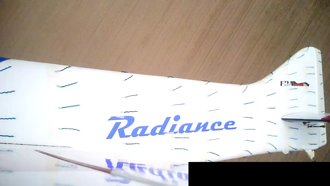

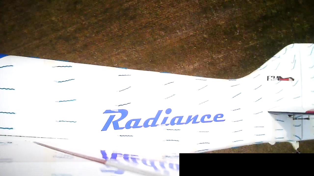

#28
I don't think the goal is to prove whether spiral propeller slipstream exists or not, but to see what can be done to improve the knife edge behavior and rudder response. Obviously the contra drive offers many advantages, not only removing the need for right thrust.
I am curious though about what causes the need for so much right thrust in our models.
In extreme cases, like full rudder deflection at low speeds, the airflow around the vertical tail separates completely. Rudder still works, but the braking effect from the extra drag is quite visible:
To improve the airflow around the vertical tail, i plan to add 1-2 fin fences, then i will experiment with 15-20mm tall fuselages fences or strakes, which should stop the air leaking from the high pressure side to the low pressure side around the belly pan and turtle deck. It will look a little strange, but probably so did the canalisers when they were first introduced

#31
My Feedback: (121)
Fascinating discussion!
Alex, are we to assume that there is no disturbance in the airflow on the bottom of the fuselage/rudder? It might be interesting to check there as well. I will be very interested to see the results of the fin and fuselage fences, perhaps you could test them seperately. The placement of the fuselage fences is interesting; they seem to have a very significant positive incidence, do you anticipate trim changes?
The right thrust question seems to have many variables. About 20 years ago I did some extensive empirical testing with a Hanno powered Runaround and discovered that the amount of right thrust needed (for that airplane) varied with the prop (12x11 vs 13x9) and violence of direction change (eg. pull up into a vertical line): less right thrust required for the 13x9 and smoother direction change. Of course, airspeed is probably the real culprit in this case, but the Runaround also has the wing placement very low on the fuselage (far from the C/L). More food for thought...
Lastly, the oil dispersion pattern on the bottom of my venerable MK Topstar powered by a piped, inverted OS 140RX is completely symmetrical. The prop is an APC 18.1x10.

#37
Joined: Apr 2010
Posts: 169
From: Richmond, CA
Yo Ho this is a great experiment, thank you! PLEASE post links to clips of the raw video somewhere, too, as would love to see it in live action.
For all you SSS doubters, I am a spiral slipstream faithful - I admit. But mainly from the photographic evidence I've seen, some of which I share here. I always loved this picture (giant scale Cap 232):
I am quite confident the prop itself never touched the water as if it had the wheels would have been so deep as not to bounce off the water. Therefore, the spiral is due to the spiraling of the airflow.
Another point: if you're looking at tufts such as these pictured to determine whether spiral slipstream affects the airframe, I don't believe you're looking at the right thing. The thrust vector that spiral slipstream creates which makes an aircraft change its path is not one that tufts would show since such a vector is perpendicular to the flight path on the horizontal plane (level flight); it pushes sideways against the rudder and fuselage, not so much up and down. The tufts only show airflow being deflected up and down. Last point - near the fuselage, spiral slipstream is the weakest. It's much more powerful at prop-tip distance from the centerline.
If you would like to use tufts to check for spiral slipstream, put a small wire mast on the turtledeck between the rudder and the canopy - the tip of which is about as high as the rudder - and attach a tuft to the tip. Attach your keychain camera to the top of the rudder. Check for lateral displacement of the tuft in powered uplines vs. neutral power downlines.
Roasting popcorn waiting for the videos!
