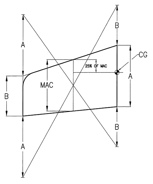

It doesn't matter what you put in for the stab, the MAC is for the wing and doesn't change. The one linked by OhD looks pretty good. I clicked the 'back' button on the bottom of the page and found the reasoning behind the tool. It makes sense and is inline with the article I linked above:
Basically the 25% MAC is about where the "Aerodynamic Center" of the wing is - a position on the wing in which the CG will generate no pitch forces (moments) regardless of the attitude of the wing.
This goes with the thought that changes in CG should not have an impact on elevator trim. If you change your CG and it affects your elevator trim, you are outside of the 'zone' - either too far forward or too far back. This also goes with the idea that the stab should not be generating lift for the airplane. The wing flies the plane, the stab guides the plane.
Hi Joe,
The tail stats,, and efficiency that one enters do change the CG result it produces.
However all I was saying is that most people refer to their cg as a % of MAC or an actual distance. That tool requires you to enter a static margin figure to work.
So using your own data you have to use 25% for the static margin (which is overly forward/stable) to get the 167mm result.
167 is 33% of MAC which isn't exactly a forward setting.
I'm not saying the tool is wrong, it just looks from a perspective not normally referred to. It could add to the confusion that all this jargon sometimes causes.

The CG that the tool gives does change, but MAC does not. I don't know where all the numbers come from so I'm not using anything from those tools except MAC right now, and I still have to look at things to make sure I trust what it says and where it's measuring from.
The description pages say the 5-15% static margin should end up around where the MAC is. The static margin is not a location back from the LE, it's a distance forward from another calculated point, behind the MAC.
Note that the MAC is given at the center of the fuse, and the root chord length it is asking for is measured there also. My measurement was at the side of the fuse so I have to redo it.
But I think we are on the same page
Last edited by Jetdesign; 06-01-2014 at 02:01 PM. Reason: Didn't sound friendly enough :)

Hi Joe / Jim,
I prefer to calculate CG just as a % of Wing MAC.
That tool is considering tail area and efficiency !??? - really an assumption.
Normally when people refer to say 25% or 30% etc , they are referring to a straight % calculation of wing MAC.

Yes , was just trying to stay away from stuff that clouds the issue.
On re-reading some of the posts I think that maybe MAC is being confused with AC !!??
As a matter of interest what % of MAC did you end up with and then using that tool what static margin needs to be specified so as to derive that ?

Hi Jim,
Brian

It may be the assumption in the tool re the tail.
Changing from std to low changes the outcome significantly, though I have to say I've not looked at the math it's doing.
The math in the Palos club tool is fine - and straight forward.
Brian
