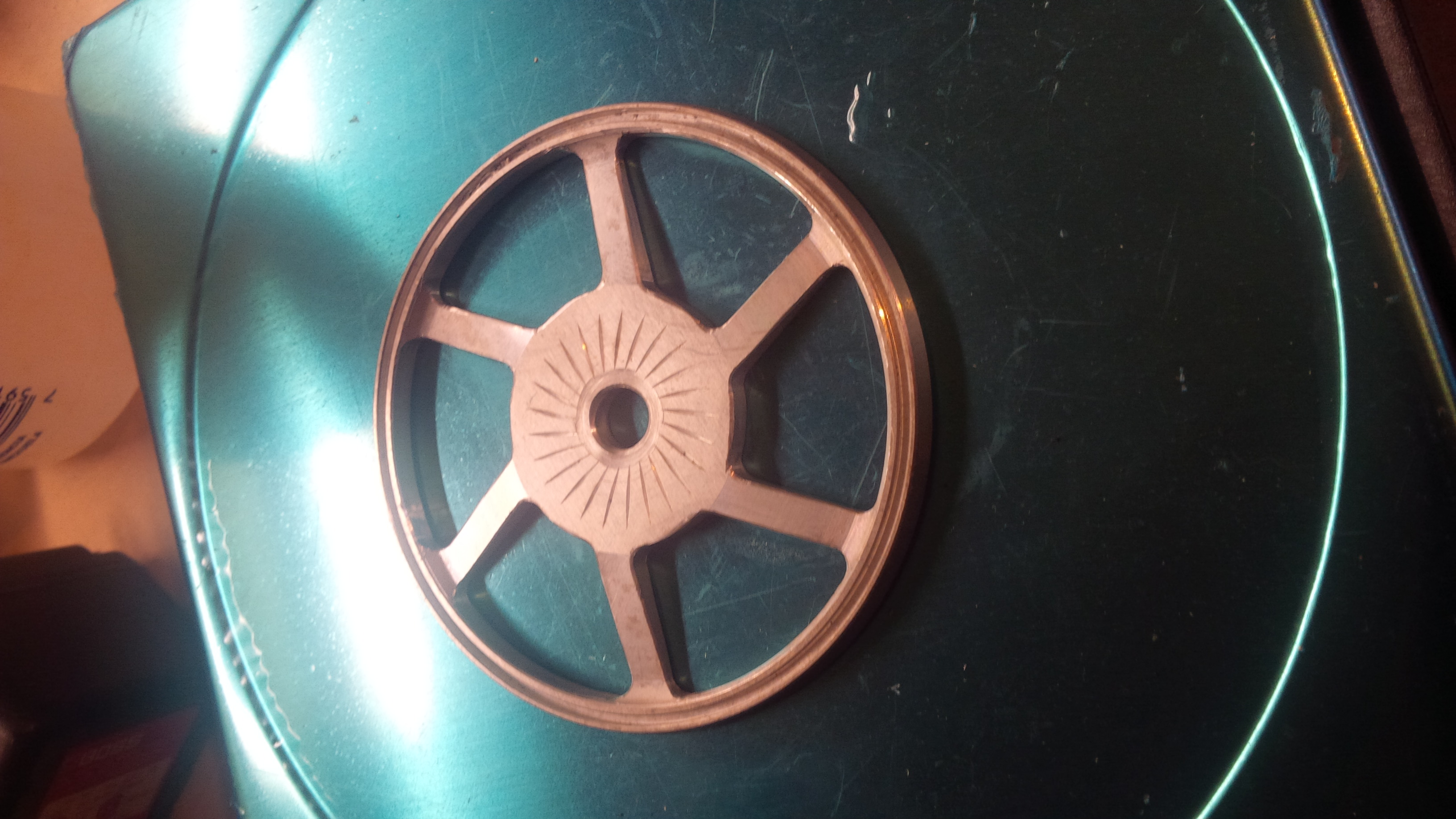

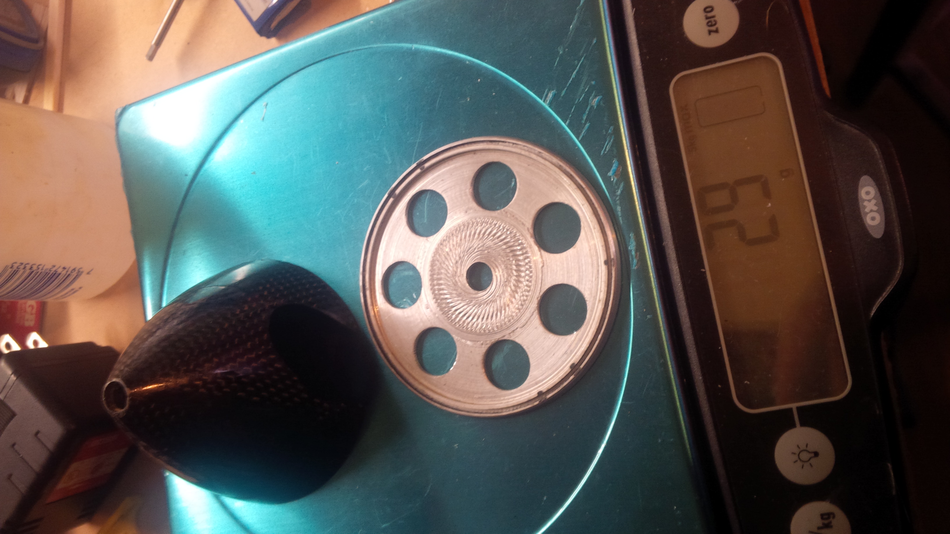

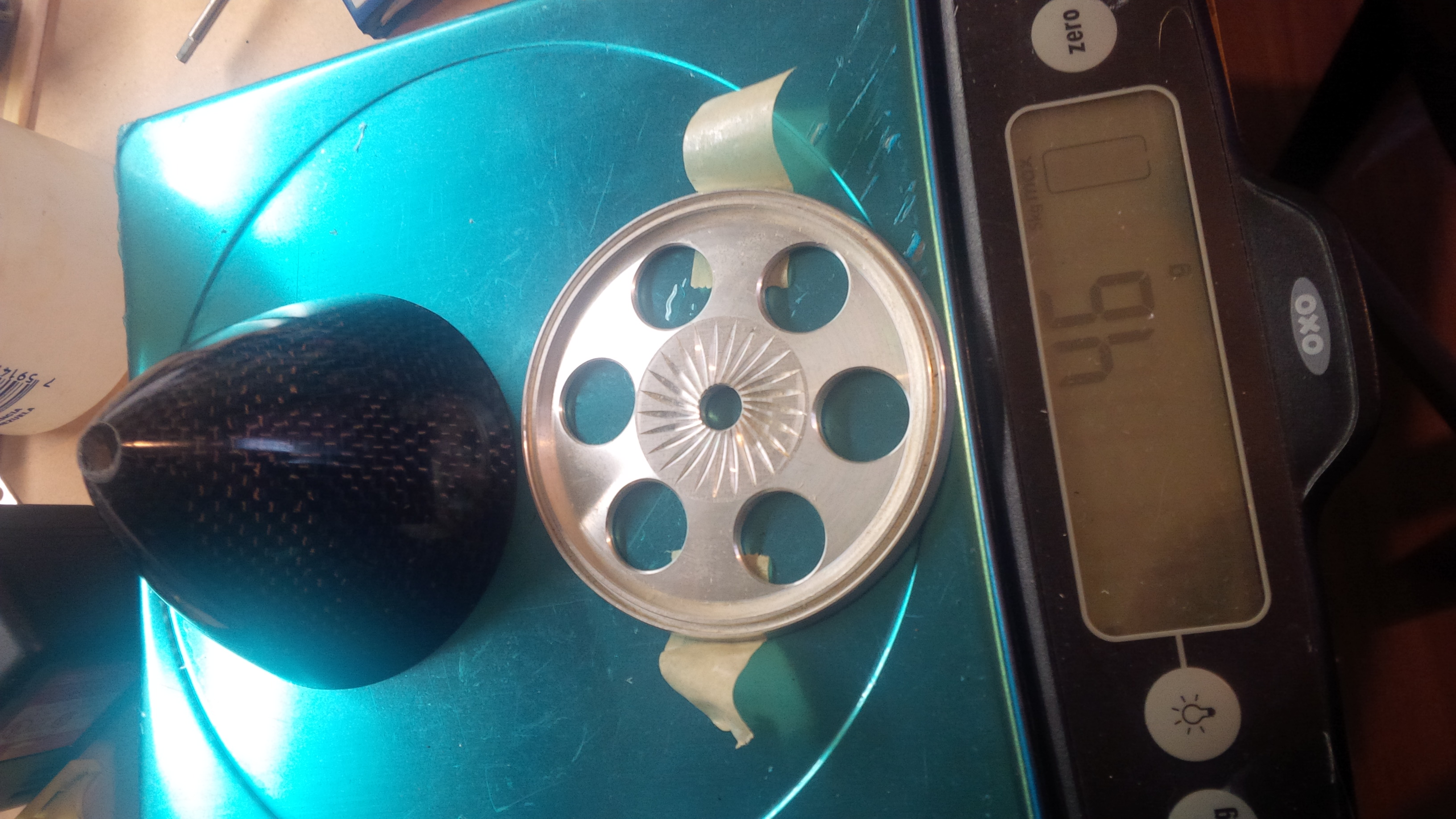

Ryan,
Of course I am using a starter, there's no other way as theses engines are very dangerous if not done that way.
Please note I use this spinners with the Kavan starter on 4SLiPo 2200mAh with the silicon insert, which is softer and has tremendous grip than the stock one, I just apply normal pressure to the spinner, never run the starter and hit the spinner ( I hate when I see that), usually my engines start instantly, but if someone needs to run the engine with the starter it can be done.
I did just check Camodel's page, and as you mentioned they do not show the old type backplate, but I can tell you the new one seems strong enough, I guess you could ask if they still have the old type.
Please note I have only ran the reworked one which is the lightest shown, I ran it for 4 year before I retired it, during that time I cracked the cone due to wear on the bolt hole, never failed , but changed anyway, that was on the third year I think.
This is the stock one Backplate thickness is 2.5mm at the thinnest point (outboard) and 4.37mm at the Hub. Tappered from 4.37mm to 2.5mm.
This is the reworked one I used in the Osmose Evo then the Axiome both YS170 CDI ( I mentioned it was about 32gr, that was including the Tru turn bolt, and using the Tru Turn prop adapter) 1.66mm but the hub which is 2.3mm
This is the latest one I got, which is strong enough 2.57mm at the thinnest point 4mm at the hub, tappered from 4mm to 2.57
I hope this is useful, and please anyone needing more info just let me know.

Ryan,
Please note the thickness of the backplates.

Hi,
So to be clear. This spinner is the electric spinner you are using Alejandro?

Hello Scott,
No, that used to be the one for everything, it's the first version, then they changed for the electric turbo backplate, but the one I show (turbo) is one of the newest and it is strong enough for the YS , if you have experience with the YS and the correct starting procedure which I am sure you and Ryan are, it should be ok. On the other hand I cannot recommend this setup to people who does not have a lot of experience.
BTW, the bolt has to be filled down to a conical shape to fit the spinner. I can also recommend you to check the YS prop nut form Hobby Net is 10grs!

Hi Alejandro,
The spinners on the Camodel website have cut outs in the cone, which I presume is for coming on the electrics. It looks like the spinner In your pictures does not have these cut outs.
Is there a option for no cut outs?
Also what is the diameter?

Hi Scott,
I will ask Marcelo, he probably have some, anyway the option used to be the holes.
The Diameter is 81mm
