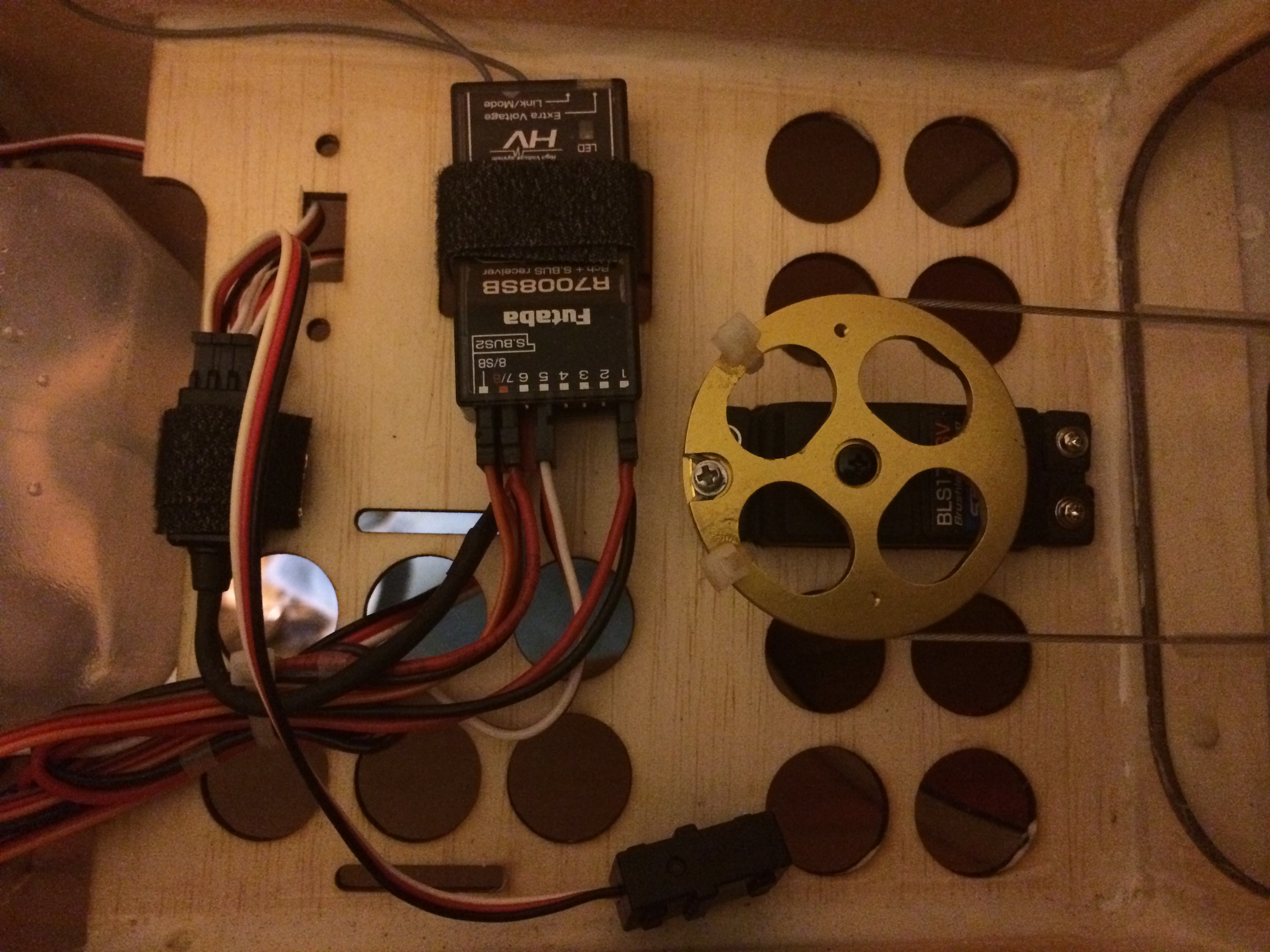

Has anyone rigged a biplane with S-Bus aileron servos? If so, how did you set it up? Do you use four channels to set sub trims and throws in the transmitter or program the servos or both? Is there a better way?

I do have that setup in my Acuracy Bipe,
Wing Type set to 4 Ail 2 Flap
Stab 2 stab
I programmed all the servos to respond to its Function channel, it does not matter if you program a servo to a channel, if connected to a regular channel it will work as a regular servo, as on every start up the servo identifies the signal it receives and selects itself the method of operation.
ch1 Ail
ch2 Ail2
ch3 Ail 3
ch4 Ail 4
Ch5 Rudd Regular Ch
Ch6Elev
Ch7Elev2
Ch8 Ign Regular Ch
Ch9 Thr
I have each wing with both ser with one connector (soldered instead of Y), Then a Y to connect both wings
It works really well, so I cannot tell any difference as with a regular setup, but saved weight in extra leads not being needed.
Regards
Alejandro

I went the four channel way just in case as it is my first byplane with SBus, and as I soldered both servo wings together I wanted to make sure I could make changes without reprogramming the servos, but as Derek is planning, I programmed each servo individually as the Acuracy uses max servo throw on the ailerons, but I programmed each servo(all), for example on the rudder I set the max throw on the servo, and as the servo keeps the programming it does not matter if it is in a regular channel, so I cannot exceed the throw no matter what I do with the transmitter programming.
On the four wing setup all trims and mixes are authomatically programmed.
