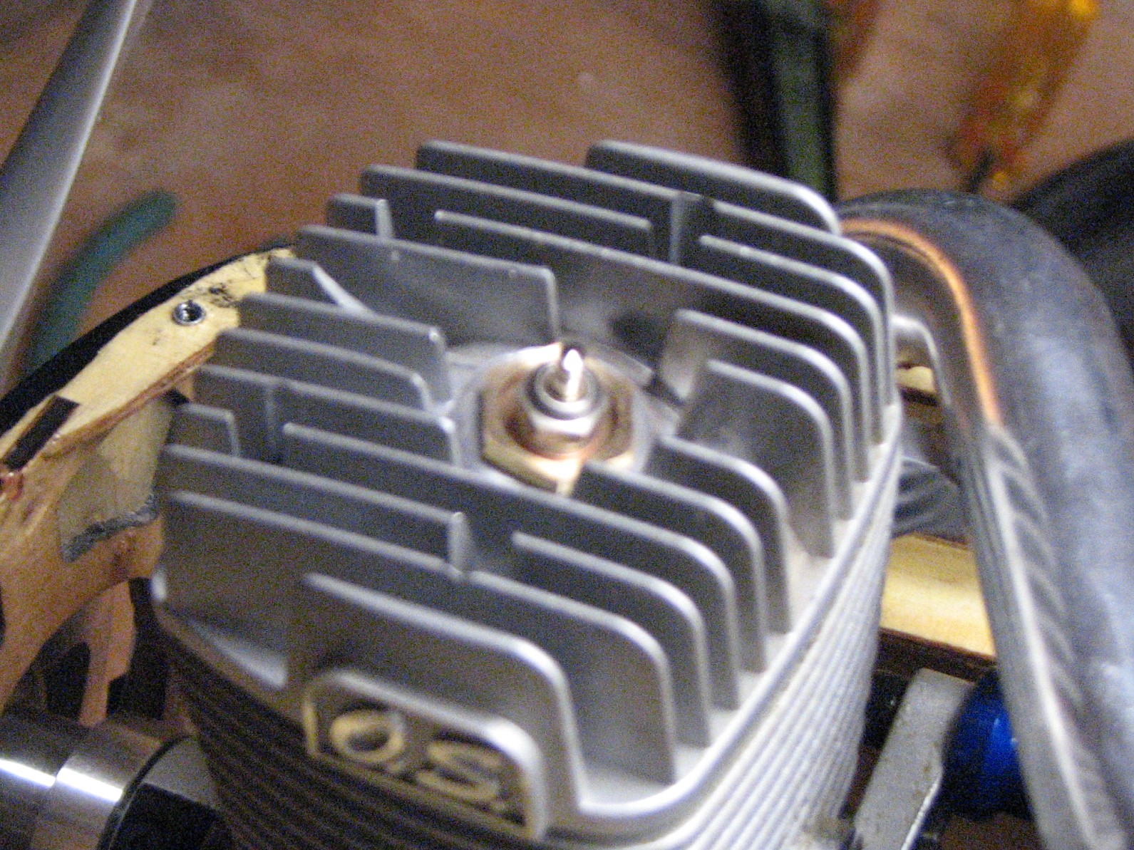

Old 03-15-2015 | 01:31 AM
  #30
rm's Avatar
rm
My Feedback: (27)
Posts: 556
From: ohio
Have been playing with the new os plug. Have just ran on the ground so far, but numbers look just as good as the ignition. Actually seems to run pretty well so far. May get a chance to get it in the air in the next couple days.
Old 03-15-2015 | 08:17 PM
  #31
drac1's Avatar
Joined: Jul 2008
Posts: 1,750
Received 10 Likes on 9 Posts
From: Romaine, Tasmania, AUSTRALIA
It will be interesting to see if the fuel consumption is the same between glow and ignition.
