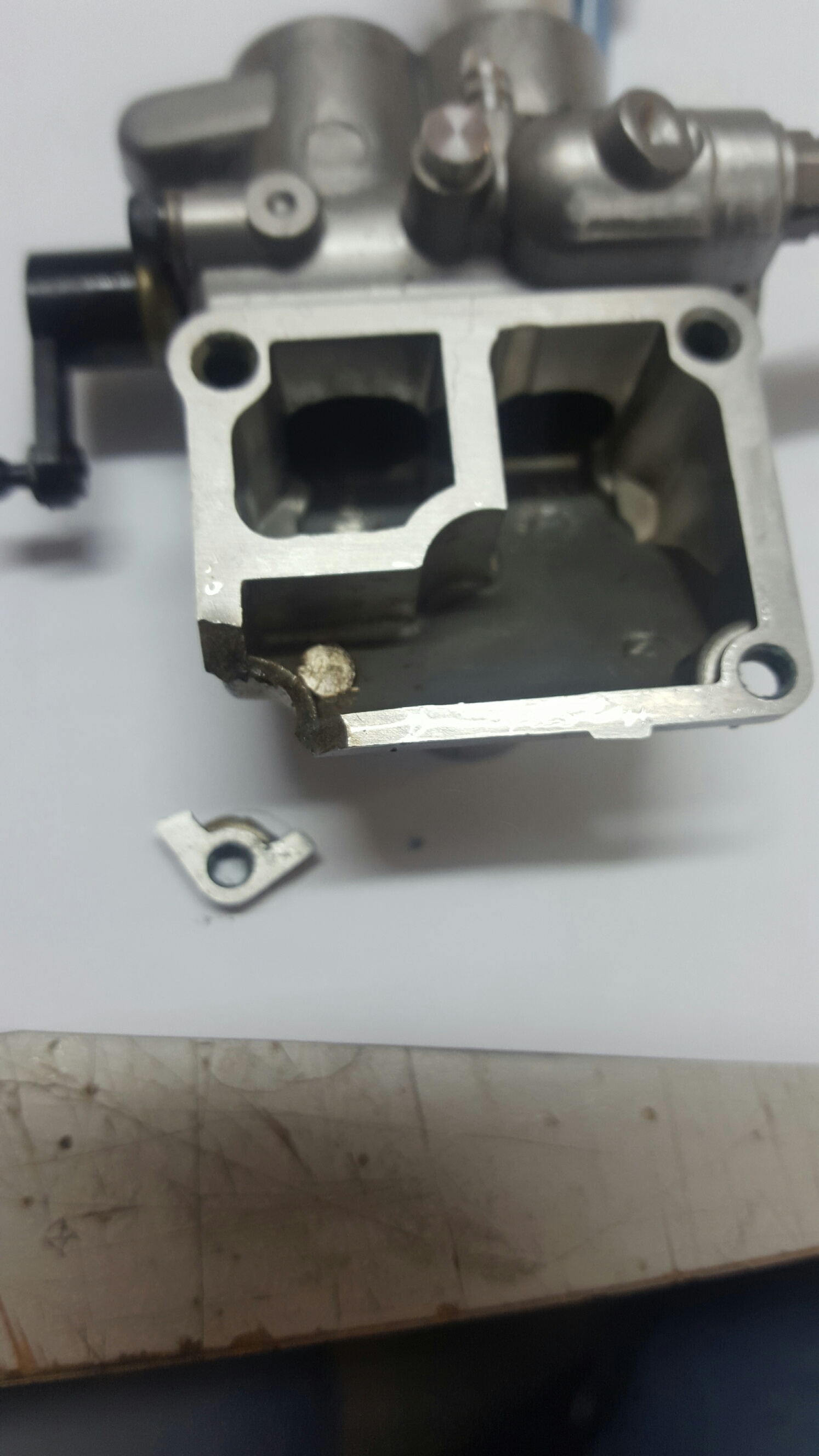

Old 08-30-2015 | 04:17 AM
drac1's Avatar
Joined: Jul 2008
Posts: 1,750
Received 10 Likes on 9 Posts
From: Romaine, Tasmania, AUSTRALIA
Cool
Found the problem with my engine

Hi Scott,
Yes I've seen that problem before; shame there's no way to fix the casting.
I've bench run the 185 for nearly a complete tank and had no sign of the issue repeating. Power is good (7100 rpm on 21 x 10.5 APC) and idle very consistent. However I have yet to re-run it in the air and after sustaining damage to my Axiome + wing, will be unlikely to run it for quite some time. I'll let you know if & when I do

Old 09-01-2015 | 12:05 AM
Joined: Jan 2009
Posts: 342
From: NEWCASTLE, AUSTRALIA
Drac,
Have you tried this Rapid Fix glue it works on casting and you can get it from REPCO.in Australia,
regards

Old 09-01-2015 | 03:40 AM
drac1's Avatar
Joined: Jul 2008
Posts: 1,750
Originally Posted by MAVROS
Drac,
regards
Thanks for the advice.
Never tried it. It may or may not work, but in this situation I doubt it and I am not interested in stuffing around trying it. 60 bucks for a new housing - done deal.
I have always done my own maintenance/repairs, but a mate gets a good deal with Naruke, so it's on it's way there for a rebuild. It will be interesting to see if there is any difference in performance.
