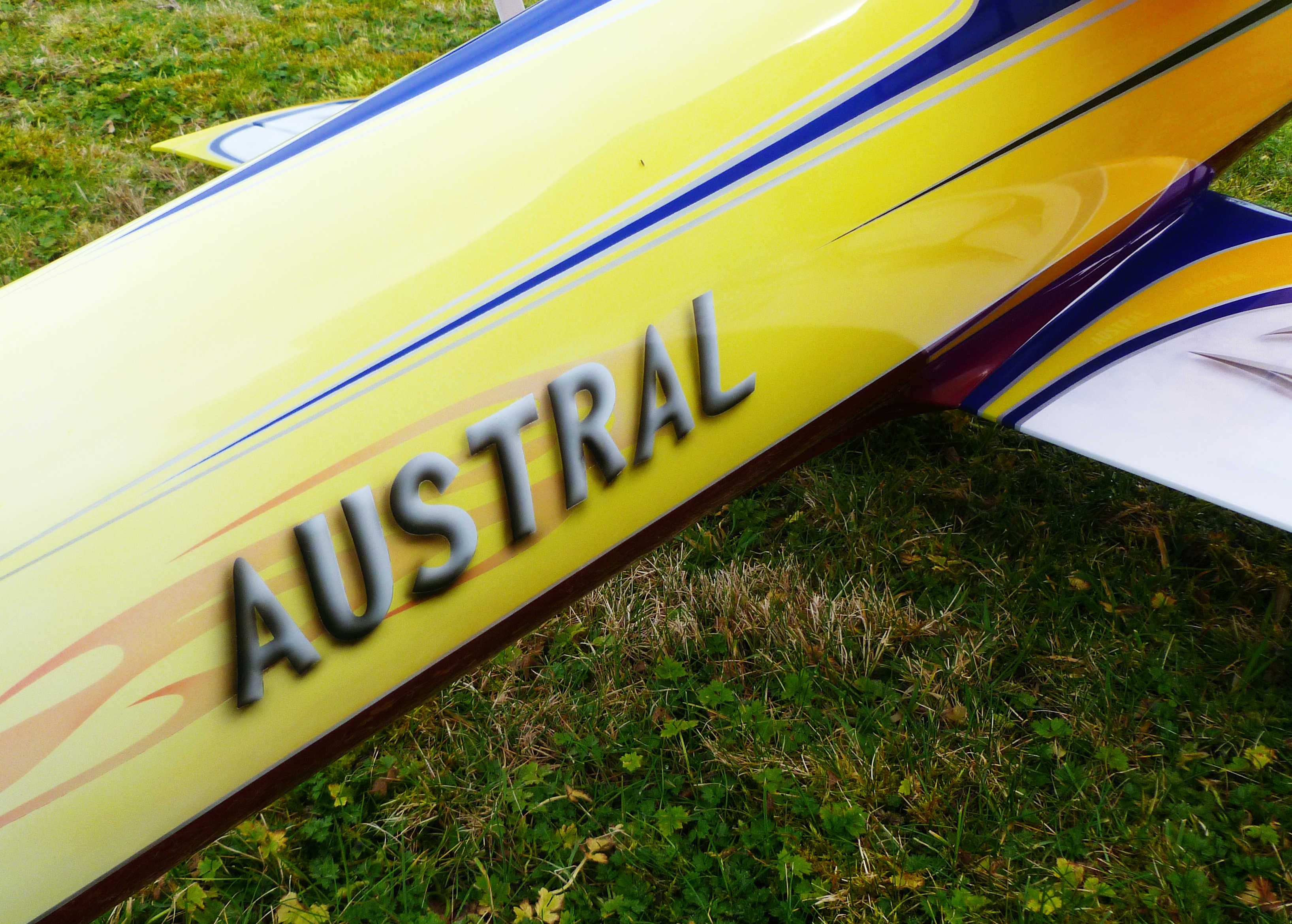

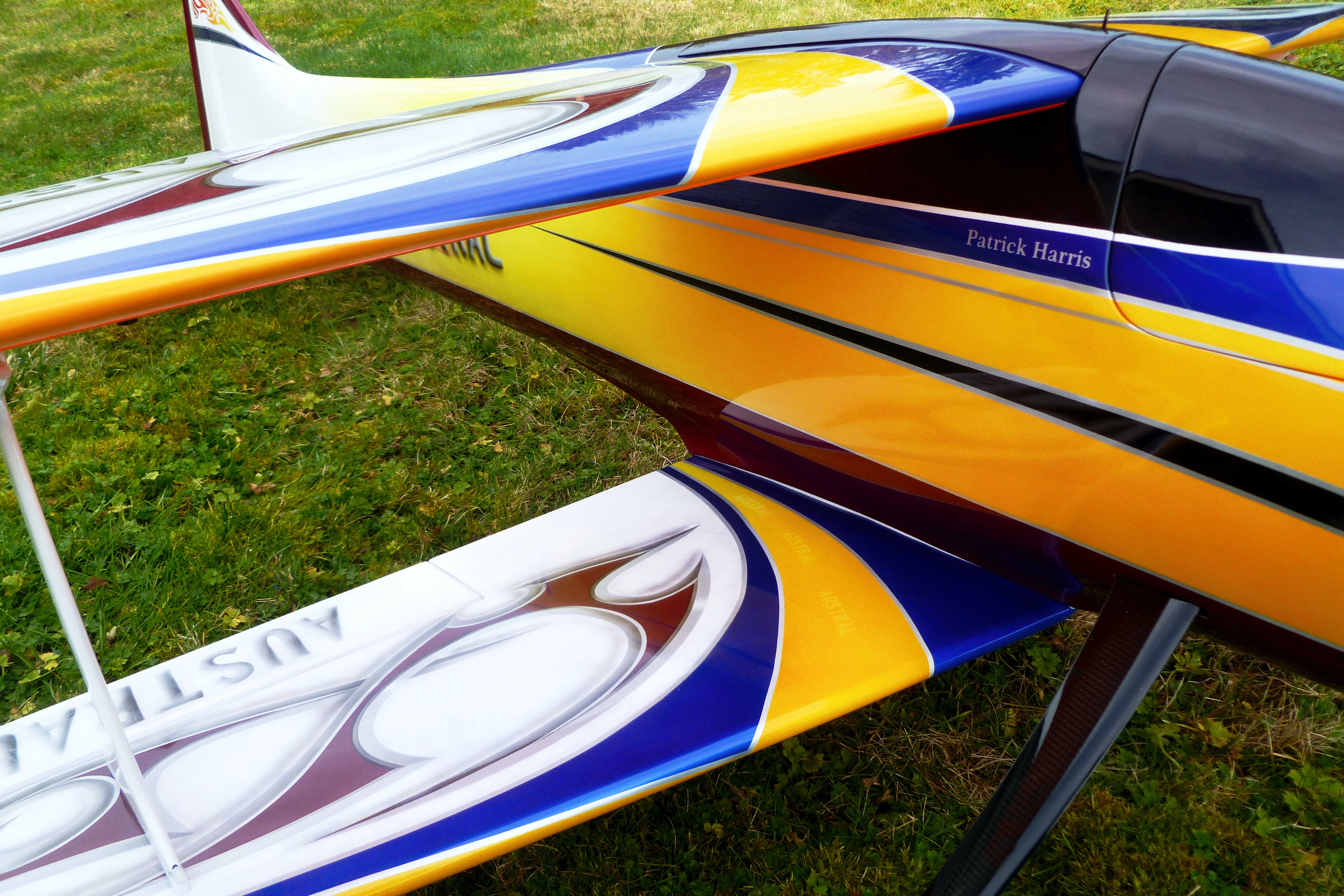

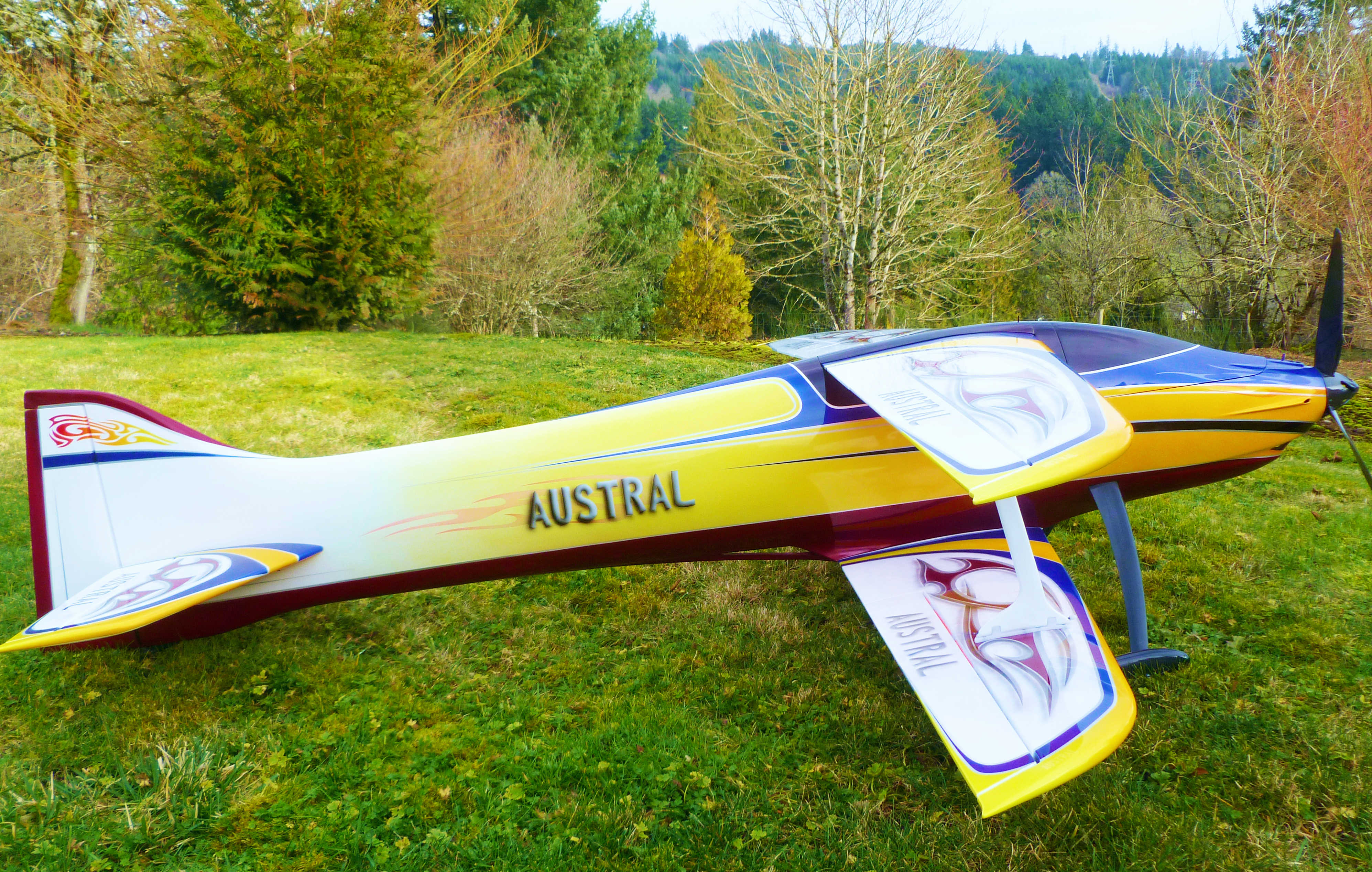

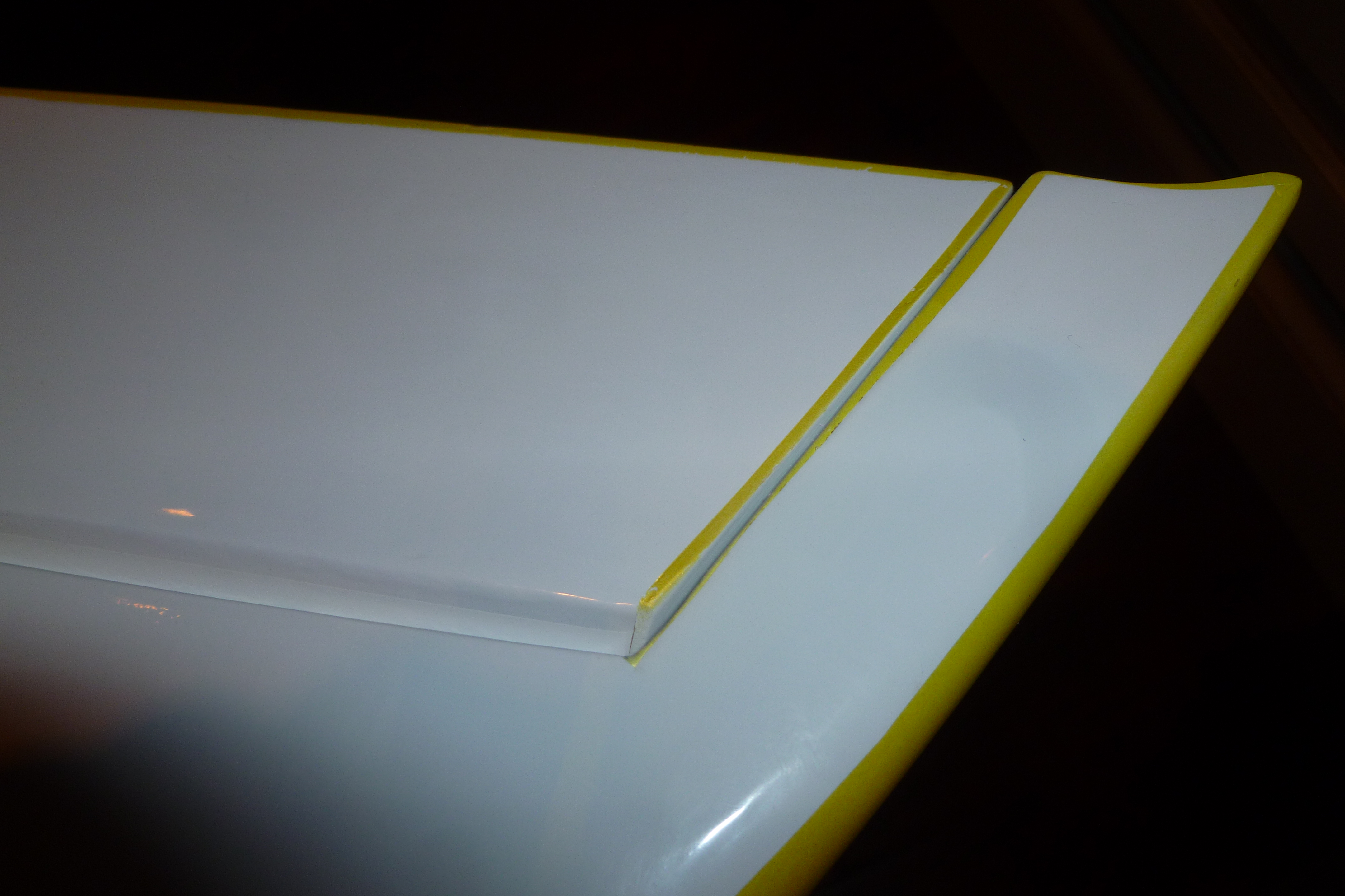

I just shot a few pictures of the finished fuselage to try and give you guys an idea of the level of gloss I was able to achieve with the new System 51 rubbing compounds. Let me tell you the stuff is incredible. The pictures don't do it justice. I have only been able to achieve this level of gloss and depth one other time and it took days of work. This stuff is effortless and I mean minutes versus hours of work. If you have been intimidated by doing a cut and buff finish or had problems, this is your answer....System 51.
Like I said, the pictures are not even close to what it really looks like. I think when I get it all together and in the sun (if we ever see it again), it will show off the gloss and depth a lot better.

That looks slicker than greased snot on a door knob
You do realize you made a huge mistake though. With that slippery paint job, you down lines will be far to fast. You may need to take some 80 grit and roughen the surface a bit for more drag
