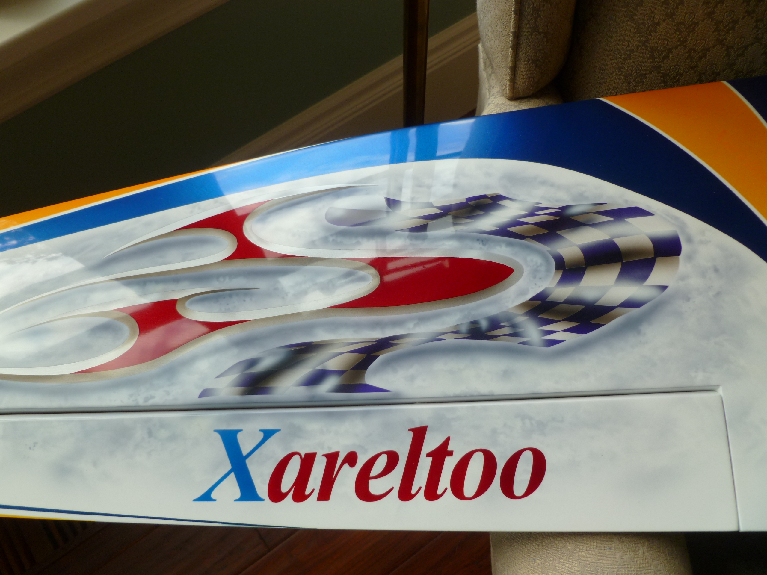

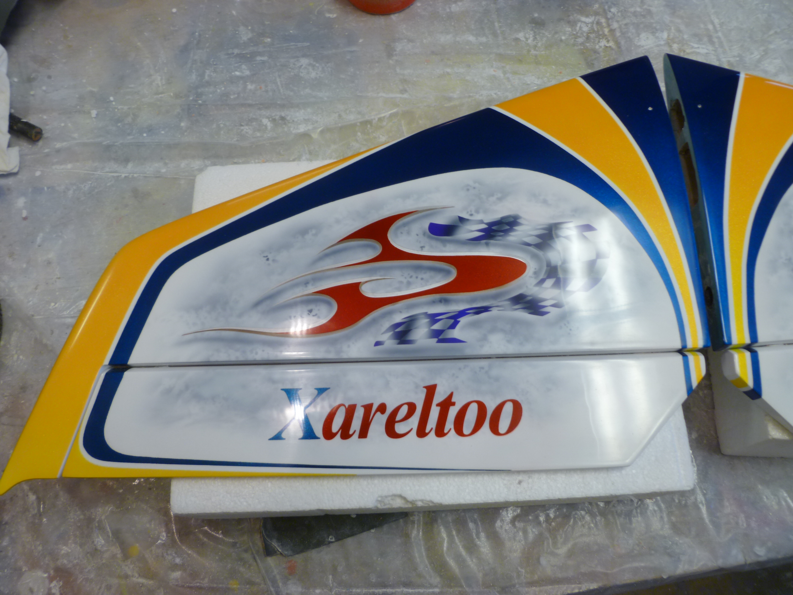

This shows the incredible versatility of vector files. I used the same image as a ghost graphic on a prior build.
On the Xareltoo, I just used Corel Draw to add a line around the flame for a single beveled edge. I painted the checkered flag in purple. You just use white to show highlights and black to depict shadows on the flag. Really easy to paint, but very impressive.

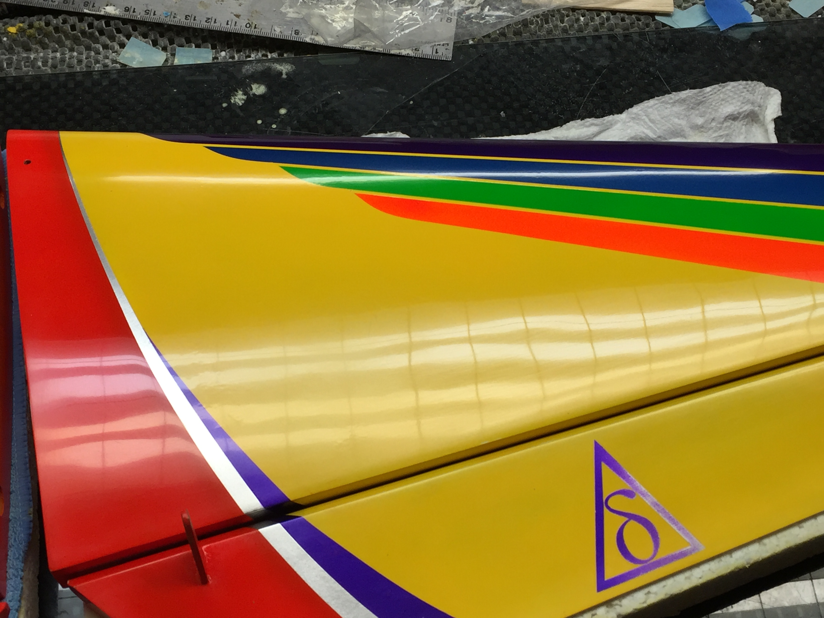

I spent several hours today, Monday, cutting the stab's surfaces. Fresh 600 grit on the second stab worked much better, easier than the first which was done initially with 400. I suppose 400 is okay, just took longer than necessary to remove the scrajtches.
Im going to try to upload a snap through my phone

Try again the right panel was cut and polished. About as good as I can do by hand. The small buffer Pat uses will come in handy.
Started cutting the left side

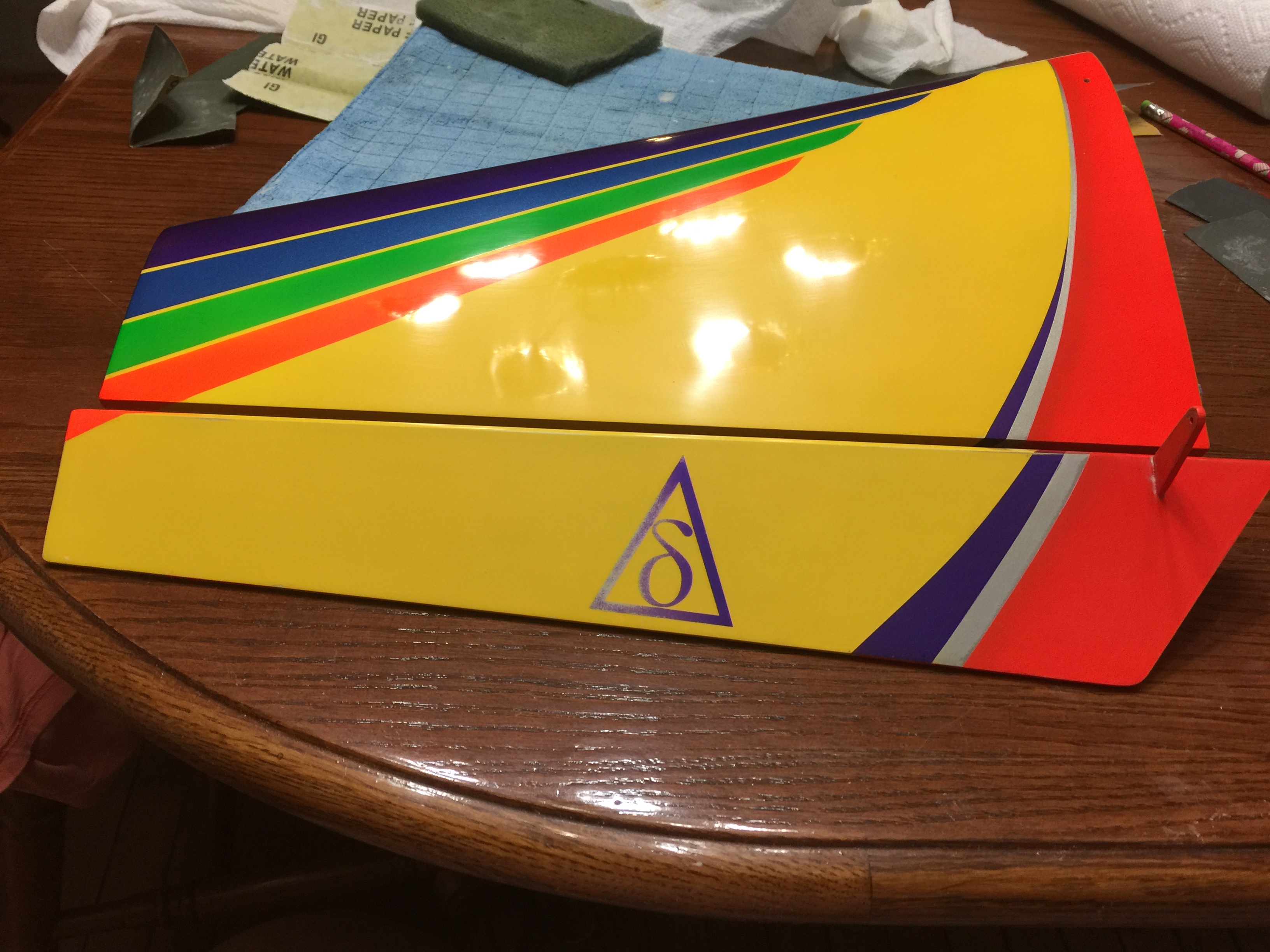

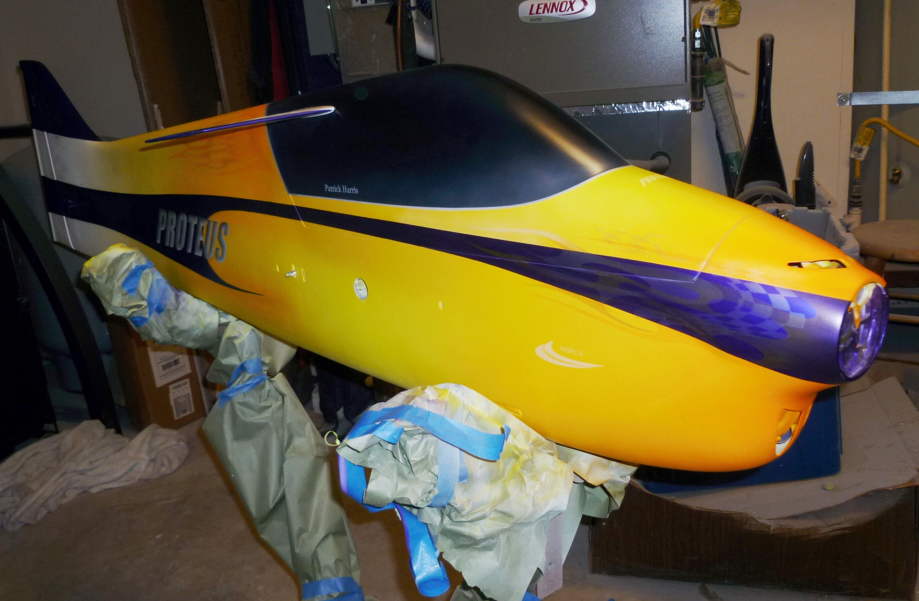

The little 3 inch Griot's buffer really saves a bunch of time. I cut and buffed both stabs this morning and still got in 7 flights of "P"!
Second wing cut and buffed. I got some bleeding on the ailerons, so I'll touch them up and re-clear them when I shoot the fuselage.

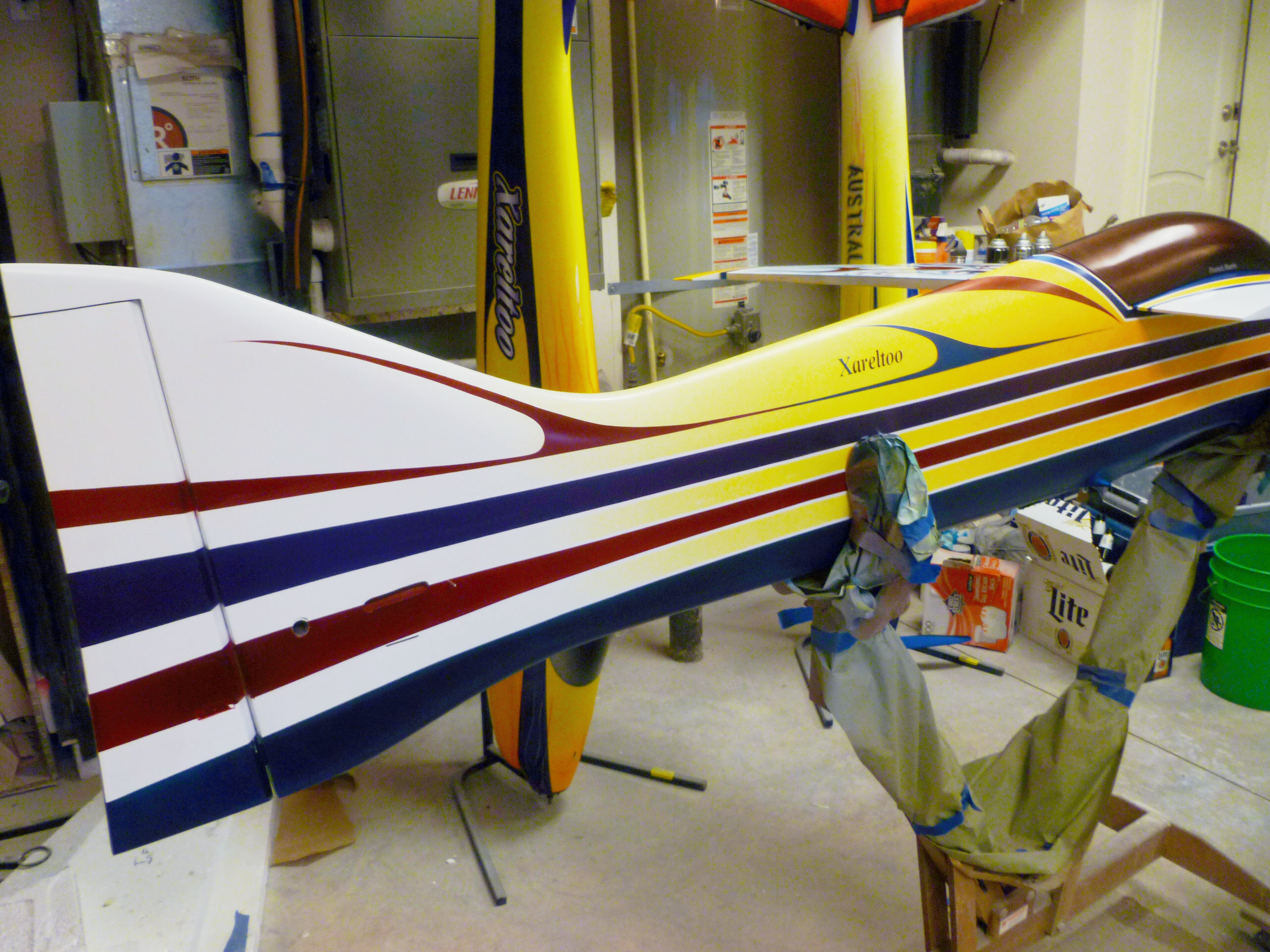

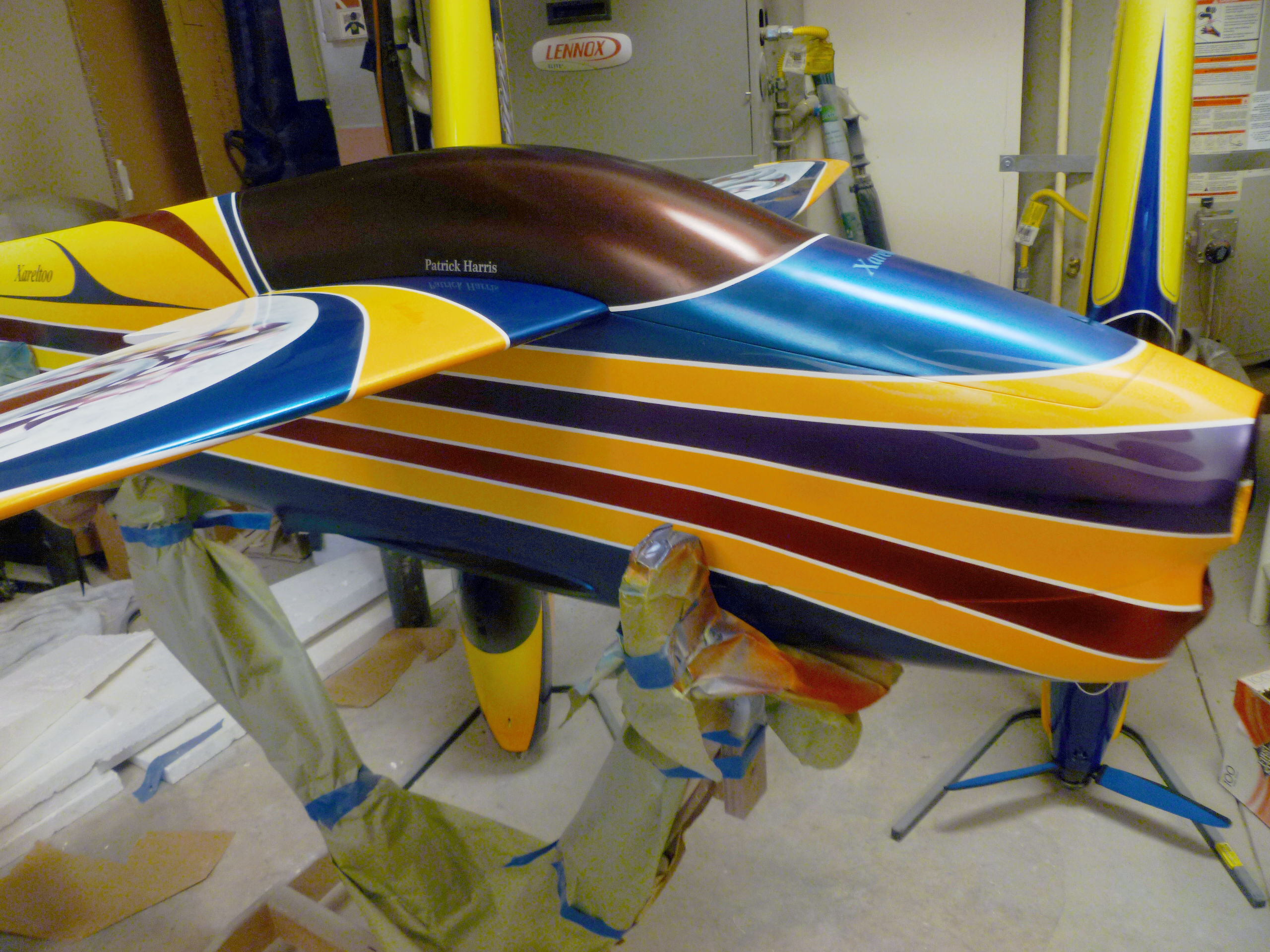

Fuselage ready for clear. A lot simpler scheme this time around, but every color is over shot with HOK candy with HOK Metajuls, The stuff looks nuts in the sun.

Here's the left stab cut and polished with elevator cut to 2000 grit only. It went much better on this half

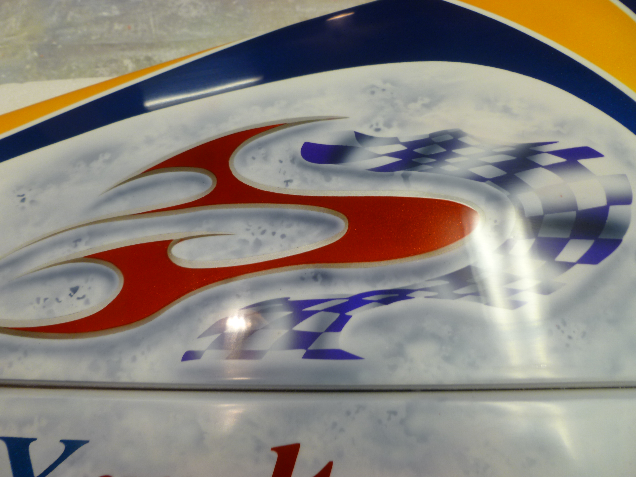

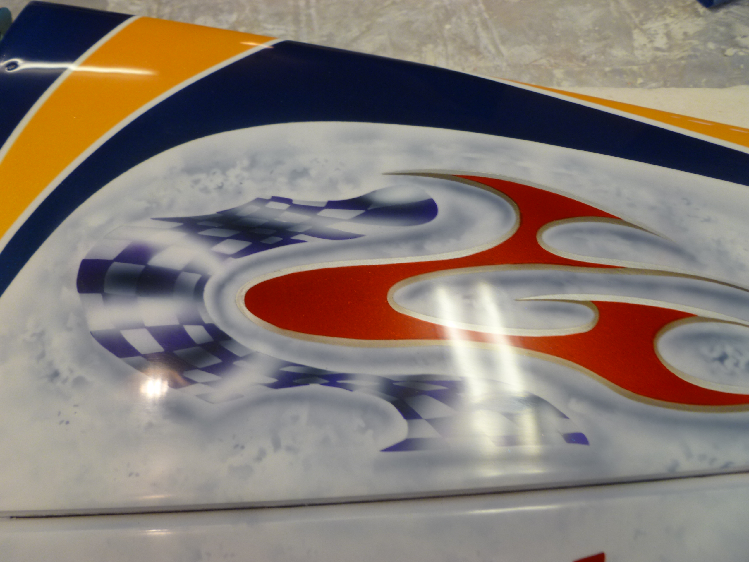

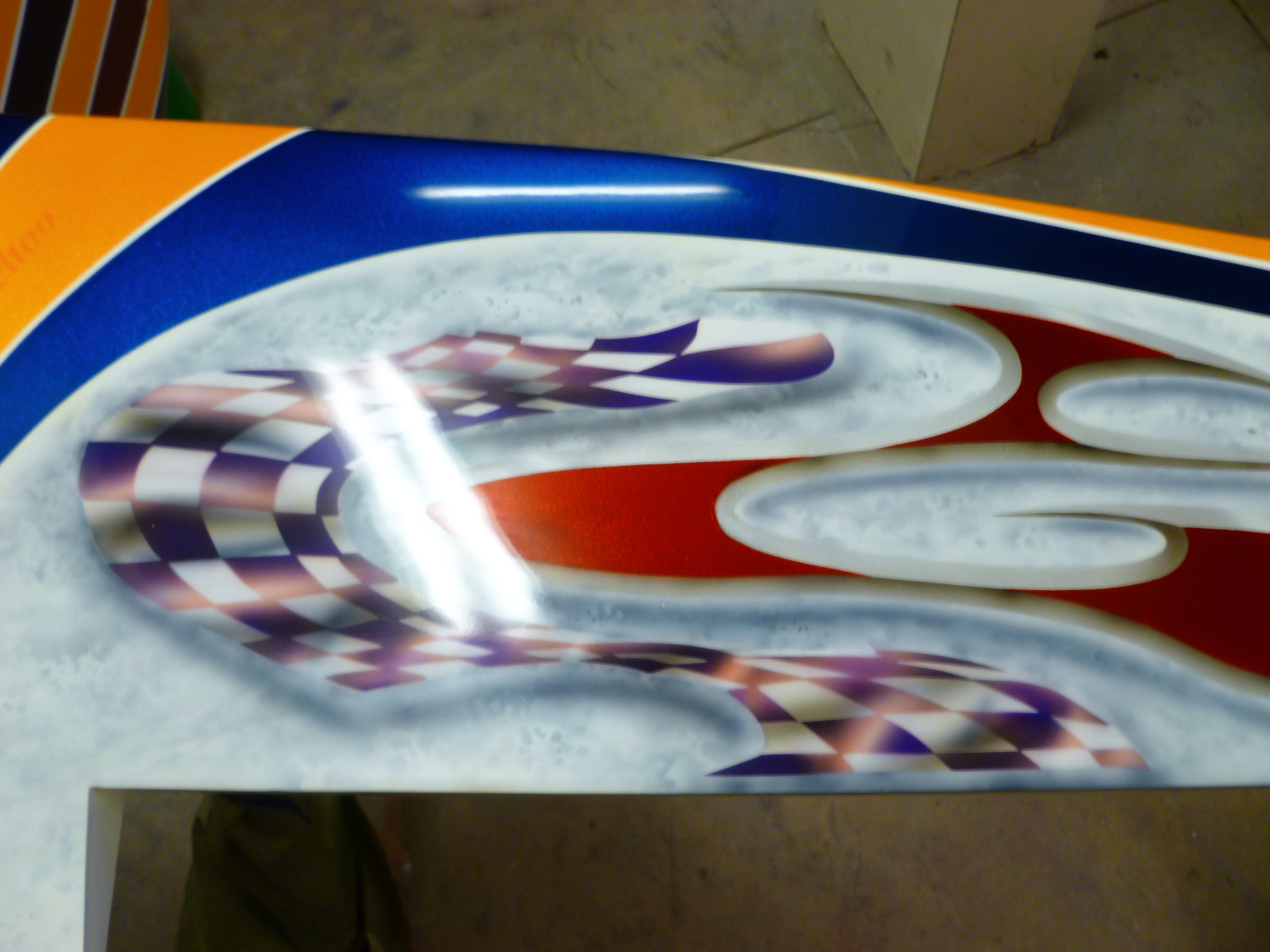

OK boys, I made a very minor mistake in painting the left stab versus the right. Trust me, it's ultra subtle, so you have to look really close. Here is the left stab with the error.
Here is the right stab that was painted correctly:
Anyone see it! Clue...it's in the red graphic.

The belly of the red is lighter or is faded to lighter towards the edge. It looks like metajules orange over the red? That colors probably shimmers in the sun.
why not just mask and shoot some of the metajules back over the red. It won't come out right?
if you were to shoot color over the clear, would it stick?

Nope, not it Matt. The red is fine, it's just glare you are seeing. It's actually red Metajuls mixed with red candy that is shot over the base red.
Yes, you can shoot HOK back over the clear with no problem...unfortunately I have had to do it a few times. Just re-shoot and clear again. It's best to sand the area with no higher than 600.
OK, another clue. It's not the red part itself, but is associated to the red. It's very subtle. Another clue. It's missing in the left stab, but is in the right one.
There has to be more than you and I reading this.....come on guys, what is it?
