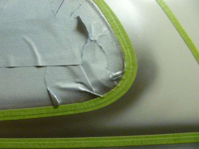

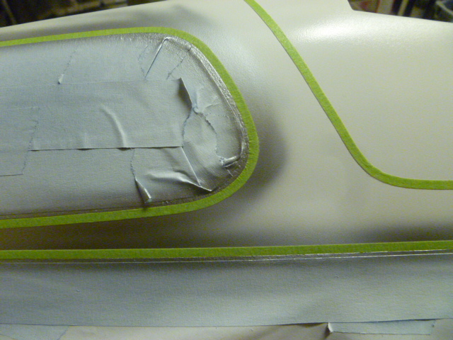

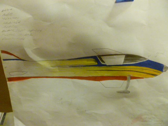

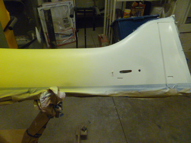

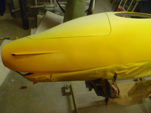

Alright I am now working on the fuselage.

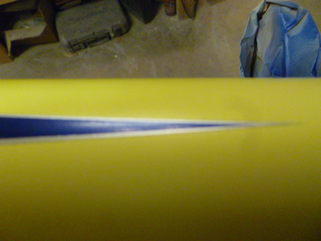

Here is a rough idea of what I am doing. Very sleek and clean lines. It looks simple, but has pinstripes on all color edges and multiple tapered pinstripes.
The pictures don't show it well, but the lower part is done with the front being orange/yellow, tapering to yellow to white. The red has been shot on the bottom which wraps around the rudder and fin. You can see I have hinged the rudder at this point. I find it easier to mask and paint it all as one unit.

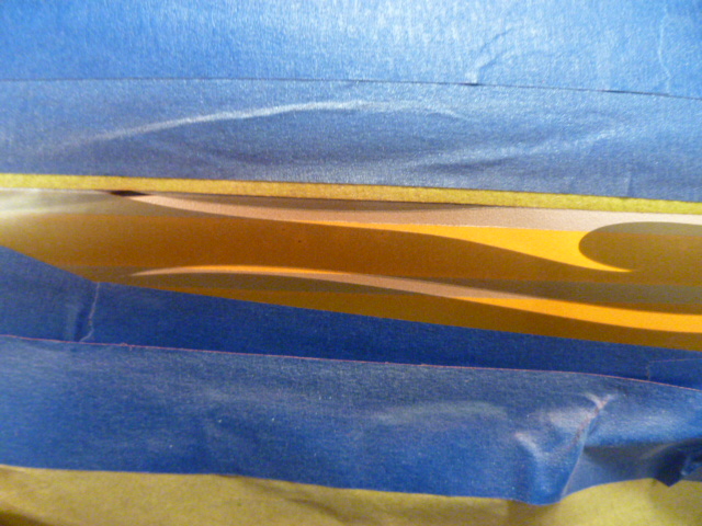

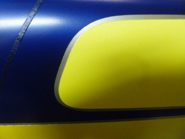

Here you can see I have painted the upper part white and just layed out a 1/8 inch tape over the white which will be pulled after the blue and canopy are painted. I really like the clean white line that separates the canopy. You can also see I have masked off the lower sections and shot sliver (Metalume) next to the mask line.
I now lay 1/8 inch tape over the sliver. This will create the pinstripe around the blue.
One thing that is very important is to mask back over the 1/8 inch tape to cover it and the 3/4 inch masking tape. This is called "bridging". If you don't do it, it's assured paint will leak between the masking. Here you can see it.

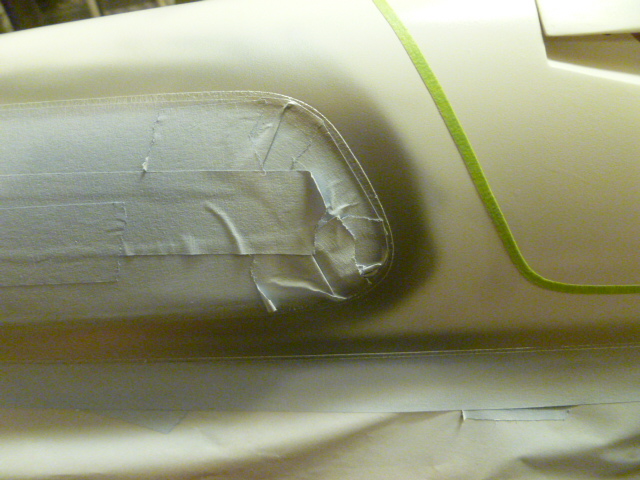

I put on one AUSTRAL masking film ahead of the canopy. I have done this two or three other times and it makes a very nice statement. This will become a ghost graphic.
The blue is shot. You can see I just shoot right over the masking film.
Now the film is pulled,
I now knock it back with blue.
Mask are pulled which reveals the 1/8 inch pinstripe.
The picture is bad, but you can see how you can get tapered ultra clean pinstripes (and very easy) with this method of masking. You can see how the pinstripe has been tapered. This was all done by overlapping more of the sliver.
This picture of the taper was shot right after it was unmasked and has not been cleaned, but you can see the taper of the pinstripe.

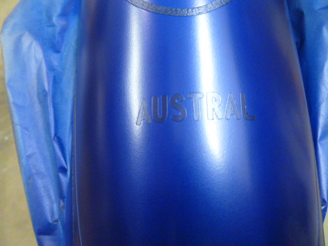

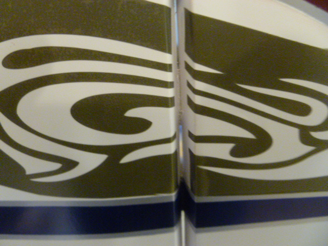

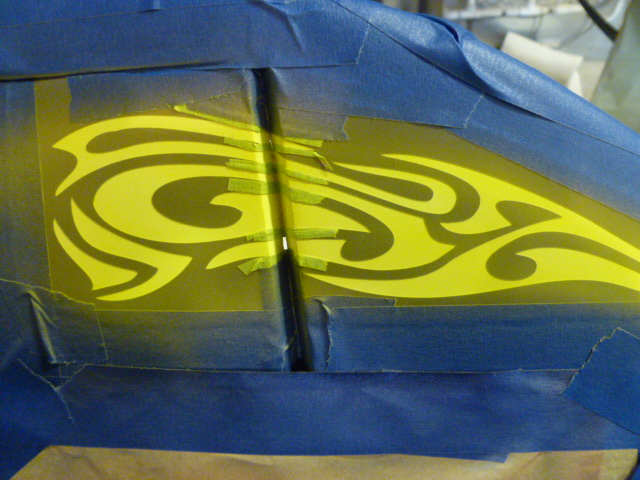

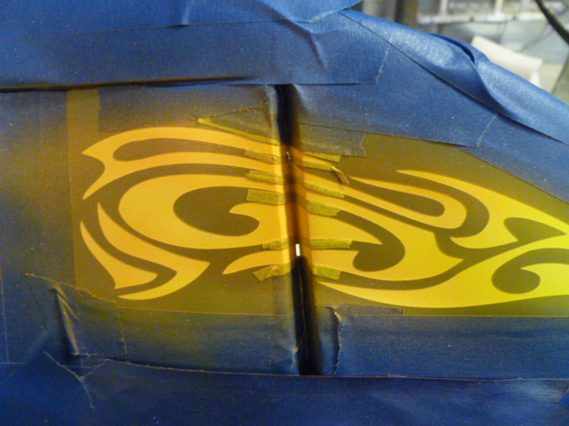

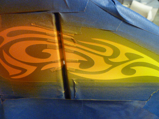

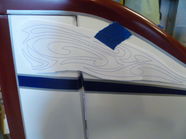

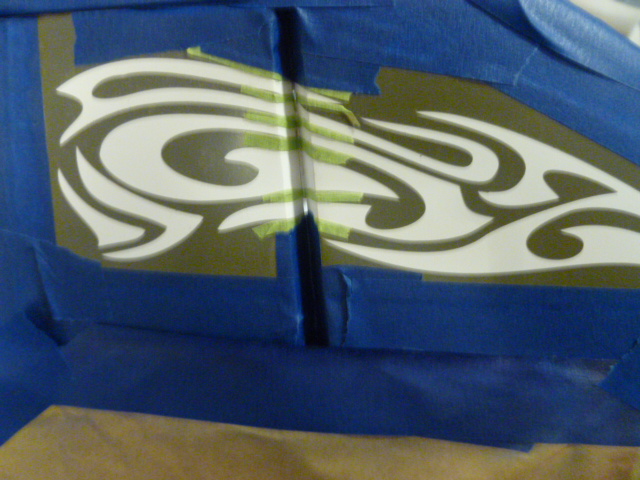

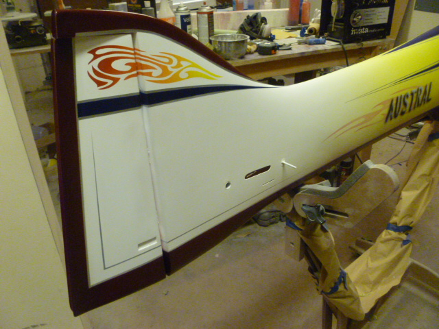

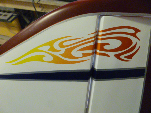

Vertical fin graphics
This is a graphic I found Goggling "Tribal Graphics". I did the conversion process described before to convert it to a vector file. I moved some stuff around to better fit the space on the fin.
As before, I print out a paper version to see if it will work.
Here's the masking film applied and cut at the rudder.
Rudder opening masked.
The whole graphic was shot with yellow pearl.
Orange pearl was shot on the back 2/3.
Red candy with HOK Metajules was shot on the back 1/3.
SG100 Intercoat clear was shot over the whole graphic. After unmasking.

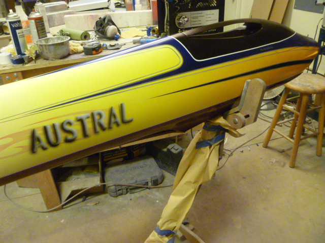

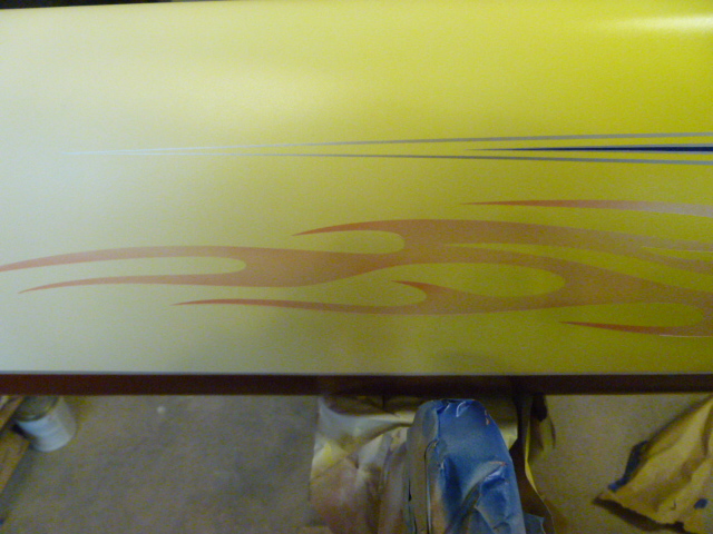

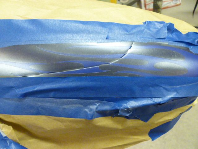

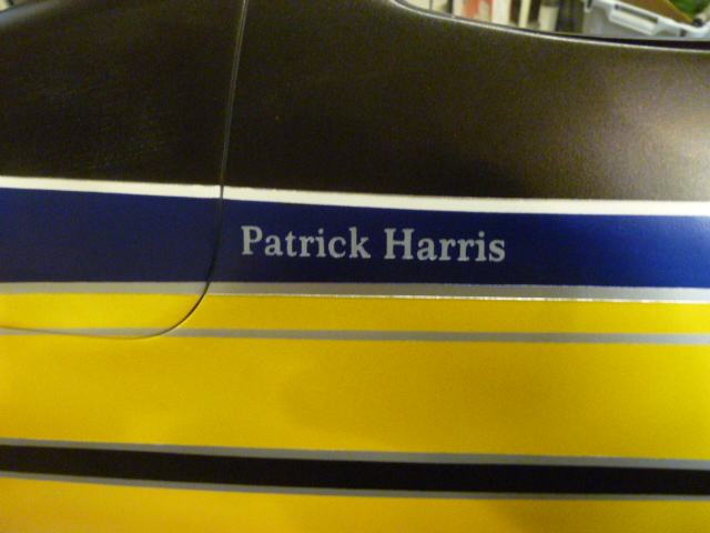

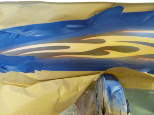

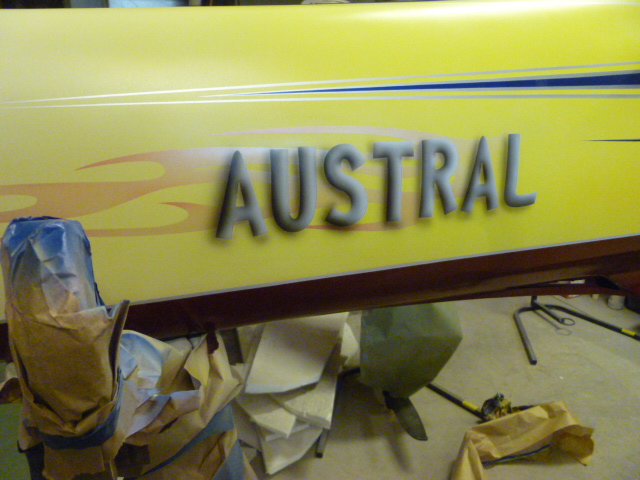

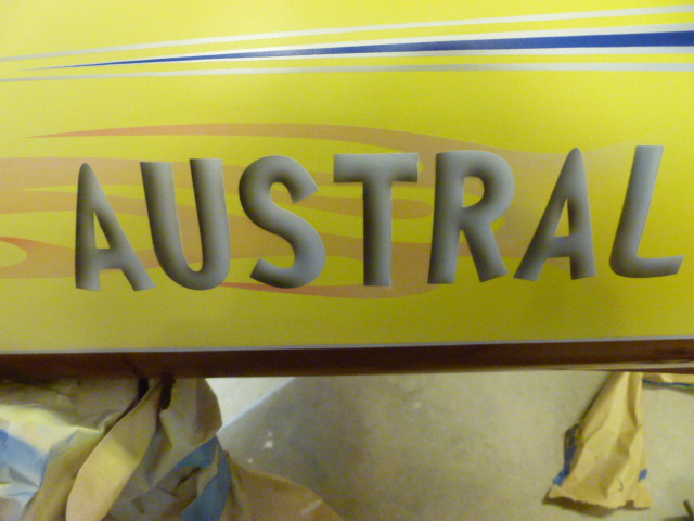

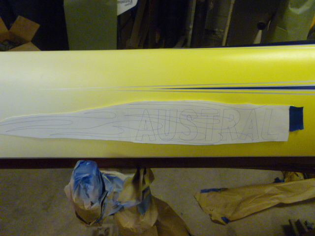

Next I did the name of the plane on the sides. There will be ghost flames under the name.
Same procedure with a paper printout for layout.
Here the ghost flame masking film was layed out and masked off.
The whole graphic was shot with silver pearl with red candy shot on the tips and dusted
over the whole set of flames.
Flames are unmasked.

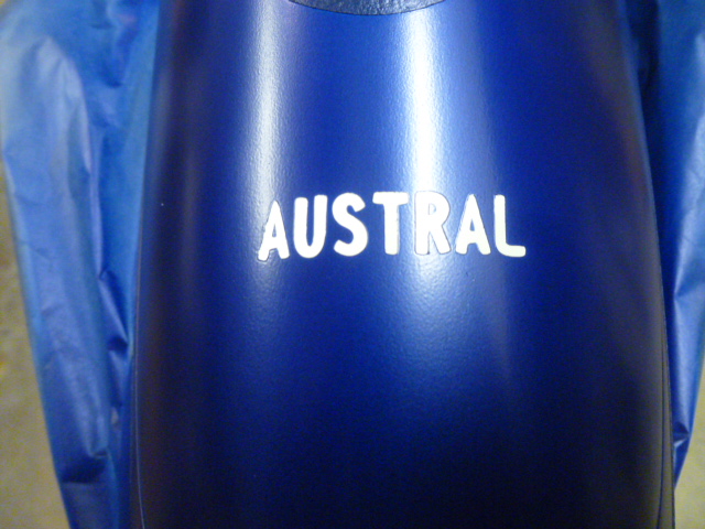

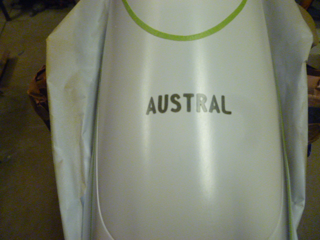

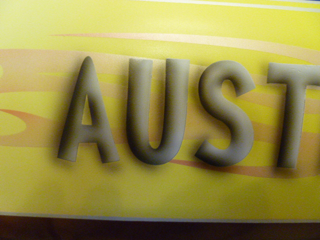

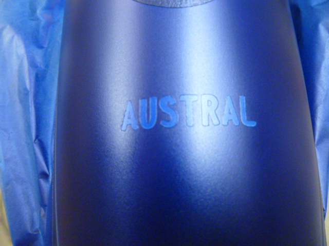

The Austral name was then layed over the flames. I am doing this opposite from the wings. On the wings the Austral name was shot to appear cut into the surface (concave). On the fuselage I painted it to appear as though it were protruding (convex) from the surface. I do that by painting white on the highlight side and black on the shadow side.
I now hand airbrush in a drop shadow to enhance the allusion further.
Finished

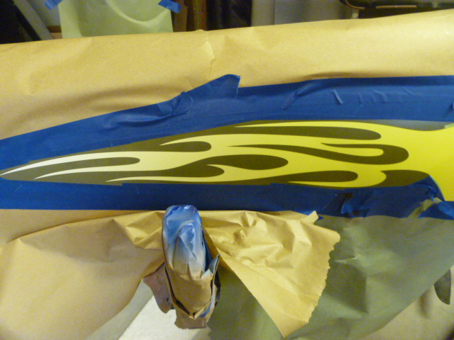

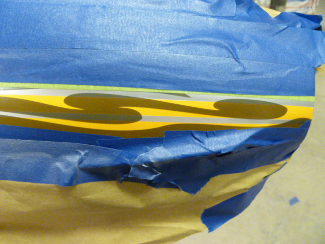

OK I'm coming to the end.

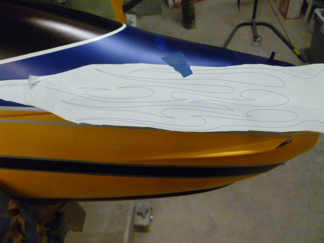

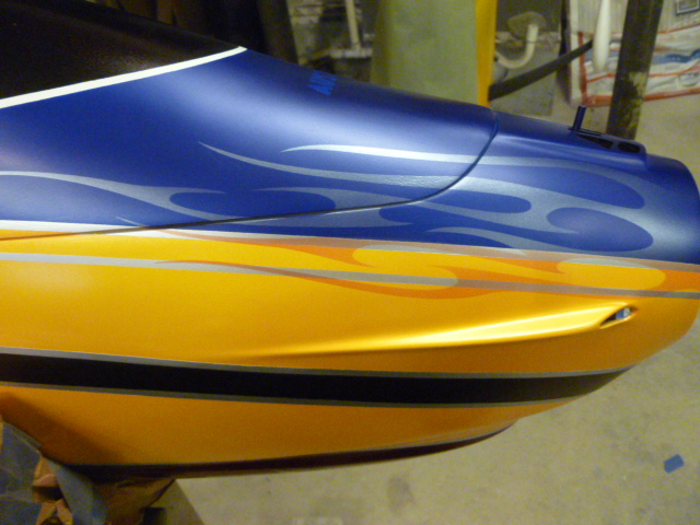

As I said earlier, I try not to work off a firm pattern. As things start to come together, the plane will tell me what it needs. My actual tape layout was actually quite a bit different from my original drawing. With paper templates I wouldn't have been able to be as flexible.
After I had all the graphics on that I planed to do, the front of the fuselage just didn't look complete. It needed something to balance the center and tail graphics. I have several flame graphics and found one that fit perfect. I didn't want it to be overpowering so I painted them as very subtle ghost flames.
This is why I always try to do a paper layout before I cut the masking film. I printed it out and it was a bit small, so I just increased the size of the mask and it fit perfect.
One thing about flames is to take into account how real flames would travel across the front of the plane. The way I envision real flames is they would be rising at the front and then slanting back down. That's how I laid out the masking film. I just dusted silver pearl over the flames that were over the blue.
After the sliver pearl was shot I unmasked the areas that the flames laid over the orange and masked back over the blue.
Over the orange I dusted pearl red.
The key to ghost flames is to shoot about half the paint you think it needs, It really multiplies after it's unmasked.
After the clear is on, the flames will be very transparent and glow in the sun. In some light conditions, they will be very hard to see, thus the name "ghost flames".

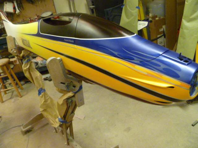

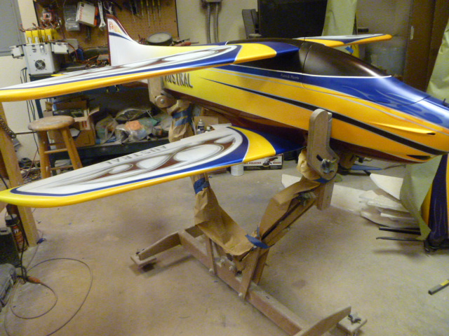

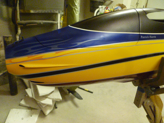

Alright, the last and most important graphic!

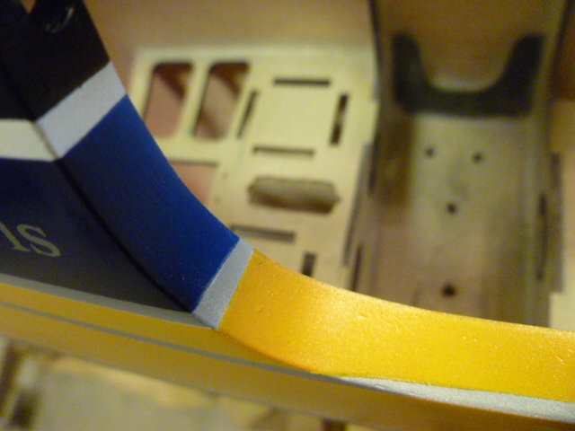

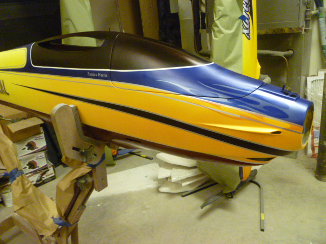

One of the things I like to do is finish off the paint lines on the canopy opening. It only take a few minutes and adds that extra bling.
Here are a few final shots before the clear is shot. I still have to finish and paint the wing struts.
The canopy is not straight black. I hit on a combination a that really looks exceptional in the sun. I first shoot it with black and then lay a pretty heavy coat of HOK red candy with red Metajewels. The black stripe on the fuselage is painted the same way with silver pinstripes on the edges.
The real key to one of these type of paint jobs is to really focus on all the little small imperfections and FIX them. It's amassing how long it takes to clean up all those little spots. I spent about six hours just fixing stuff on the fuselage and still have a few more to go.
Next...clear, cut and buff.
BTW, I used 38 different masking films on the whole plane. Close to over the 40 some I used on the Evolaris.

The last Austral graphic that you painted, what is that font name? I've never seen it but I like the way it came out. I would love that for my NMPRA numbers, especially painted.
Doug
Glad you are enjoying the journey.
I hope I still have the name of the font as once it's converted to a vector file I don't know what it is. It is one of the fonts in Corel Draw. It's the same one I used all over the plane. I just keep making different sizes of it. I will check later and let you know.
#216
Doug,
It probably won't help unless you have Corel Draw. The name of the font is DFPOP-W9. Catchy name for a font.

The fire is done with about 60 to 70% freehand airbrushing and the balance with hand held shields.
It's kind of interesting how this plane came about. Maybe ten years or so ago I was watching one of those car rebuild TV shows and this guy was on the show talking about a helicopter he painted in fire for the owners of a chain of pizza parlors. The story goes at a grand opening for a new pizza joint, by the time they landed there were fire trucks on the ground due to people calling 911 thinking a helicopter was crashing!
For some reason I had that in the back of my mind and thought it would be cool to paint a pattern plane in fire, but didn't know where to start. I did remember he called it "True Fire". Good old Google came to the rescue. I just typed into Google "True Fire Helicopter" and Bingo there it was. (Go ahead and type it in and you will find it just as fast) It only took a few clicks and I wound up on Mike Lavallee's site called Killer Paint. https://www.killerpaint.com/
No matter what you read on the internet, Mike was the guy that got the whole True Fire thing going. If you do a Google search, you will find a ton of guys doing it now and of course they all claim to be the original. Some guys even call it "Real Fire" to make it seem like they are doing something different. The problem with pretty much all the stuff on the internet about this just sucks.
I read a bunch of stuff and found most of it conflicting and the results were pretty poor so I just bought Mike's DVD on how to do it. He doesn't hold anything back on his DVD and tells you exactly how to do it. The challenge with it is most of it is done freehand and so it takes a while to get the "artistic" side of it down. It's not like the beveled edge stuff I did on the Austral paint job that is pretty mechanical. What I did was just start painting on a piece of sheet metal. Over a two week period I must have done it 15 to 20 times on that one panel. It probably had an 1/8 inch of paint on it.
The interesting thing about painting fire is it is really fast to do. In fact the faster you paint it, the better it looks. If you look at pictures of guys work on Google you will see most of them are way too mechanical...that's not what fire looks like. Coast Airbrush carries the DVD and they even have a True Fire kit of House of Kolor paint. That's how I started using House of Kolor paints. http://www.coastairbrush.com/search....=&stype=&scat=
