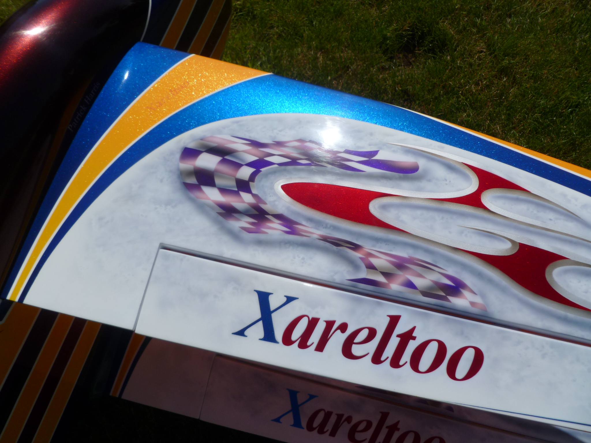

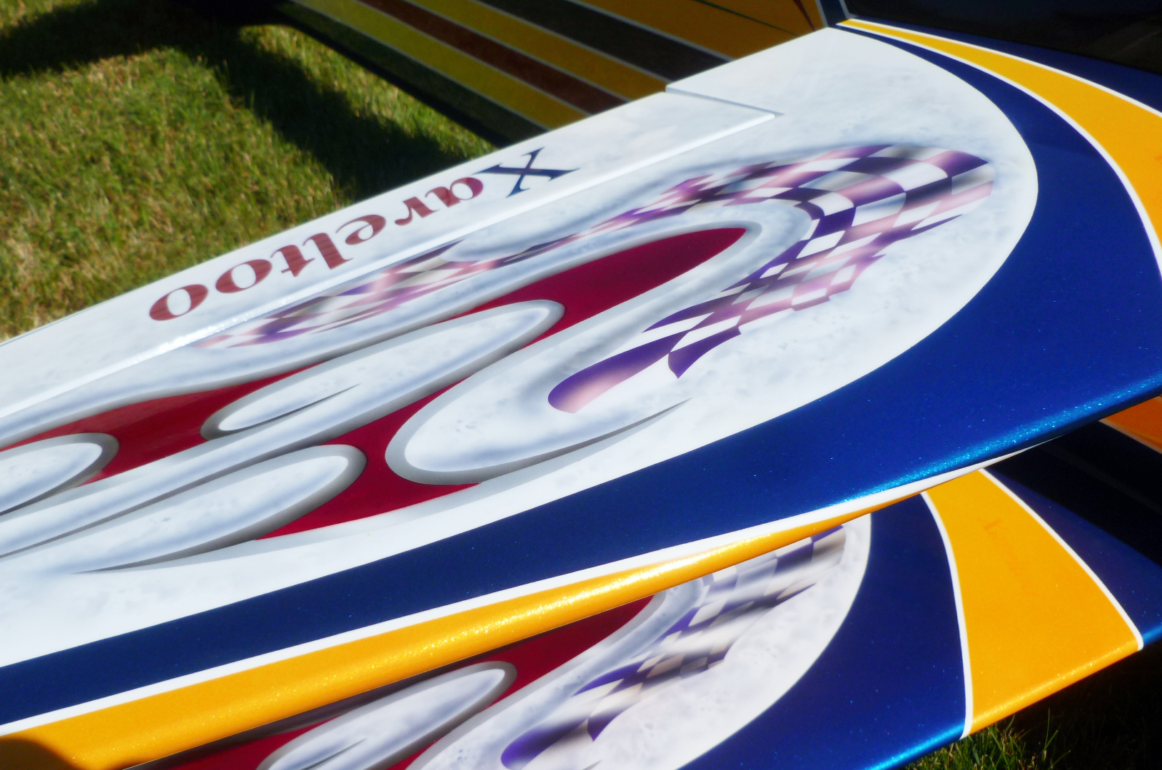

OK I'll take a stab at it (Pun intended). The middle axe (??what ever it's called) appears brighter in the second photo and shaded in the first. If the light is coming from the LE, the beveled edge of the axe would appear brighter.
What did I win?
P.S. Thanks for the education and inspiration. My next plane will have at least two colors:-) Normally I only use one! And it's plastic:-(

You are close, but no cigar! They shading on the beveled edge is correct, it's just the lighting in the pictures, but you are on the right track. Remember, it's not the red beveled graphic that's in error, but it's associated with it. Think "cause and effect". A little bit of Yin and Yang.

I think I've got it. A small red overspray on the middle axe?

A shadow is missing under the bottom ax

Originally Posted by Portlandflyer
OK boys, I made a very minor mistake in painting the left stab versus the right. Trust me, it's ultra subtle, so you have to look really close. Here is the left stab with the error.
Here is the right stab that was painted correctly:
Anyone see it! Clue...it's in the red graphic.

Your eyes are too good! There is a little bit of overspay on the spot and yes it does show up a hair, but that wan't the obvious mistake. Keep in mind, that beveled edge you are seeing is less than 1/8 inch wide. It shows in the picture a lot more than in person, so you are half correct!

Ding, ding, ding...Ken's the winner! Yep, you got it. Take a look at the picture drac1 (Scott) posted and you will see the shadow is missing on the small portion of the blade.
You guys realize that my eye is going to go to that microscopic bit of red overspray every time I look at it don't you?...Thanks a lot!
Take a look at the other stab and the pictures of the wings and you will see the shadow. A Persian rug must have a flaw if it is to be deemed, according to old proverb, perfectly imperfect and precisely imprecise, so there you go. I made those two mistakes with a purpose.
