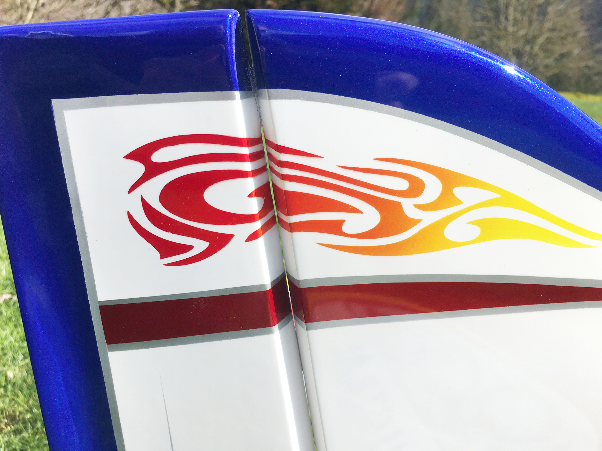

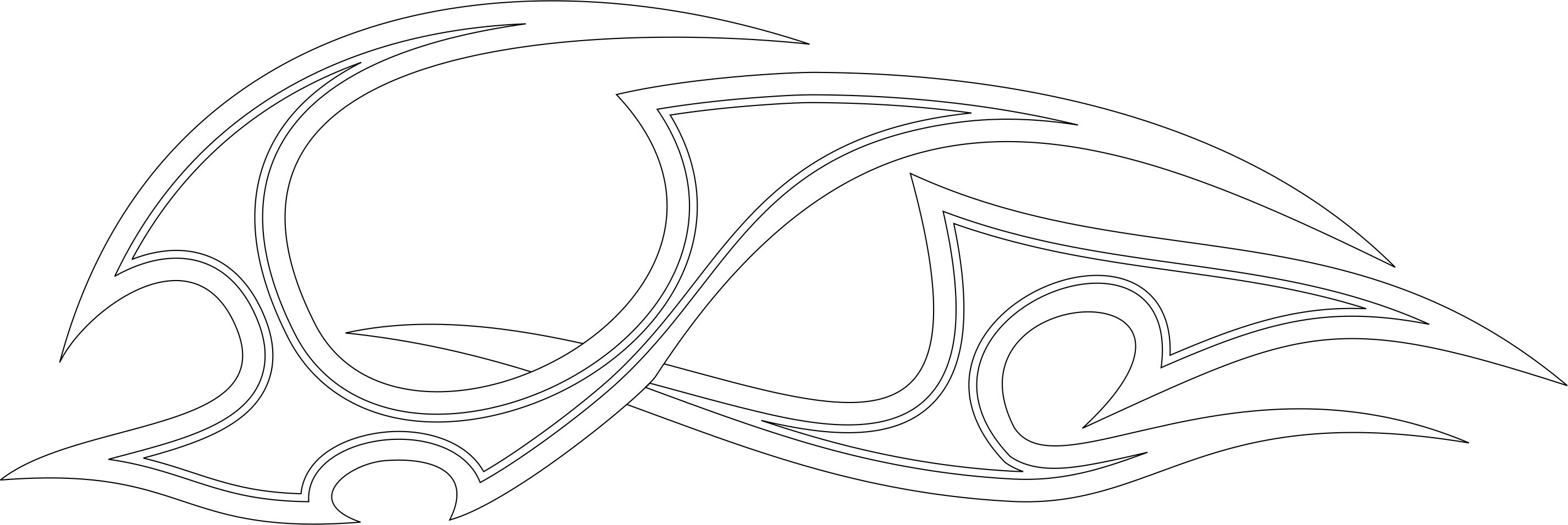

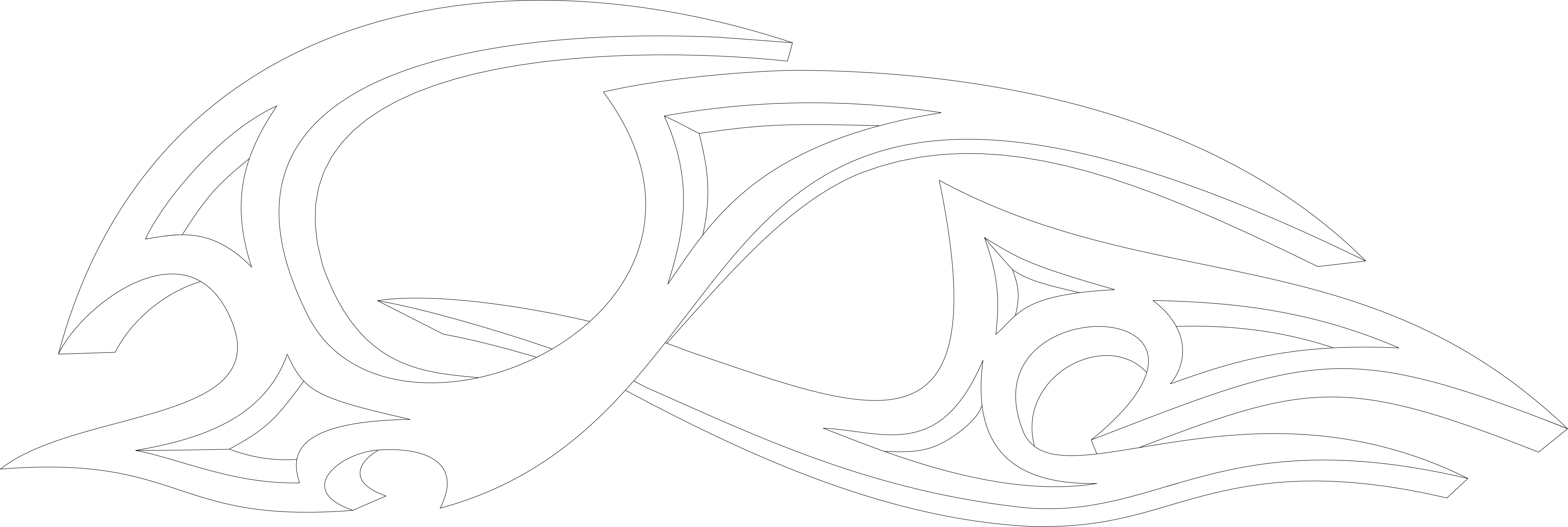

OK, it's time to resurrect this thread. I am building my second Austral bipe and have changed up the painting a bit. What I did was take the same graphic I used on my first one and reworked it a bit. In Corel Draw I just dropped out the two lines that create the double bevel in the original. I added some cutouts to the design and ran the file through the "Extrude" app in Corel Draw, that gives it a 3D look. The whole process took maybe 30 minutes, but will give it a whole different look. ;
Here is the original file
And the revised file

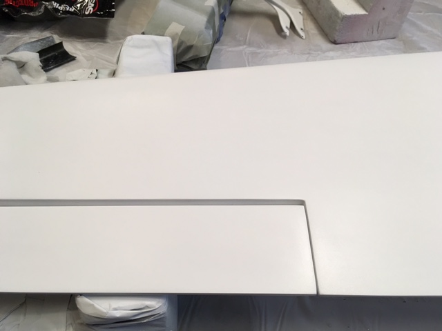

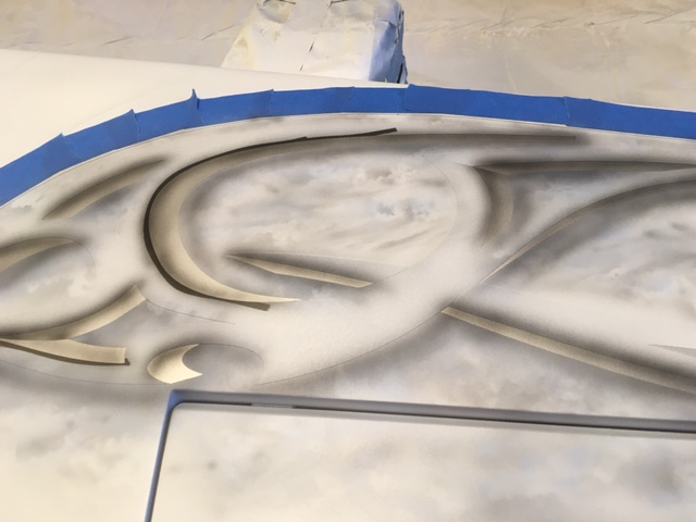

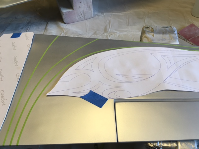

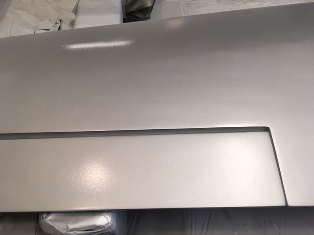

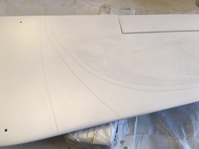

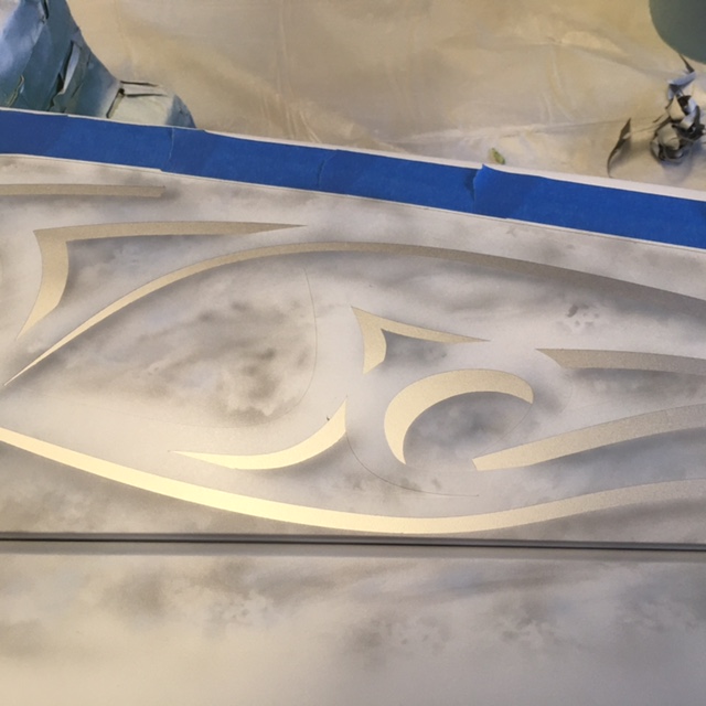

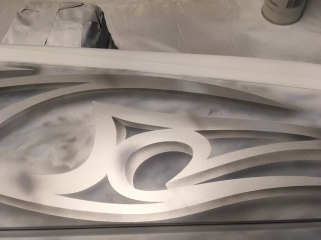

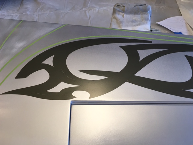

I first shot a light coat of white over the whole wing to block out the primer.
I then shot House of Kolor fine Metalume over the white. This silver will create the pinstripes and the 3D graphic.
Here I use 1/8 inch fine tape that will create the pinstripes. I use a paper template to lay out the pinstripes around the graphic.
I now add the graphic paint mask.
I now shoot a thin coat of white over the whole surface including the paint mask. Keep in mind that under the 1/8 inch tape and the paint mask is silver.
I now add some random texture with an airbrush to the area that will surround the graphic. This is done with blue added to black followed by some blue added to white. Nothing fancy. The more random, the better.
I now pull the masking film that will create the 3D part of the graphic.

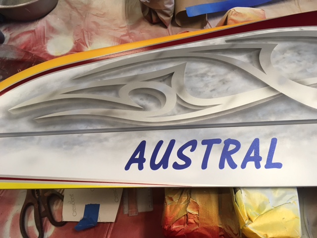

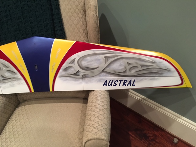

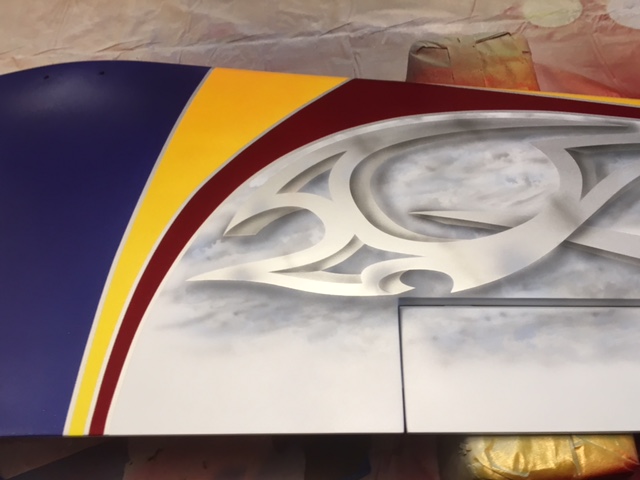

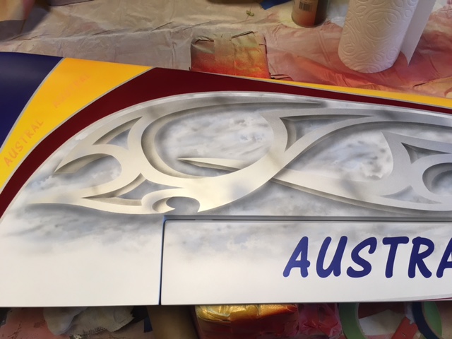

I then airbrushed some thinned black on the 3D part of the graphic and shot a light drop shadow onto the textured base to give it more of a 3D appearance.
Next I pulled the main graphic mask and shot a few lines onto the top of the graphic with thin black to give reflective highlights. I also shot a little bit of white in random areas for highlights.
Now the balance of colors were shot.
Austral name added.

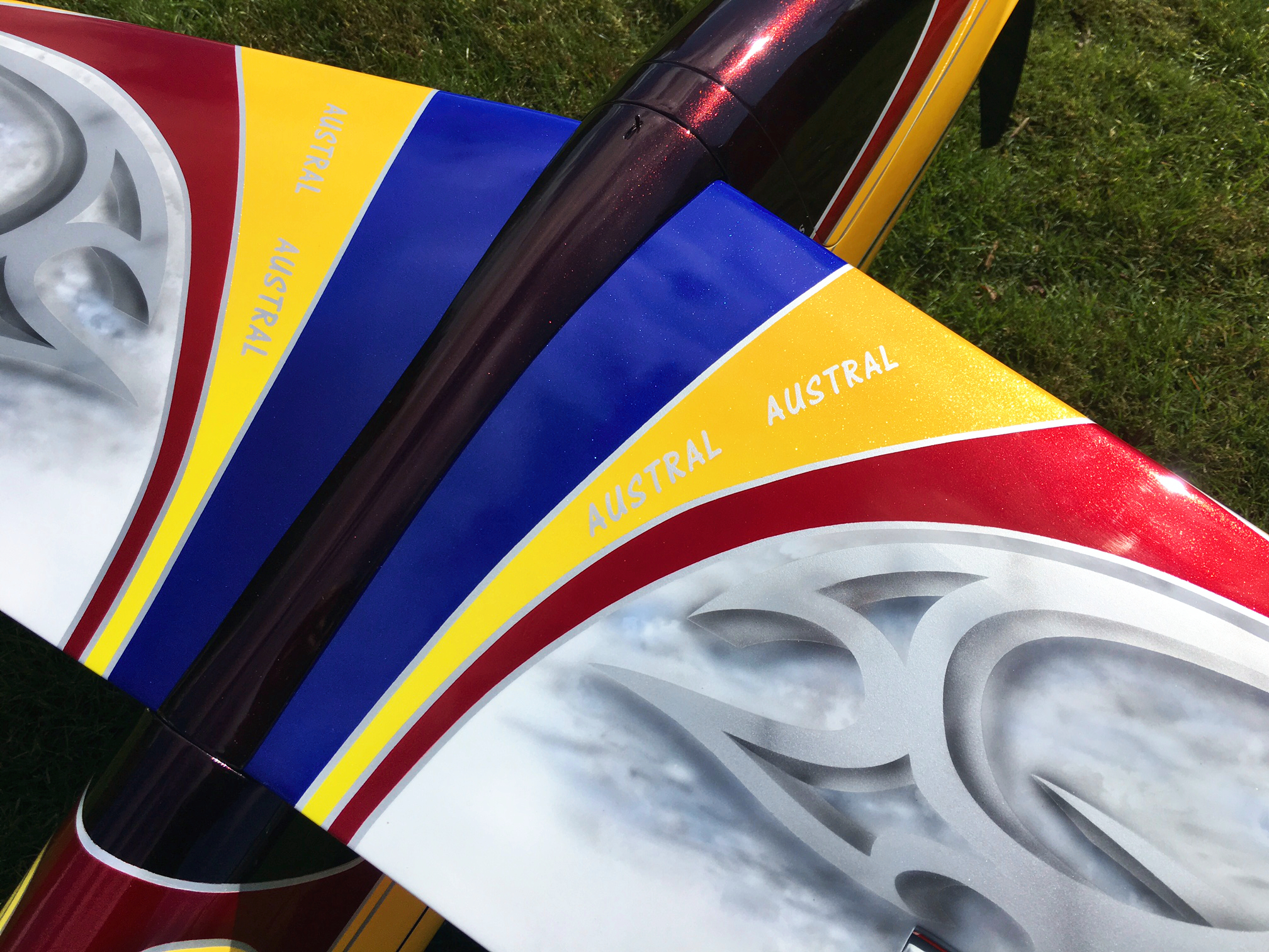

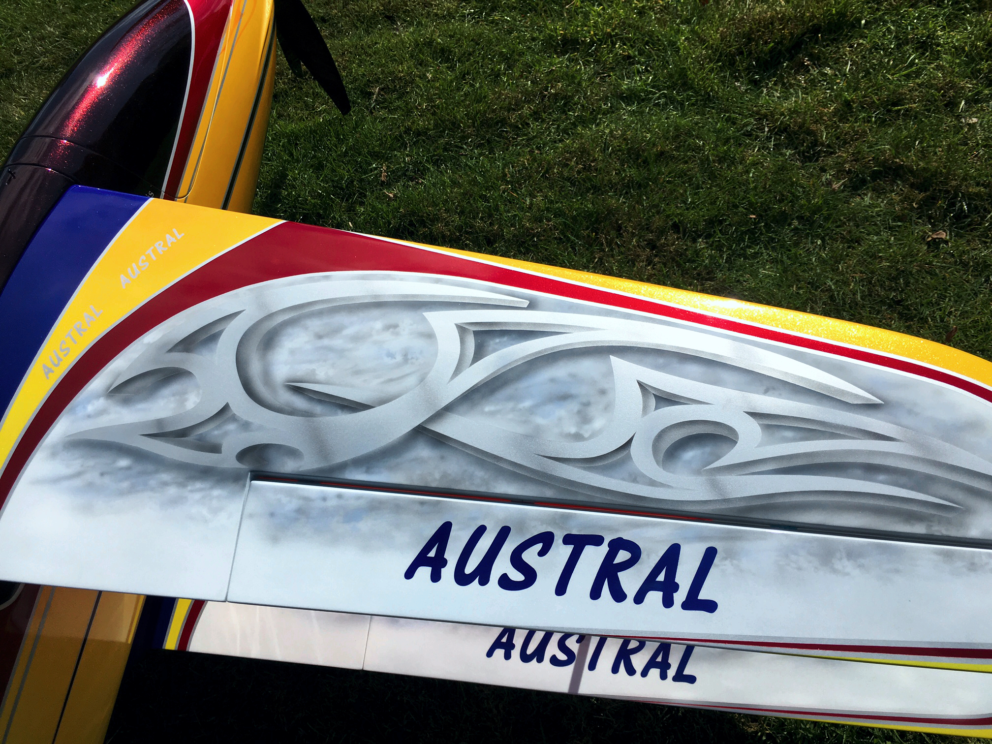

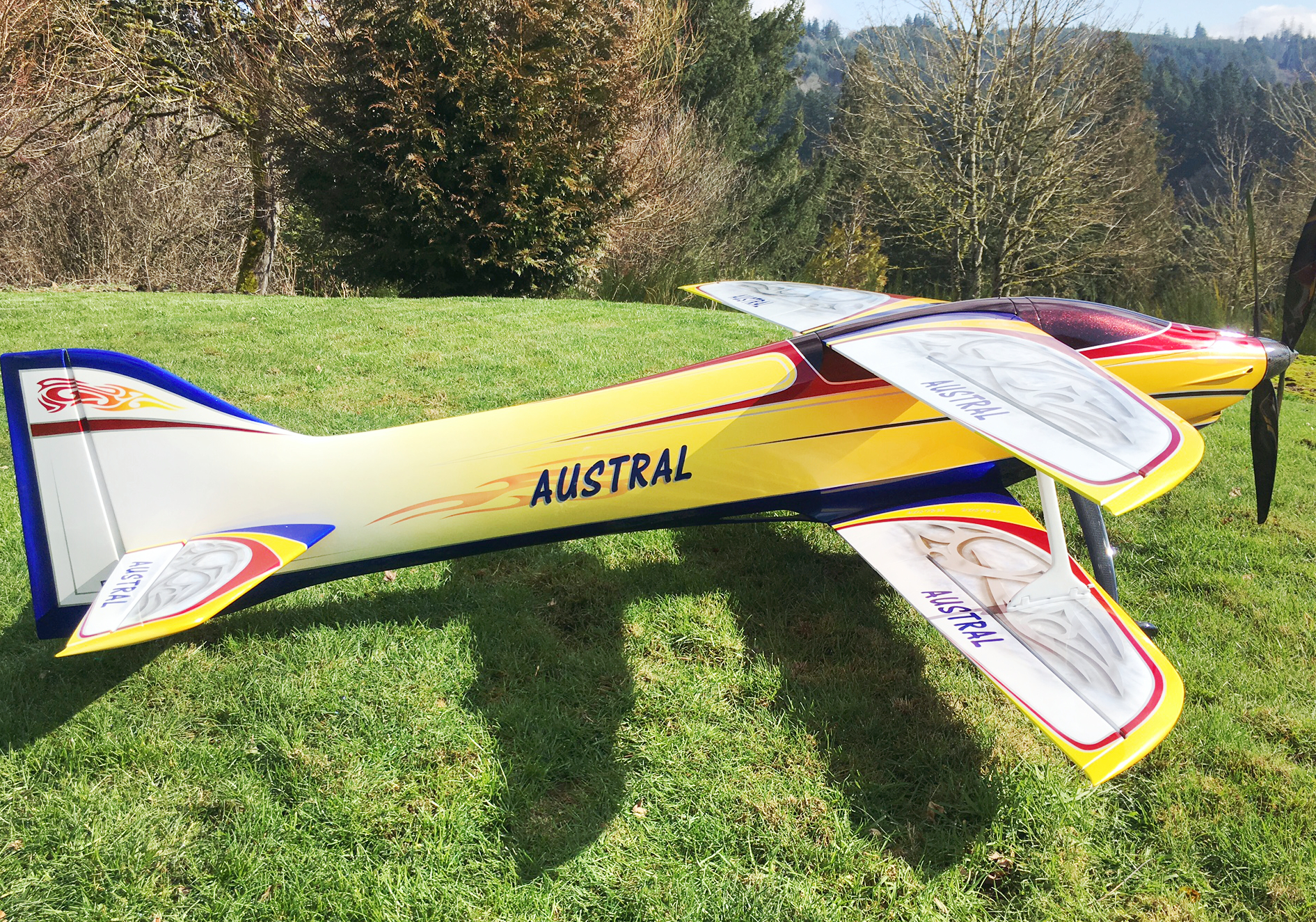

In the very last picture above you can see how I airbrushed two Austral logos onto the yellow band in orange. This shows how much flexibility you have using computer generated masking film. I didn't like the orange, so I cut additional mask and carefully applied them over the orange logos. I then airbrushed a bit of white over the orange logos and shot silver (Metalume) over the mask.
I shot House of Kolor Metajuls over all of the colors to give it a metal flake look. They will pop when the clear is shot.

Almost ready to go.

I like your style, Pat. It's unique but the colors are also very utilitarian. The plane just looks right with what you did.
Thank you. It is a challenge to keep coming up with new stuff, yet keep the basic colors I can see. For me, white, orange and yellow are the most visible.
