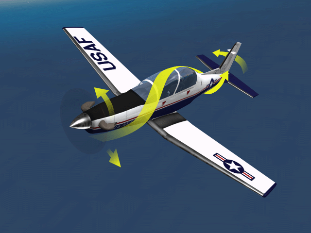

  #64
Joined: Jan 2014
Posts: 4
Originally Posted by drac1
The old "Spiral Slipstream" myth.
Slipstream swirl is a corkscrewing airflow that travels around the fuselage.
This airflow strikes the vertical stabilizer, increasing its AOA. The increase in AOA of the vertical stabilizer pulls the tail to the right and yaws the nose to the left.
This situation is more prevalent at high power settings and low airspeeds.
To compensate, right rudder is required.
Name:	Slip stream.png
Old 08-26-2016 | 02:42 PM
  #65
drac1's Avatar
Joined: Jul 2008
Posts: 1,750
Received 10 Likes on 9 Posts
From: Romaine, Tasmania, AUSTRALIA
Yes, I know the definition of the myth. That doesn't mean it's a real phenomenon though.
As far as I am aware, it's never been proven to actually exist, just a theory. If you have evidence, feel free to share.

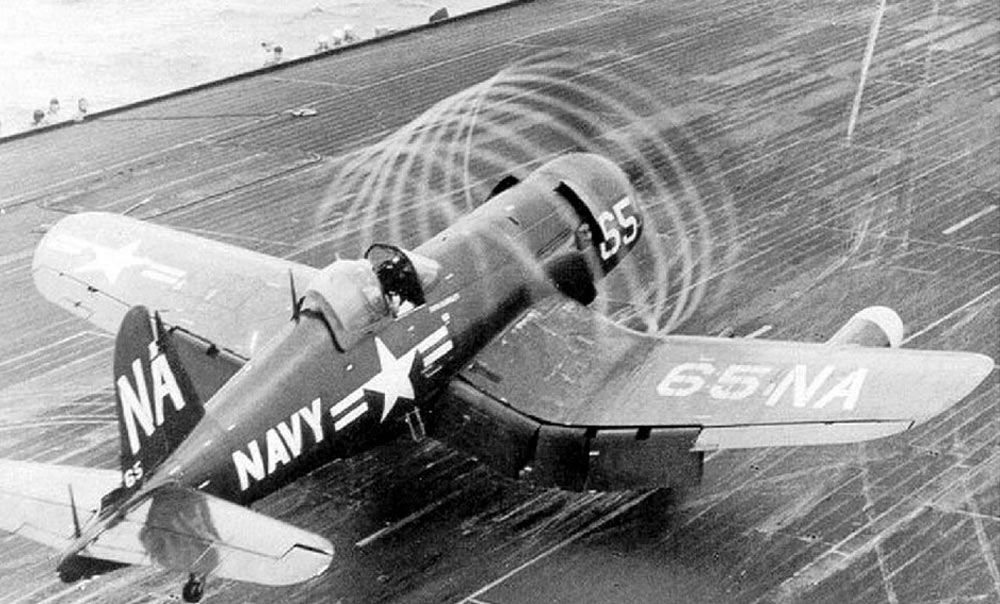

Originally Posted by n233w
I don't know if this is proof, but it looks to me like evidence. I corresponded with the pilot. The photo is from Joe Nall a few years ago. The prop did not touch the water, but the wheels did. What do you think made the spiral pattern in the spray aft of the tail?
Bill
Correct, not proof. If it was that easy to prove, the SSS advocates would be all over it in a flash.
If you put streamers down the sides of the fuse, I bet they would blow straight back.
Also how could it spiral around the fuse when there is a big fence called a wing and the stab which would prevent it from spiraling anyway.

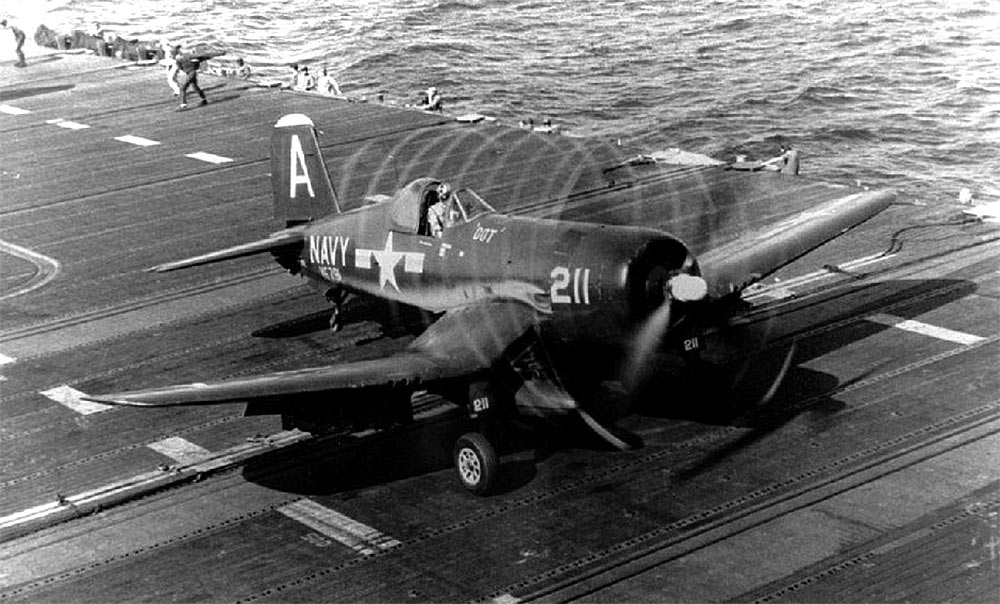

http://www.boldmethod.com/learn-to-f...ng-tendencies/
A little Googlefoo found this.
drac1, please don't misapprehend: the air, aft of the wings and tail, is spiraling.
