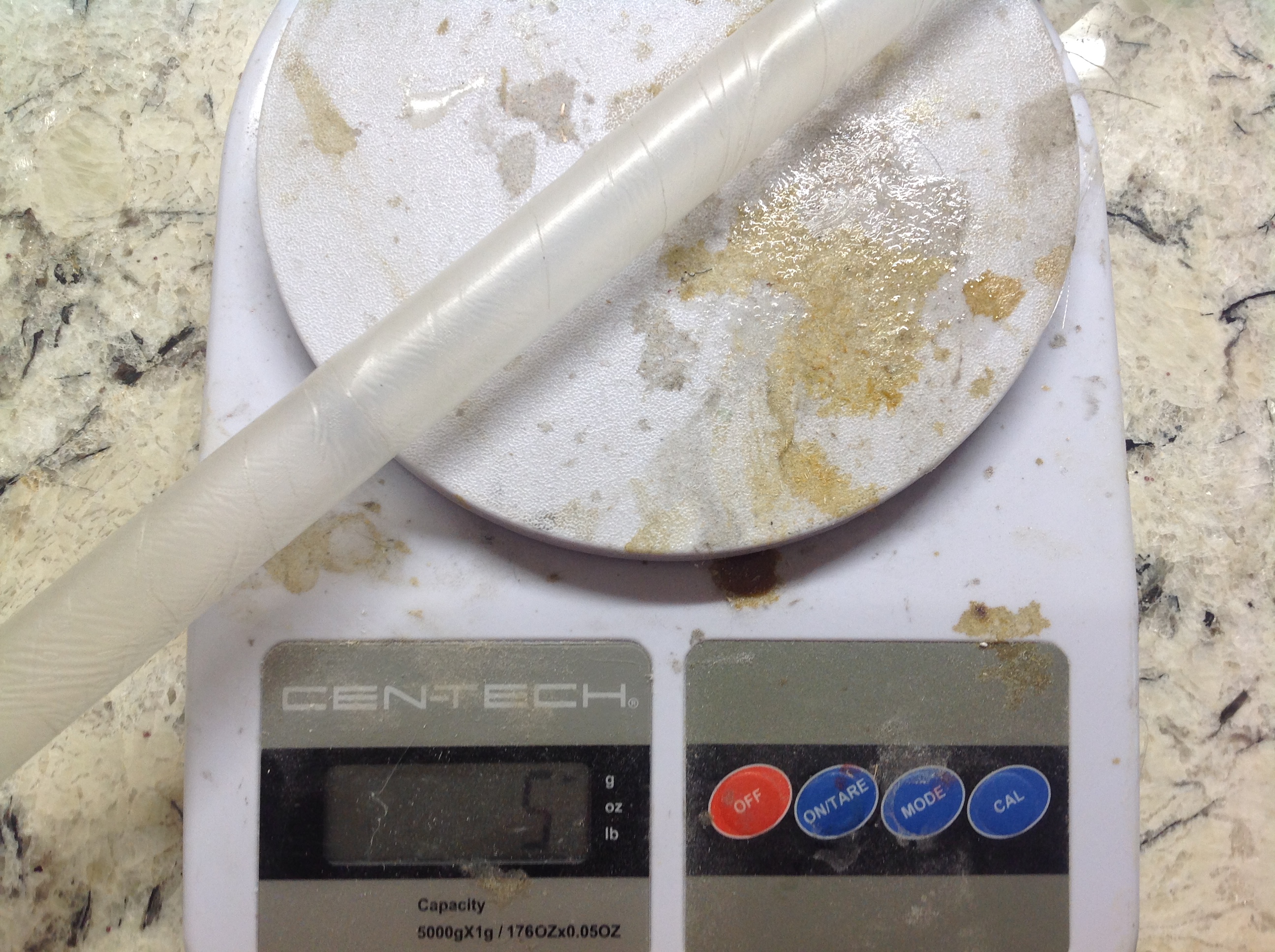

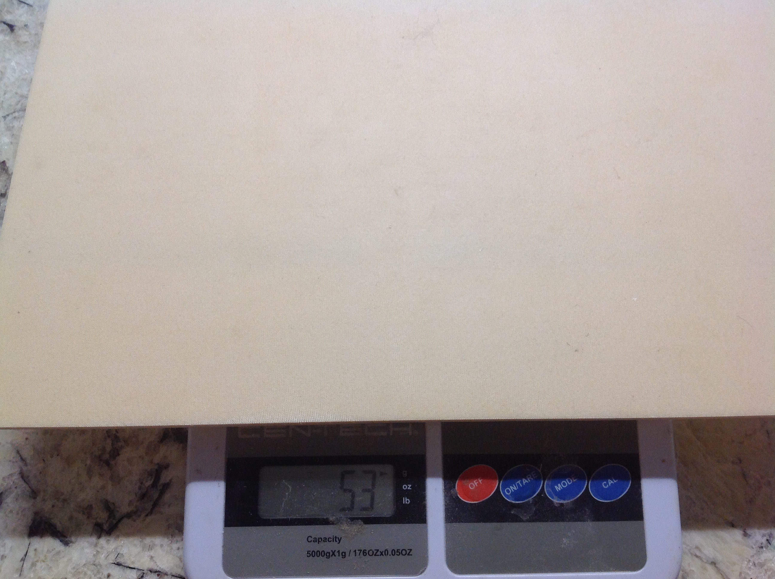

Flat panel details. The glass panel is 12"x12" and weighs 50 grams, thickness is 1/8".

Pretty cool Shawn. What did you make that wing socket out of? Looks like epoxy and glass cloth, but it seems kind of transparent. 1.5 ounce?
Scott

Scott, it is 3 layers of 1.4 oz. No real strength needed. These will go into the wing and the last tube which goes into the fuse will be a bit stronger. Making tubes is actually a bit more involved then what I originally thought.

I found that making tubes is pretty easy, making tubes that you can get off the mandrel is another story. I have sent many carbon fiber tubes to the trash with the mandrel still attached.
Scott

Exactly the issue I was having. Not so bad making them on aluminum tube as the mandrel but this go around they were made on a CF wing tube. First try was putting 2 layers of packing tape on the mandrel and waxing. I had to split the tube to get it off. Next I wrapped the mandrel with 2 mil plastic painters tarp material, did the lay up and then spiral wrapped the works with more 2 mil plastic. It was rather easy to get the sleeves off the mandrel this time but I'm not completely happy with the exterior finish. Next run through I will spiral wrap with peel ply and then bag.
I did cut the sleeves to length and then cut some root ribs and ribs and sleeve supports out of some fiberglass skinned Diviycell.

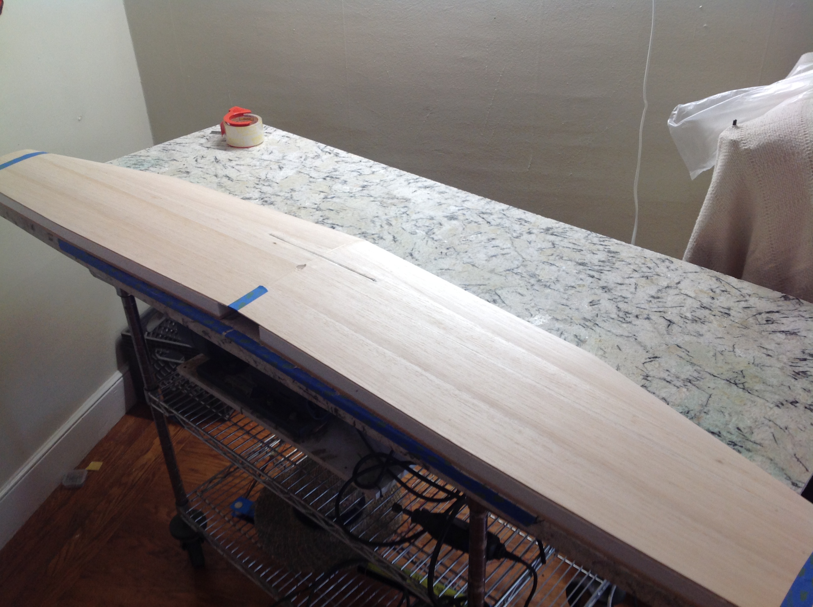

Yesterday I sheeted the second bottom wing panel and today they have been joined. The joiner is a peice of 1/8" vertical grained balsa with 3.7 oz glass on each side. As you can see it ties into the wing skins. Depending on weight, I would like to glass and paint all the wood surfaces. Usually on something like this I will glass with 3/4 oz cloth with an 8" overlap in the center and then an additional 10" layer of 1.4 oz in the middle. If I end up having to use iron on film then it will be 2 layers of 1.4 oz cloth 8" and 10". I think I have it straight enough while the epoxy cures.

Looks good to me. I'm a bit surprised at the one piece wing but it is a way to make it more rigid and makes mounting a bit simpler. Maybe a one piece is the norm for F3A bipes?????

I did a few hours of internet searches before I started this project and saw that most F3A biplanes had one peice wings for both top and bottom. I like this for the bottom as it provides good access to equipment with the wing off and the flange that is created in the mold will help keep the mold true. It also will provide access when seaming the fuselage. I saw some pylon mounted wings which I didn't like as I feel it is a missed opportunity to gain some rigidly. I knew I would need a battery/motor access hatch up front but did not want to make a second hatch for the canopy/wing cover. A plug in top wing made the most sense to me. It adds a great deal of strength which has allowed me to build the lower wing a bit lighter because of the box arrangement the whole thing makes.

Should be flat Shawn, that sheet of marble helps. I use a sheet of thick glass on my table saw table, which right now has a piece of carbon - Divinicil - carbon vacuum bagged to it. I like the idea of iron on film for the wings and tail for weight reasons. That being said, you have seen the junk I fly, it is light but not likely to win any beauty contests. On your plane, paint will probably be another half pound when it is all said and done?? Significant, even if it is not as pretty.
