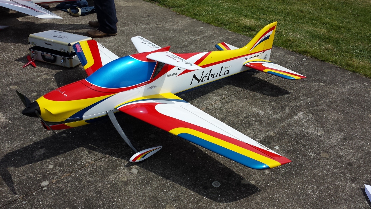

Hi Shawn
Nebula is already used in France.
Friend of mine Rémi designed his personal plane.
Claude
ID:	2228339   Click image for larger version

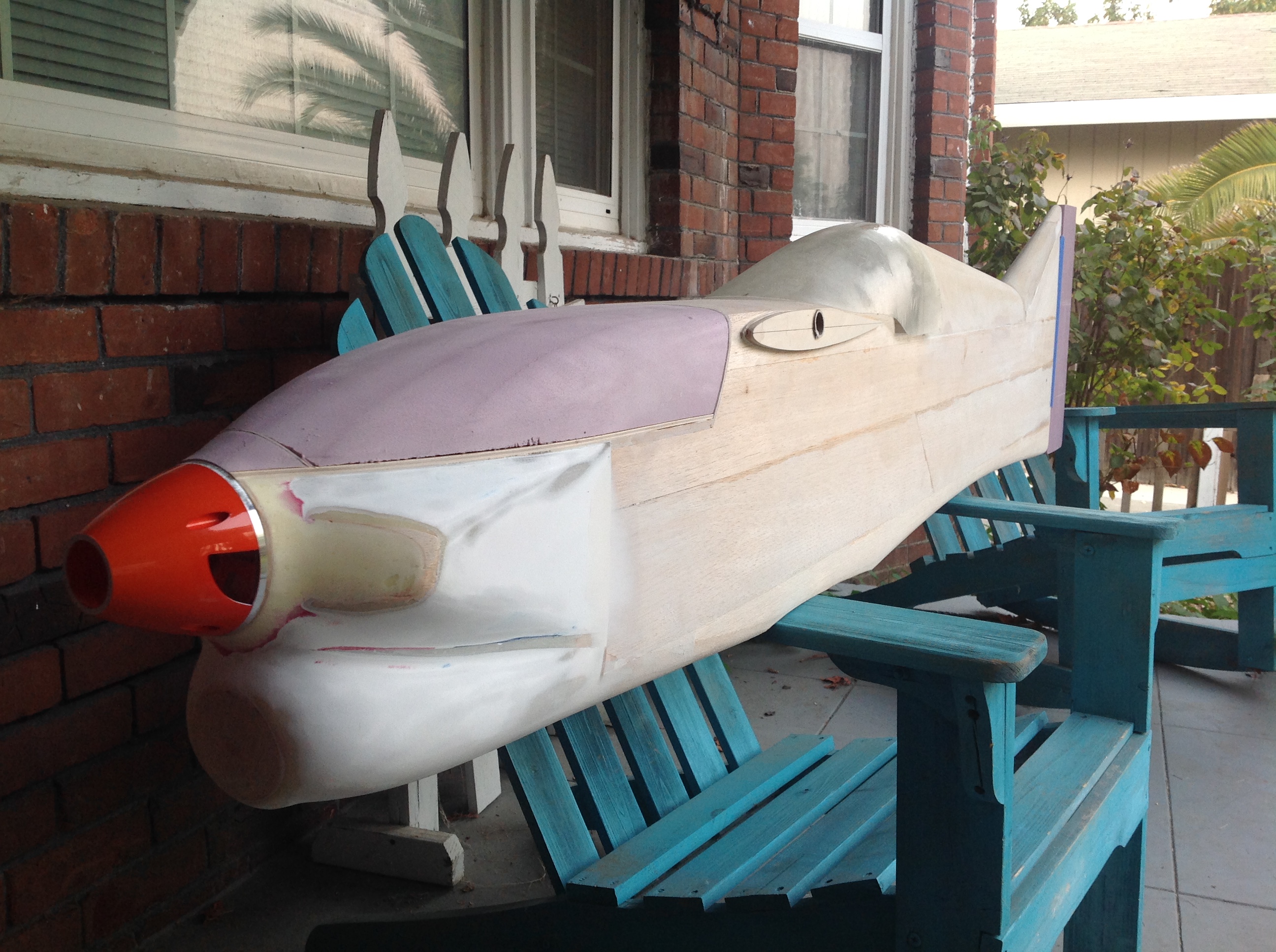

Sanding, sanding, sanding.......I forgot how much fun making a plug was. However, the more I work on it and get it closer to its final shape the more I like it. The hatch is being made from pink foam and only has about 1/2 hour of sanding so far. Just to get a feel for the rudder I cut one out of pink foam as well. Going to start with some sample layups to help determine what weights of cloth and core material I will use.

A few better pictures after some sanding. Tomorrow, a bit more sanding and then I will glue the canopy in place. By the end of the weekend I hope to have the fuselage ready for glassing and wing templates cut. I have been doing research on epoxy resins for both the molds and final production. I will be talking with my buddy Scott over the weekend about the resin system he uses for mold production and have decided that MGS will be used for the production of parts. I figure I will need a resin that will give me 2 hours of working time. The fuse will be a minimum of 3 layers of cloth with a core material that will need to be vacuum bagged. 2 hours will be pushing it.
ID:	2230093   Click image for larger version

The canopy has been glued on and the first round of filler has been applied. Next week I will lay down a layer of 3.7 oz cloth which will get blocked out and then a finish layer of 1.4 oz. then of course prime and paint will follow.
ID:	2230291   Click image for larger version

Shawn, you might want to touch that canopy up a bit.. It fits about like a saddle on a hog.
Scott

Yep, I will have to pot it in place to really get the fit correct. After the fuse is glassed I will cover the hatch area with Monokote and then wax. I will then put down a couple layers of 3.7 oz cloth to form the bottom of the hatch to an exact fit to the opening. I will brush a paste of epoxy and cabosil on the bottom of the hatch plug and put in place. After the epoxy has cured I can do the final sanding and then actually glass it into place. Once that has cured and gets blocked out, it will be cut free and then will be a perfect match.
