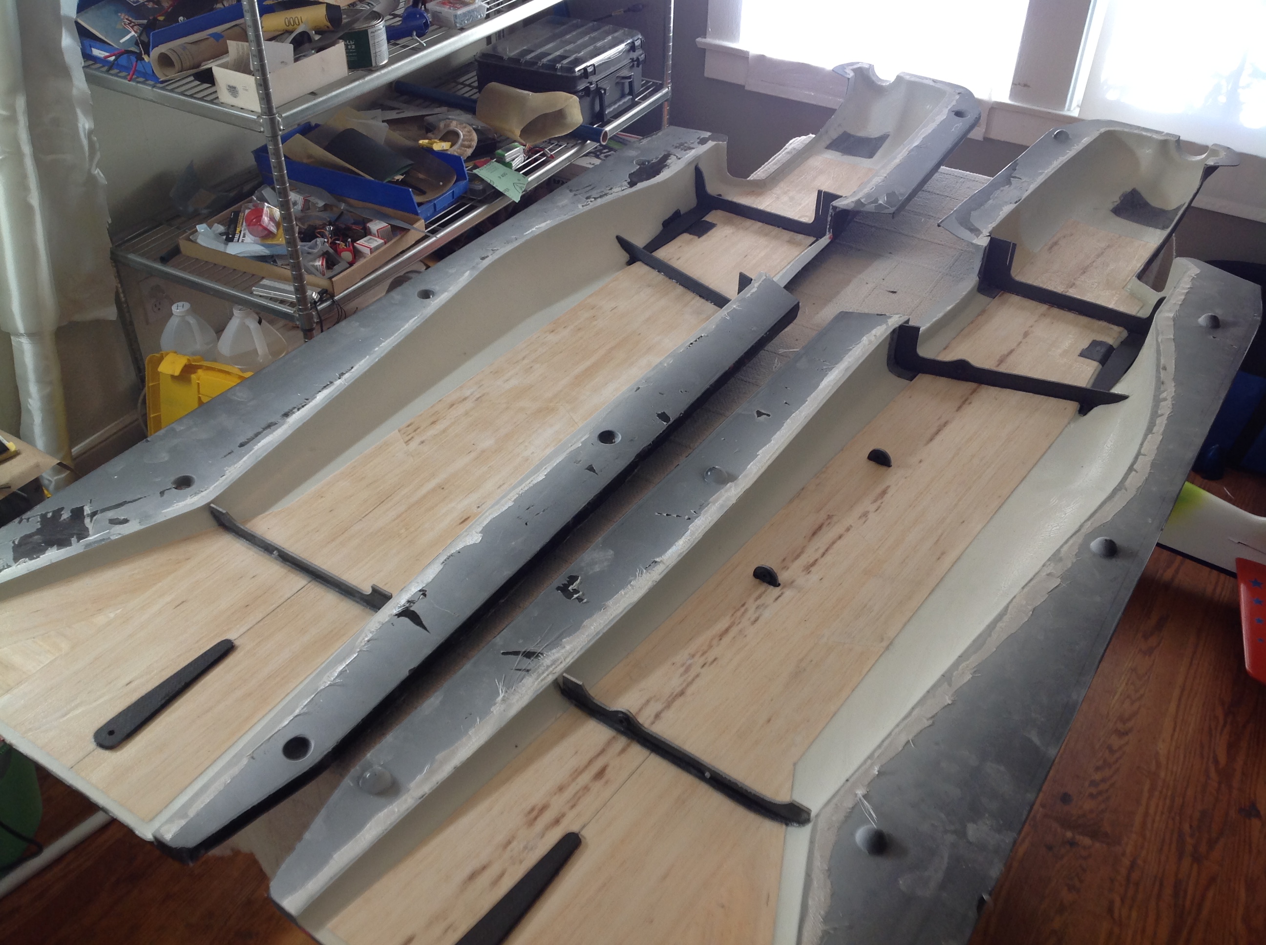

Productive day today. Got all the formers in and parted the hatch mold.

I just realized you have some balsa sheet in the mold. Is it being used for extra stiffness? Sound dampening? I guess I assumed the glass alone would be "good enough".
Ken

Ken, a fuselage this large needs a core material to stiffen it up. To do that with just fiberglass would make for a heavy fuselage. I chose 1/32 balsa because of every type of foam that could have been used, balsa in this case gave the best strength to weight ratio. Hopefully tomorrow I will have a final weight on this fuselage. The max I was shooting for is 30 oz.
