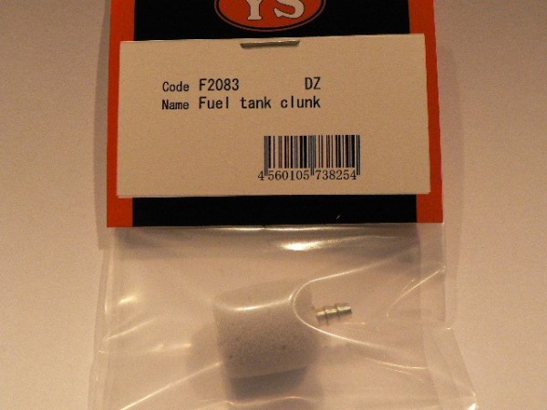

Hello Scott
I used fuel tank clunk with foam (as shown on picture).
Once foam broke and clogged durit. Since I use 2 tank with normal clunk. It's work very well.
To set up pump, I use a manometer installed as shown on picture.
It's awesome to control and adjust pressure pump.
At the iddle or when engine running only with starter, pressure must be 1,2 bar.
Claude

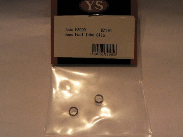

Hello
No problem with original fuel line after pump if there are clips.
At the beginning before adjusting pressure was about 3,8 bar and there was no leak. So engine was very too rich.
Ferrari belongs to friend of mine. He flies with a Calmato. So I have a cheaper Renault but a YS 200 CDI on my pattern.
Claude

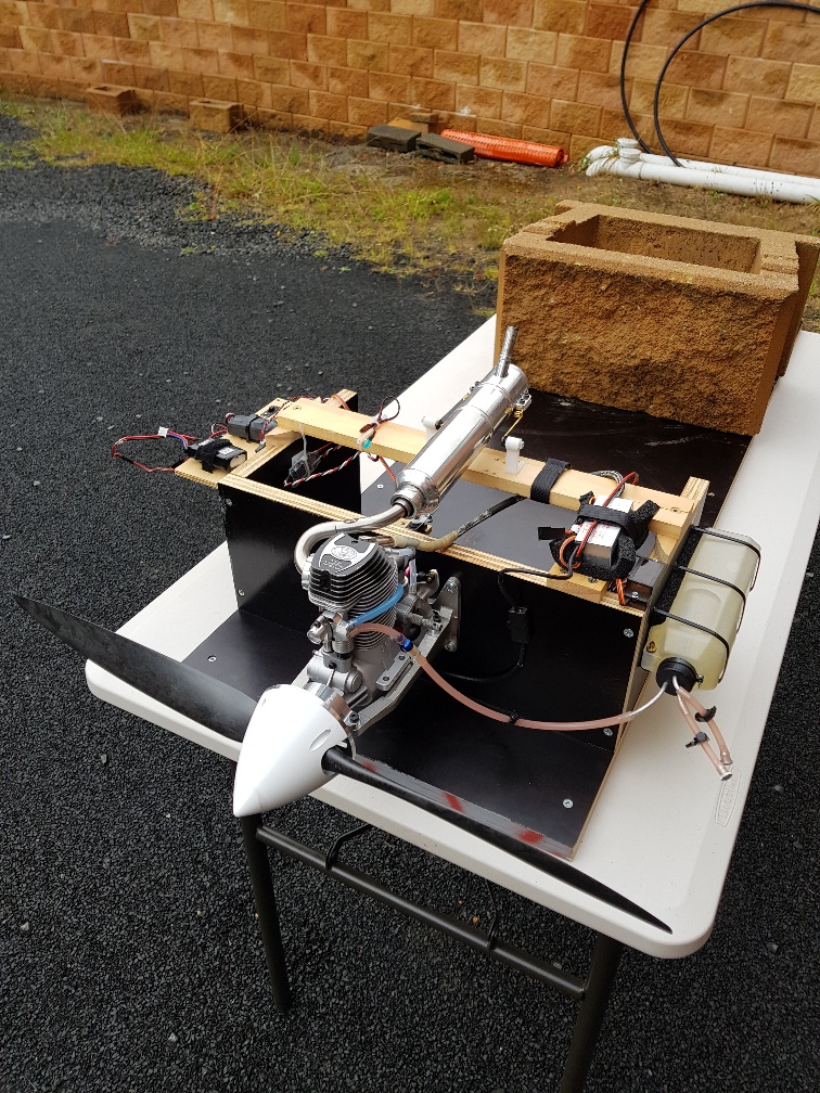

My second 200cdi in the test stand ready to run and then running.
Reg left as straight out of the box, main needle 1 1/2 turns out and the break in needle 1/2 turn open.
Very rich, but will start leaning off and closing the break in needle after 2 tanks.

After 5 tanks of fuel through on the test stand, the engine is running well. I let it idle for 2 minutes, it then throttled up without any hesitation at all. RPM peaked at 6900 and after a few seconds it settled at 6750. I'm very happy with that.
Old 02-25-2018 | 03:42 AM
  #93
drac1's Avatar
Joined: Jul 2008
Posts: 1,750
Received 10 Likes on 9 Posts
From: Romaine, Tasmania, AUSTRALIA
Both my planes are now 200 powered.
it has always been my experience, that a YS tuned on the test stand, will not be the same when in the plane. My second 200 proved no exception.
The engine was idling and transitioning perfectly in the test stand. Once in the Valiant it was running very rich, but I left it at that for the first flight. After landing, I checked fuel consumption - 500ml for P17. Way to rich.
So I played with it for awhile and ended up with the reg 3/4 turn leaner. Idle and transitioning is good, but may be just slightly rich still. Main needle is around 1 1/4 turns out.
It was almost dark by this time, so will have to wait for further flight testing.
