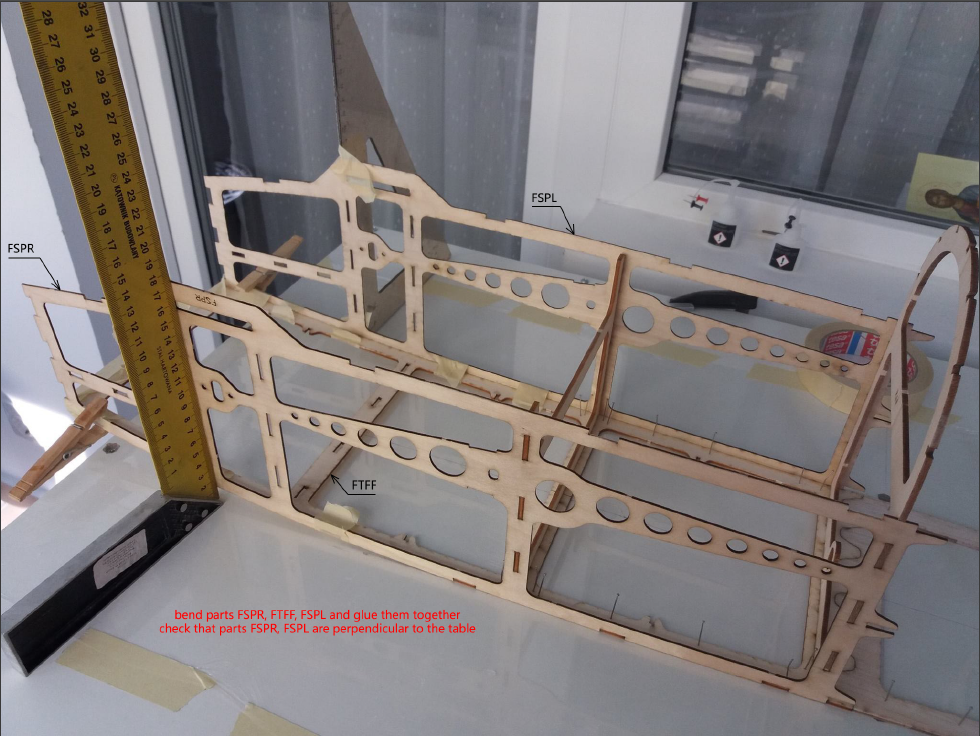

Hi Alex i have other question
On folderVortex_Drawings_BF \ Vortex_Drawings_BF \ 1_LASER CUTTING FILES \ 1_Hard Plywood 1.5mm
This folder 1_Hard Plywood 1.5mm for balsa 1.5mm he will connect with fuselagem 3mm why this folder is front part Vortex will work plug connect 1.5m to 3mm?

[QUOTE=AndersonR;12607801]Hi Alex i have other question
[QUOTE]
Sorry, i'm not sure i understand the question. As specified in the name of the sheet and folder, these parts are made of 1.5mm plywood, not balsa. The 3mm balsa sidewalls will cover the fuselage from firewall to tail, so that includes the 1.5mm plywood parts in your pictures.
