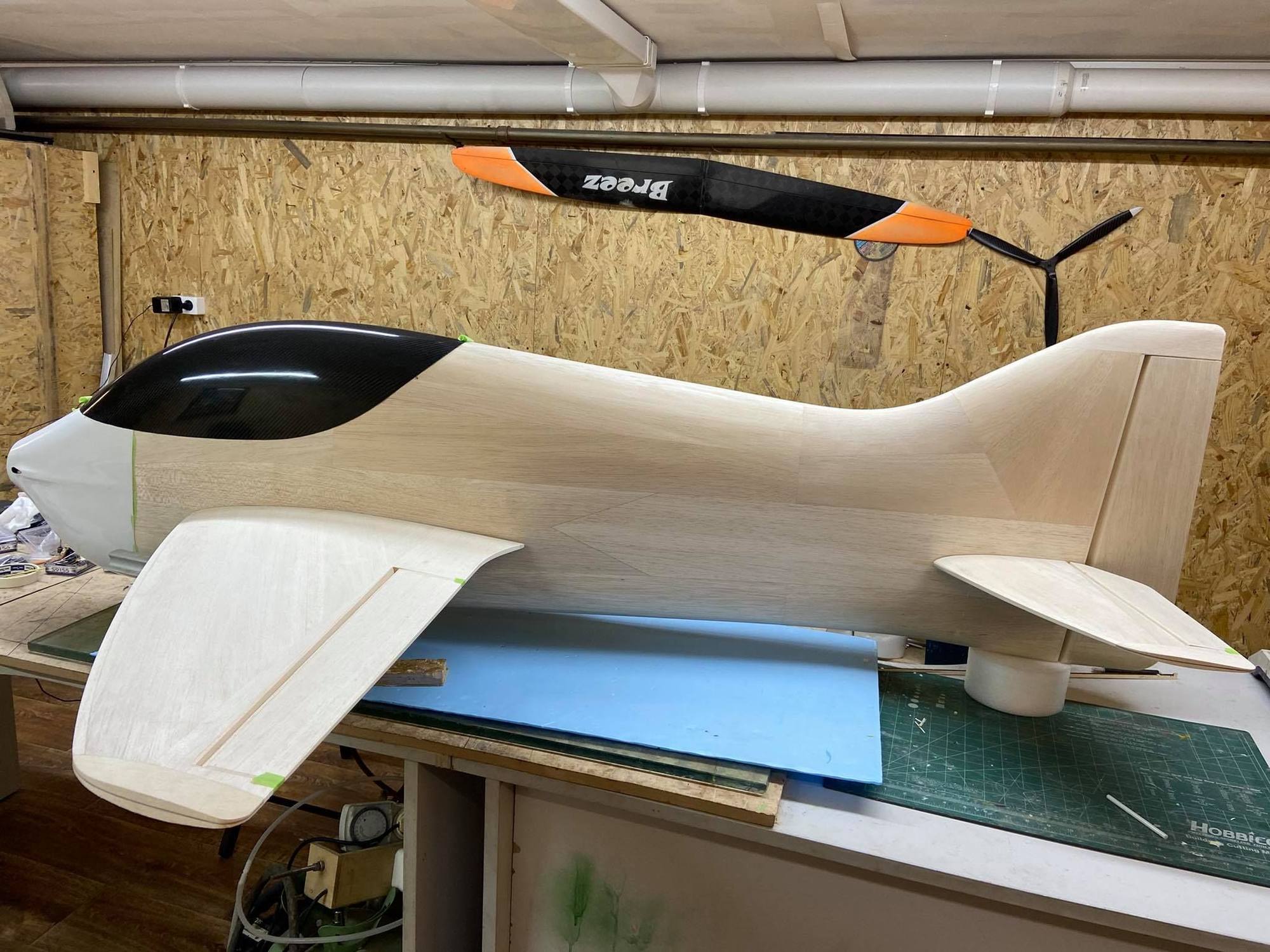

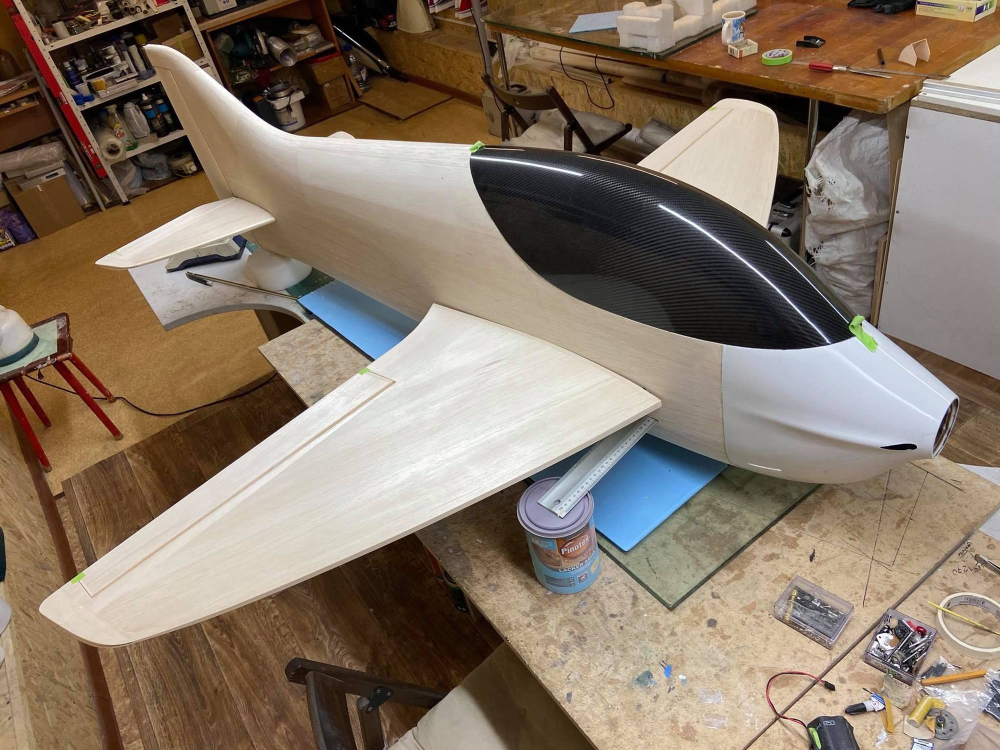

Andrey's Vortex is nearing completion. He had to wait for more than a month for some light balsa sheets, but now he has all he needs to finish it.
Unfortunately he can't post pictures here yet (needs more than 10 posts on RCU), so i'll post them for him:

Nice composite work men
