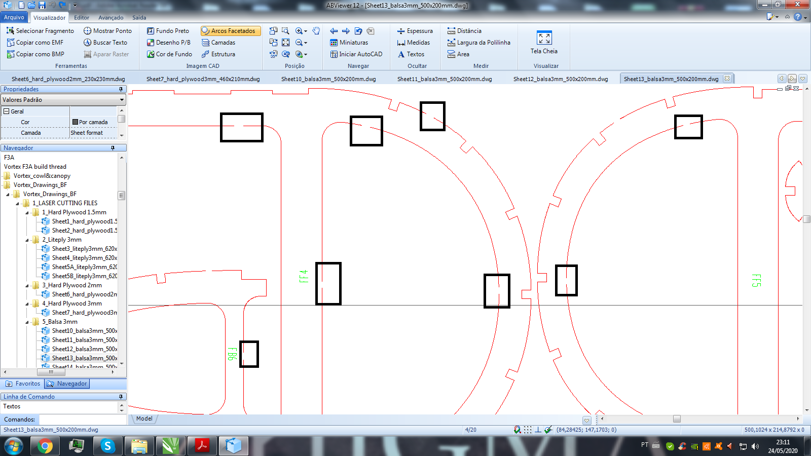

I have other question too why many locate plant have some bug when Laser will cutting he will stop and continue other locate see this.
Hi,
The purpose of these tabs is to keep the parts attached to the balsa sheet, otherwise it is easy to loose some parts. You can easily cut these tabs with a cutter and detach the parts from the sheet when you need them.
