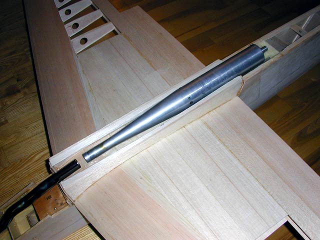

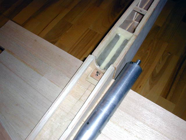

Thanks for the great tips guys. That actually sounds like something I can handle. I'll Give that a whirl once I've finished the underbelly. The dowel is a good Idea. I heard about a guy who blocked each end of the pipe and filled it with sand, but that was brass tubes I think. I'll try and heat it and bend carefully. Not much bending is required so I'll manage one way or the other [8D]
Mated the wing to the fuse today.

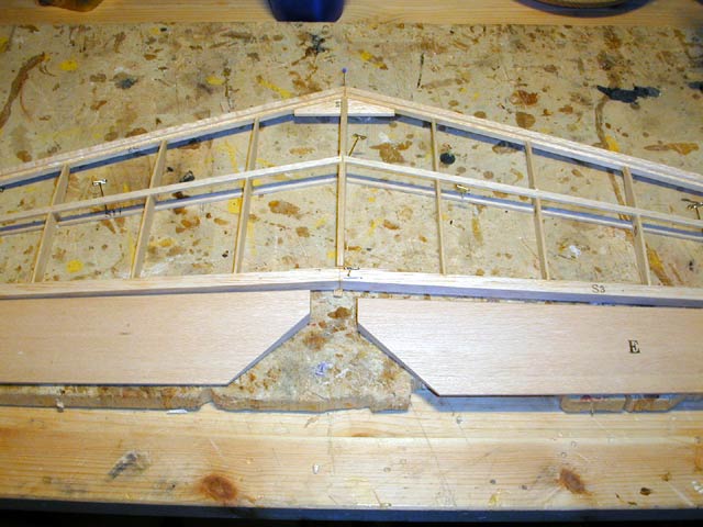

Got the header bent. It took a lot of heat but some industrial equipment got it right. Just heated until it was glowing red and bent it twice. Fits like it was tailored. The Webra pipe is so long I had to make a big recess in the rear fuse out of glass and resin.
The stab was tricky to get straight. It's tapered every way and no jigs or prop-ups are included so it's lined up with eyesight. Hope it stays straight when I sheet it.

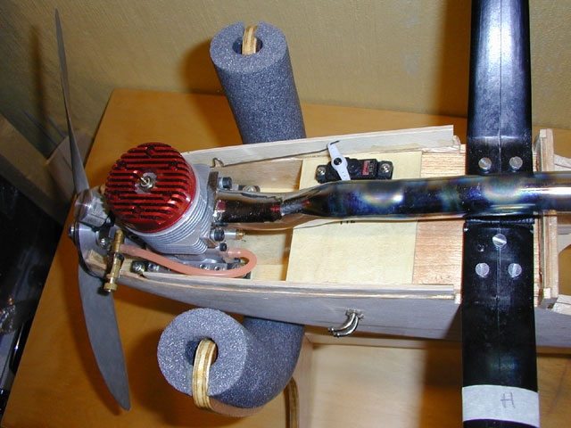

Still I've managed to get the throttle done (HS81) and mounted the engine. The belly pan encloses the engine very nicely. I'll make another hole for cylinder head cooling I think.
