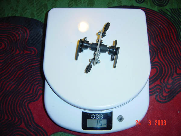

Hi,
Why you will not use MK also for Epsilon ? Only weight issue ? It is made from plastic material. can you tell us his weight ?

The long fuselage makes any weight back there undesirable. The bellcrank is a bit heavy, but it is way overpriced at $35 + shipping. Plus, either DEPS or a dowel with 2 control rods will allow for more clearance between the elevator control rods and the fuselage sides....which gives more room for the rudder rods.
#356
Yes, it is 15 grams, with an added pull-pull lever and two ball joints.
There are two versions of MK dual bell cranks: normal and wide. The above is normal and wide version is probably 1 gram heavier.
Actually the weight is quite significant, especially located so far in the back.

I think the time has come to de winterise the Epsilon and have some fun .... if the weather holds I will fly it tonight.
Forgot to add I put in the extra piece of ply below the tank to replace some of the strength I had removed from the tank cut out ... 2 benifits holds the tank in nicely as well!
Tank was a tetra 400cc and I cut the ply centre away rearwards of the lightening holes so the back of the tank was just in front of the rudder / elevator servo. Tight fit but worth it!
Couple of pics worth a 1000 words here you go .... oh and the engine pic you asked for!
#374
ORIGINAL: 3dUkidding!
Did you have to sand the bottom of the front turtle deck to lower it a bit so it matched the fire wall?
