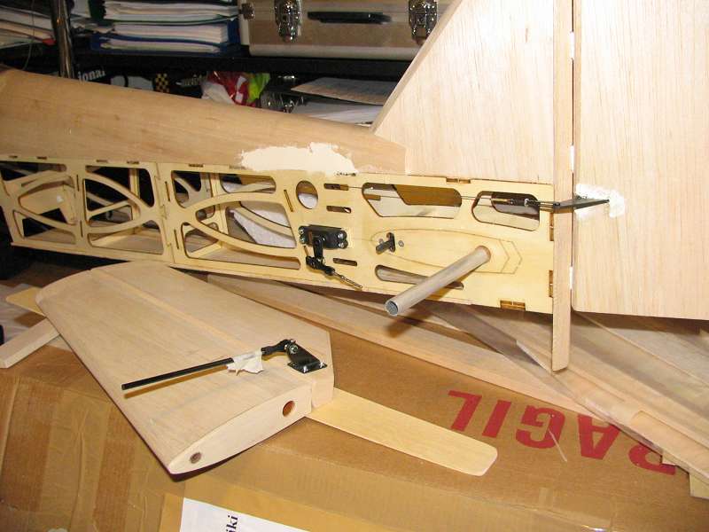

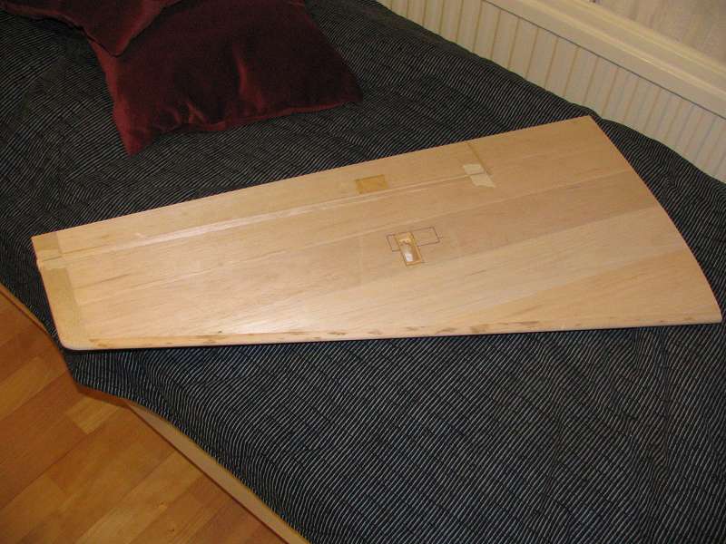

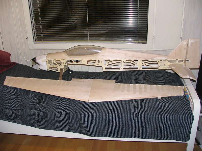

I made some modifications on my Epsilon: Plug-in elevator, shorter ailerons, moved landing gear 15mm up and going to use Bolly F3A Large gear, going to use Greve pipe on YS110, made new wingtips.
here is two photos what I've come up so far...

Old 03-06-2005 | 10:03 AM
  #338
Posts: 140
From: Netanya, ISRAEL
Default RE: New CA models Epsilon build (easy as pie)

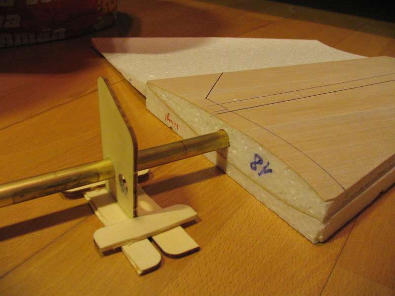

Nice job on elevator. can you explain how you make holes for sleave tubes in elev. halves ?
Thank,
Dino
Old 03-06-2005 | 10:33 AM
  #339
Timbba's Avatar
Posts: 122
From: Raahe, FINLAND
I sharpened the end of a brass tube and carefully pushed it into styrofoam, making sure it is parallel to hingeline.

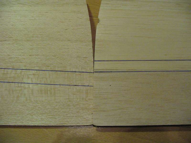

Btw. has anyone else had this kind of problems with your kits?... Those lines are the ones that are already printed on the wings... Luckily I noticed this before cutting off the ailerons...

Timbba, now I am worried.
Will check when I get home.

I got the ARC and had all kinds of problems with it. The wing wouldn't fit on the fuse. Way off. With the dowels in the holes and the front of the wing on the saddle, the back of the wing was almost 1/2 inch above the saddle. The belly pan was not centered on the wing, but off to the side about 5mm. The hard points in the ailerons were not in the same place. One was closer to the hinge line than the other. I wasn't very satisfied with the quality. If it flies well, all will be forgiven. If not...

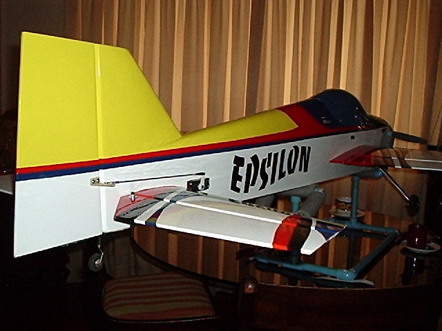

Mattyd, I will be looking at ways of hanging the servos out back, as I will be looking for a rearward CoG. As yet I have not built a tail heavy plane, all have been nose heavy.
__________________________________________________ __________________________________________________ __________________________________________________ ________
SPRINK
LOOK THES REAR SERVO
