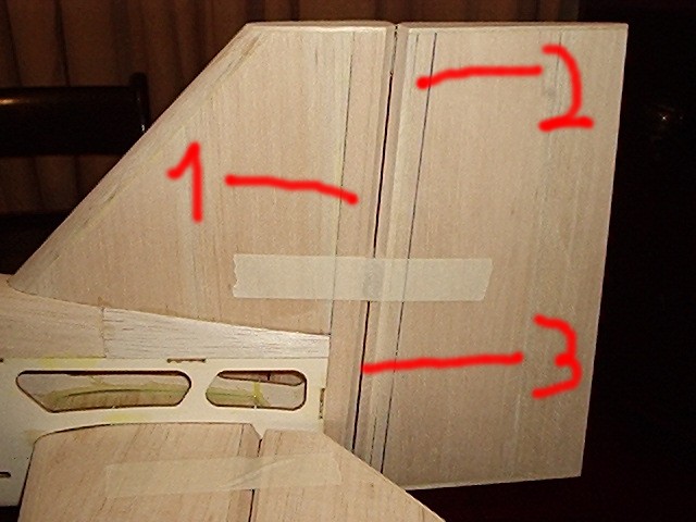

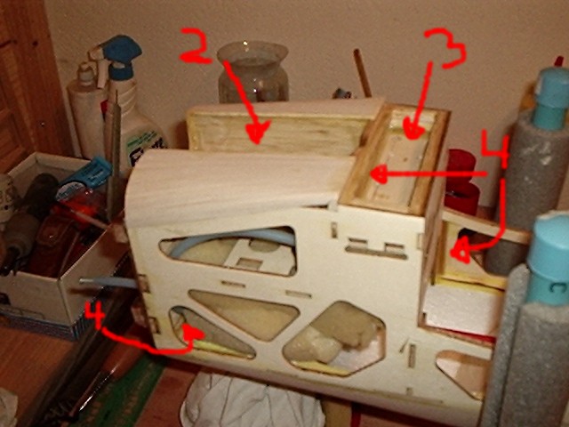

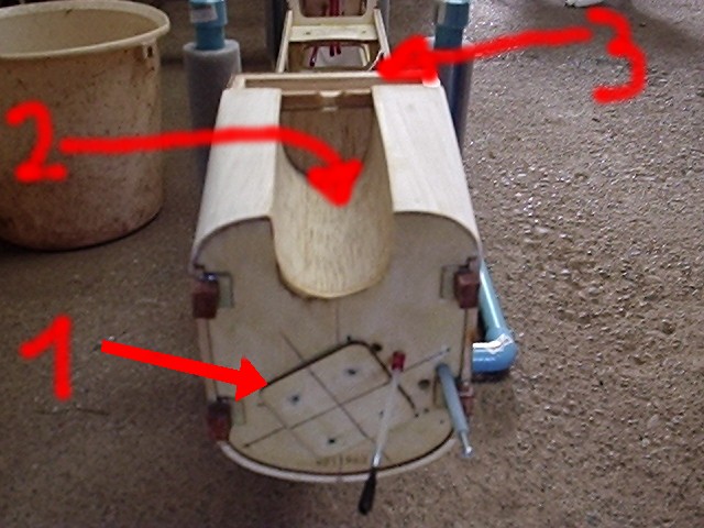

Hy guys,
First, my english is very very bad........
I try to show my modifications on my Epsilon.
I add plywood for the support of engine, the fire wall is so thick. (1)
The place of the exhaust of the engine i do my way and it can do easy and fast (2)
Reforze all the corners with 1/16 stick in the interior next to the fuel tank (4)
To have access to screws of gear, i do a cover with 4 little screws (3)
In the ruder i do only 1 cut on the front line (1)
then i put 1 cmt. (- 1/2") of balsa because when i put hinge i touch the plywood of the fuselage.
I don´t remove the rear piece of ruder (2)
Then i put the preformed for hinges(3)
Sergio
