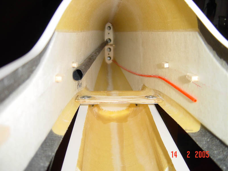

Does anyone know how to secure the stab servo leads to the side of the fuse as is pictured in the Impact instruction manual? They don't say anything about it and I can't tell how they are secured.
KeithB
KeithB
#339
Posts: 242
From: Henne, DENMARK
Hi Keith,
This is how I have done it in my ZN Synergy, should work fine in the Impact as well. The black paper tube is from Gator RC. I glued it in with a small bead of Polyurethane glue, which foams up when curing. Weighs very little.
[link=http://www.gatorrc.com/gator/fl%20servo%20tube.htm]http://www.gatorrc.com/gator/fl%20servo%20tube.htm[/link]

I haven't looked at the latest instruction manual to see what the current modifications are -- it sounds like a crutch from tail to TE of wing.
From the analysis of failures it is clear that C-ARF are not fans of anyone leaving out the cross fuselage brace/wing anti-rotation pin. There is certainly suspicion being thrown on models where that cross brace has been left out and wing adjusters put in instead -- this is regarded as a departure from recommended practice and not a good thing to do!!
I cannot tell from Kelvin's post above whether the mods effectively mean the cross brace has been left out -- but sounds like it may.
David
David

Yes, I left out the anti-rotation tube because they sent me the wrong part. It was a solid rod and weighed .7 ounce. Jason Shulman uses the short 12mm tubes as anti-rotation pins in his Impact. I was going to build it stock but I wasn't going to wait another month or more to get the anti-rotation tube from C-ARF. When they ship parts from Thailand they must ship them on the slowest boats from China. When I waited for the replacement hardware they sent me an email on December 28 and I didn't receive the parts until February 6. Not the fastest customer service.

ORIGINAL: David Gibbs
If we put the receiver/switch/battery tray in such that it replaces the brace, it would solve that "problem". I'd much prefer to have the trimmability of adjusters than not, but that's just my preference.
#349
Yep -- Thats close to what I did. Adjusters, but with the servo/receiver tray acting as the brace -- and I used the DEPs system so had both elevator and rudder servos on the tray. And I will do it again on the second one I am building!
On the first one I just put in adjusters at the back of the wing. On the second I will put on front and rear adjusters as the front of the wing was a little freer that I would have liked.
David

#350
David,
When you put in the tray to replace the cross brace did you raise it up in the fuz to come close to the orginal cross brace position or did you leave it down on the balsa rails already fixed in the fuz?
I am powering my Impact with a Hacker setup and although I am fitting the rear bulkheads I am not keen to install the horizontal crutch as it does restrict access to the rudder pull pull setup. Does anyone have an opinion if the reduction in vibration etc of the electric setup reduces the likelyhood of a failure without the crutch?
Also can anyone running the Hacker setup give details of their air cooling outlets? The manual gives a suggested outlet size on the fuz bottom but suggests it could be bigger for the Hacker setup.
