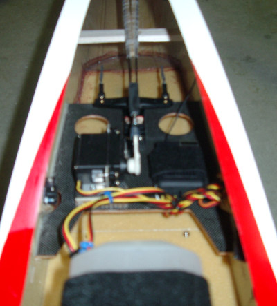

Malcolm,
I lifted the tray and put rudder and elevator servos on it -- so it was between the wings. I make sure there is a brace between the back of wings on all aerobatic models in case I ever accidentally touch a wing tip (translates load through to other wing rather than breaking fuz).
While I am no expert, I sense the failures are rudder flutter related and more of an airspeed/mounting issue than a vibration issue.

My servo tray is positioned as per Mr.Gibbs photo above.

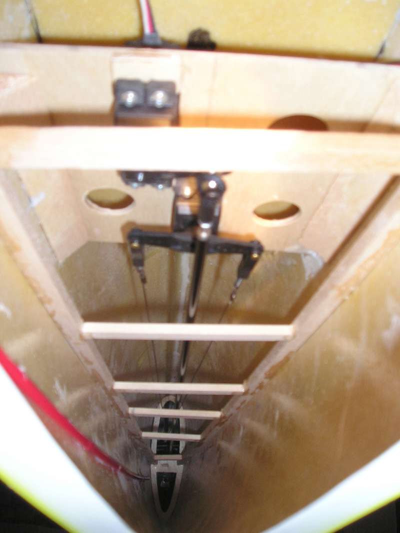

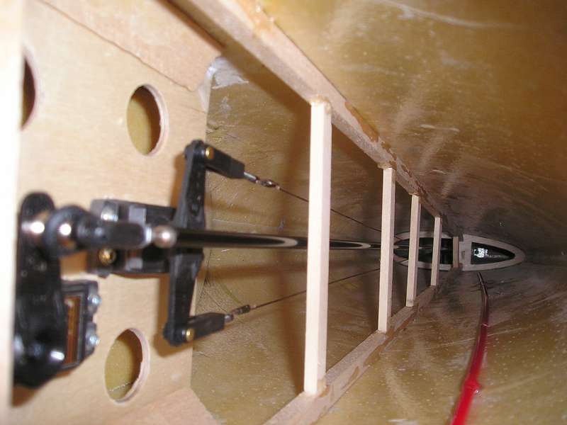

Ok, Finally made my ladder in the fuse tonight anfd it was a pain, but I got it done. Took me about a half hour to do it, and I could not beleive, how stiff it made the fuse! I used a 1/4 balsa pieces to run on the sides and then used left over to make the ladder.

Very nice. How were you able to apply the glue all the way to the back?
