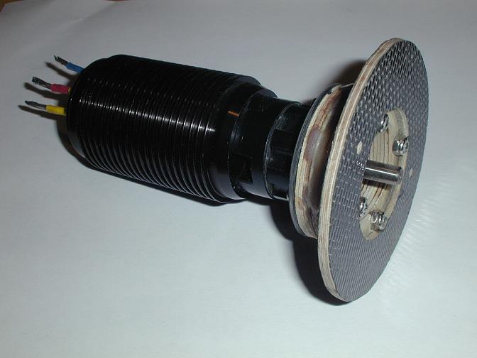

One other thing,
Make sure you have the right prop adapter before you make your motor mount, so you can account for the right clearance.
I tried a few different prop adapters, and I prefer the Graupner 6mm motor shaft with a 10mm prop shaft. I believe Steve also carries these.
This prop adapter comes with a threaded hole in the middle of the shaft that makes adding a spinner easy. I'm using the Tru Turn 3 3/8" (3 1/2" would be better) FAI spinner with a lightened back plate.
Pedro.

#283
Joined: Dec 2002
Posts: 189
From: Gothenburg, SWEDEN
ORIGINAL: pbrantuas
Here's one with the motor mounted.
Pedro.
Pedro.
Best regards,
Erik
