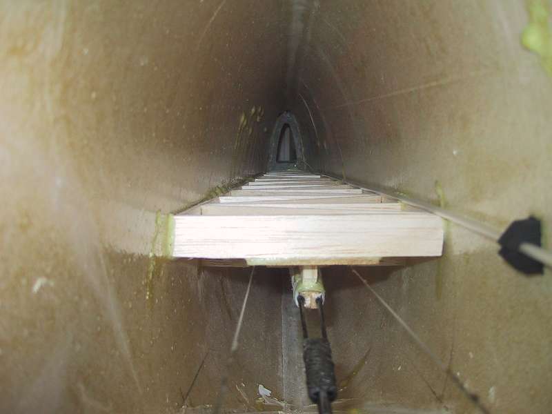

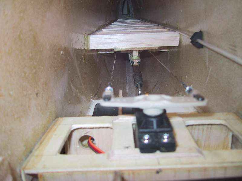

One more of the ladder assem. with a little better view, also seeing how I finally can post pics I thought I would show off my ZNline Majestic with flame job. The bottom of the wing and stab are 4 inch checker pattern in neon orange and black on one side and neon green and black on the other, shows up really good until you fly straight and level then the white and black blend in, oh well sure looks good sitting there or hovering.

Yes, that is correct Derek. The original tail post was removed the hard way {thats kinda of a joke but a long story}, but it did make it easy to install the new one. On the rudder I cut at the end of the radi of the leading edge and the former that the original hinges went into was routed out with a dremmel and new balsa leading edge glued in and a bevel sanded on, I just coverd with white monocoat once mounted on plane. Here is a couple more of the Majestic.

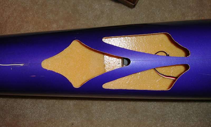

Brian, this is probably stating the obvious, but I'm doing it since you said your Impact was flight ready.
In the center photo above of your rudder servo, it appears to show the rudder horn screw is missing. Maybe it's just the angle of the shot.
Just thought I'd mention it, in case you hadn't noticed it already. If I'm mistaken, please disregard my butt-in.
Better safe than sorry, I always say.

Thanks Rick, it is there, those Dubro HD horns are kinda deep and the angle of the shot hides it. Thank you for speaking up, it's actually somthing I would do, to much building late at night has caused me problems before and this plane has been cursed from the start. Some haunt you forever and others fall right together.

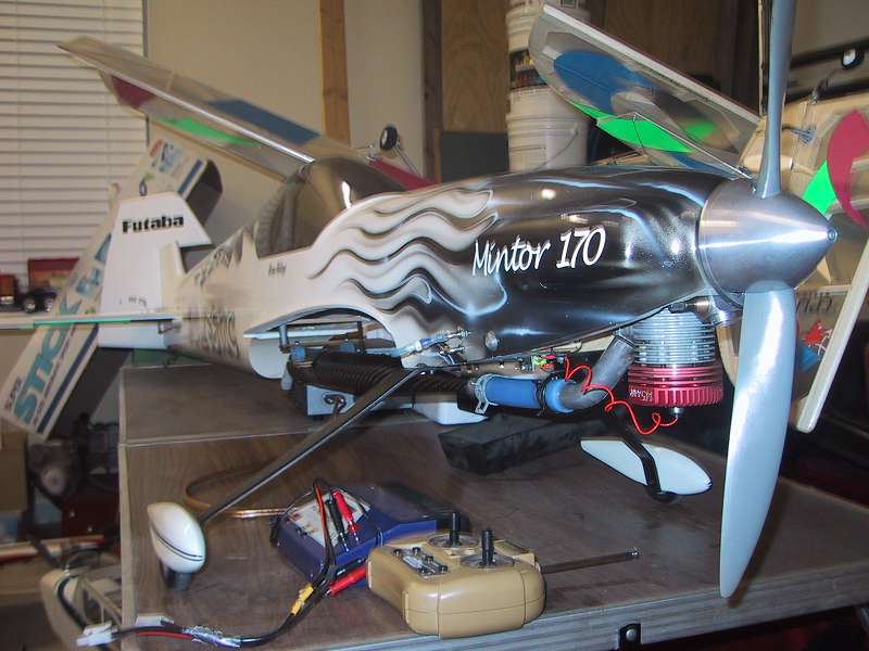

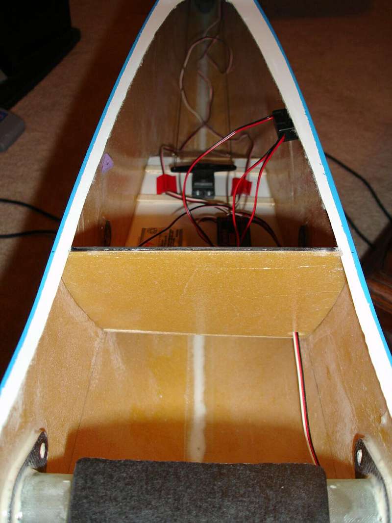

Anybody got new pictures or advice of their electric setup installation. I have decided to go with a Hacker setup, I estimate I will just be about 15-20 grams under the weight limit of 5kg.
I would be interested to see more pictures of engine battery and esc installation. (I have seen all the old pics on RCU)
In Particular the cooling, I am unsure if i can fly without a pipe tunnel and leave air run through the model.
(Saw on another post that someone did this and their canopy blew off.) Yet picture of manfred greves Impact show no tunnel and the fuz is totally open.
Do I have to close off the radio section with my 10s3p's reveicer rudder servo ect.. are, or can I leave it open?
Any help would be appreciated.

Here are the insides of mine from the Nats. I will do the same thing on my new one, but I will make it out of 1/8" balsa instead to keep it a bit lighter. I will still reinforce the rudder servo mount to make sure it does not flex in the balsa floor. Only other I will do different is instead of making an air dam in the canopy, I will take some BVM Polyply (thin fiberglass sheet) and put it around the inside base of the canopy to seal it off.

Thanks for that information Jason, it helps alot the pictures are great. I now know exactly what to do with my setup.

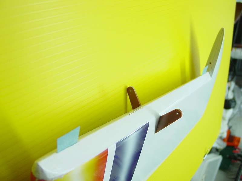

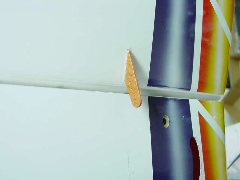

The more I looked at this rudder hinge set-up, the more urge was to change it. One hot-knife later and some balsa wood and it was done. I had to sand the elevator cut out angles to clear the rudder swing near the center, (but you can't really see it).
Eric.
Eric.
