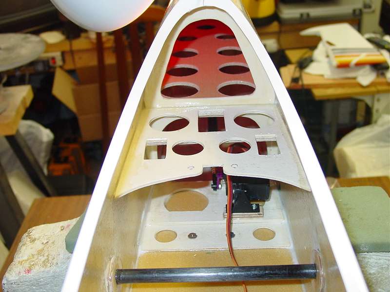

Between the rudder change and this "ladder" I can only hope we have it licked!

This final assembly is taking a bit longer than I thought it would but the good news is that the second one will be much faster because I am taking templates or making copies for the tricky bits.

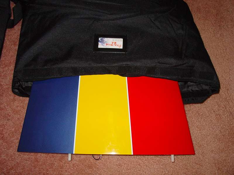

I also picked up some really good wing bags for the Impact wings from [email protected] They are nicely padded and take the 1" wing tube in the wing-tube-pouch. My other bags either did not have a pouch or the tube was too tight a fit. Adrian is a keen pattern flyer and very helpful if you need anything. I particularly liked the slot for a business type card so that you could identify the panels for each plane exernally.

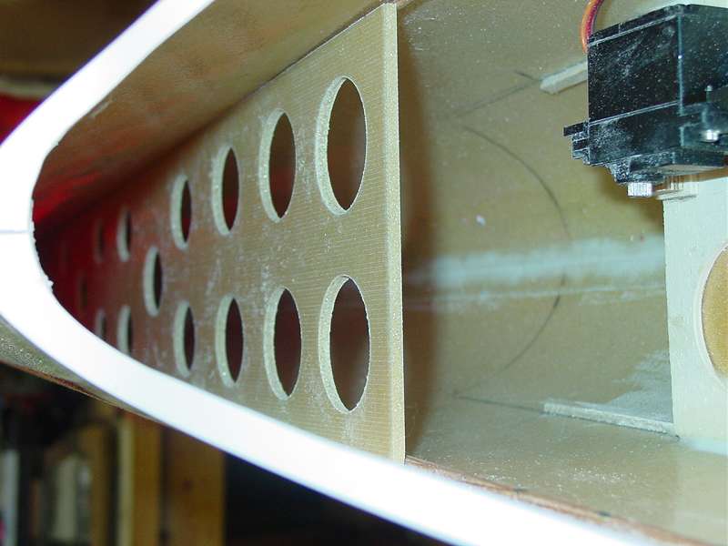

I would add that a former is needed just behind the canopy opening. I think the MTK had already posted this info.
My current thinking is that;
a) The rudder hinging needs to right on. If the hinge-pins show any form of side-flexing it could flutter. I have already swtiched to a "flat"
stern post, as shown above.
b) The "ladder" is needed to avoid compression and expansion of the rear fuselage sides. (At least behind the rear wing anti-rotation-pin-cross-tube up to the stab)
c) The extra former is needed to prevent fuselage twisting at the rear of the canopy.
If I pause for a moment of refelction, I would really ike to thank all of the conributors who have rasied all of these issues and the suggested fixes. This is the magic of RCU, (especially when you can post pictures). For those who have goine before we all benefit.
Thanks again matey's

Does Adrian have a website that you know of where we can see his wingbags? Or can you take a picture for me?
Thanks!

I was unable to reply to this question earlier because I had not glued it all in place at the time. Even when the materials were dry-fitted you could feel the change in the stiffness.
I am please to report that the result gives an amazing difference. The stiffness is very acceptable and even enjoyable :-).
Eric.

[link=http://www.chingbergh.com/products.html]http://www.chingbergh.com/products.html[/link] Try this link.
Chad,
I took some pic's, but it's not an very exciting subject. Plus mine are still a little bit crumpled from shipping in a small box. I liked the velcro ends, the protection of the padding and the size of the wing tube pouch.
Regards,
Eric.
