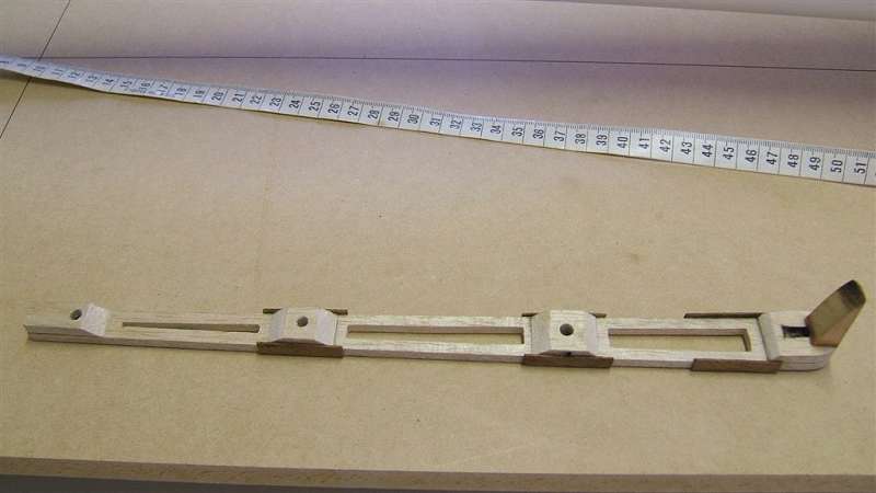

Hi Jim,
I concur with Matt. As far as I am concerned this is the only way of assembling a model with guaranteed results. You may fluke the occasional build but nothing beats good preparation and having the right tools for the job.
I have included a couple of other photos which show my wing supports during the gluing phase, this keeps everything in place without risk of movement during the night while epoxy dries. I have used some of those adhesive rubber feet attached to the 1/4in nut to rest the wing on. Infinite adjustment by screwing the nut along the threaded rod.
When you have everything square and centre lines you can rely on I use the trusty dressmaker measuring tape to confirm everything. put a screw on the centre line and pull as much as you like without pulling the fuse with you.
Worth removing as much material from the tail post as you can without compromising strength. Weight in the tail of these birds is something you don't want.
I just realised they never gave me the outer tube for the tailplane carbon spar. I guess I will have to wait until next week to get one. I guess there is plenty of other work to do.

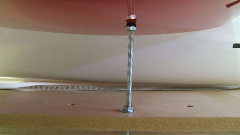

Hi Guys - AWESOME thread. I've dutifully read ALL the posts. I am now preparing to hang the wings and stab. Instructions call for 2-2.5 degrees of down thrust. However, this is not built into the plane as far as I can tell. 3 of 4 of the horizontal stab locations match when measuring vertically from my building surface with the tail blocked up 33.5 mm. with only 1 being a about 2 mm high. However, the down thrust in this setup is only 1.5 degrees. Also, the right side wing tube hole and aft pin are about 3 mm lower than the left side.
Essentially, if I block up the tail 33.5 mm as suggested in this thread, 1 horizontal stab point is off (I can fix that), however, the left side of the wing locations are low 3 mm, and down-thrust is only 1.5 degrees. If I raise the aft end of the fuse to get 2-2.5 degrees of downthrust, then the wing and stab locations are off is X and Y directions?
What is the best thing to do? Block up the tail to get the down thrust (2.5 degrees)? Or, block up the tail where at least 3 out of 4 of the stab locations match, adjust the 4th to match the three, and let this be the "zero-zero" reference, then add down thrust to the motor, and reference the wing incidence from this position????

Hi Jim,
If you go to pages 8 & 10 of this thread, you will see how both David Gibbs and myself have set our Impacts up. Essentially the set-up's are the same and really suit the model!

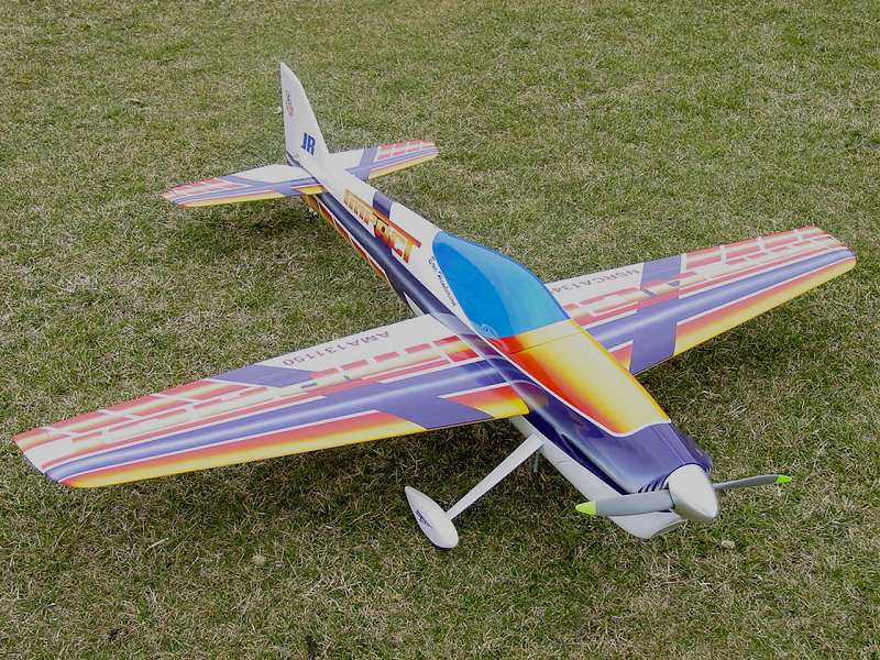

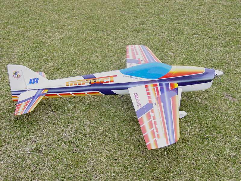

Today was a busy day of testing in southern NJ.
For anyone who has not flown their IMPACT yet you need not have any trepidations. I was delighted from the moment it left the ground. The only hard job was setting up the OS mix carb on a 42F March day.
The only flying-mix that I could see that would be needed was a tiny bit of proverse roll correction, and that only showed on a field long KE test. (probably about 2%)
Thanks to a first class incidence-setting job by George Asteris the plane flew great from the outset. Some planes just feel right as they leave the ground. This is one of them. Thanks to all of the throw-setting advice in the thread there was no real need to change anything. Spins were rudder and elevator only, The 2 turn reverse was as good as the pilot's timing.
It has the signature Pterodactyl "screech!" when you snap. Add your own "whoops"....

Hi Guys,
Sorry for taking a while to respond.
Brian:
I first position the fin so that it is perpendicular to my flat building surface. I then adjust the height of my wing supports so that the wing is parallel with the board. I found that when I positioned the wing to the fuselage that the gap was tiny so only a small amount of sanding was required. Distance between building board and trailing edge was perfect when I did it this way. I think it is important you have a setup which keeps things exactly in this position while glue is drying.
Eric:
The horns are the original brown units supplied. I simply roughed them up with 80 grit and then mixed some epoxy and put some 5oz carbon cloth on a sheet of glass treated with release agent. This was left overnight while compressed between another sheet of glass. In the morning I simply cleaned up the edges and presto. I would have used 3-4 oz cloth if I had some on hand.
Jim:
I positioned the fuse that the distance between the front underside of the engine cowl flange and a distance exactly 37mm below the centre line of the tail plane wing tube as being my datum line. I set my jig to hold the fuse in this position. I also had to adjust the front fuse support on the jig to tilt the fuse slightly to get the fin vertical. The tail plane was fairly close to 0-0 at this point but I found the wing anti rotation pins to be way out. I ignored their markings and made my own. I would have had .3degree negative incidence on the wing if I had used their settings.

#489
Hi Jim,
During testing, I noticed that the underside was hard to see. I had used a white band about 10" wide but it did not help with the visibility. Today I sprayed a band of flame-red about 8" wide one each wing that should provide a better contrast with the yellow and more recent white band. Flame-red is pretty close to the pre-painted version colors.
I noticed that the wing roots have sharp edges that cut into the fuselage sides with engine vibration. I have since added some 1/4" balsa spacers at the front of the root rib to provide more of a flat surface area to press against the fuselage side. The wood can be sanded flush. In a similar fashion the wing bolt has been supported to avoid the fuselage sides bowing out as the "wing" nut is tightened.
Regards,
