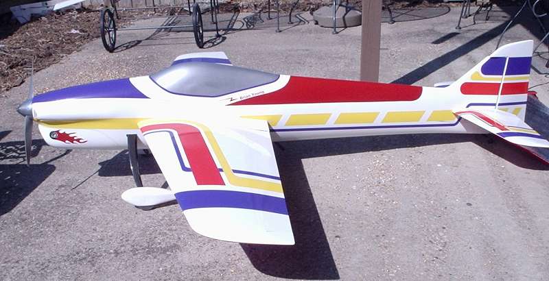

#443
My Feedback: (16)
Posts: 574
From: tulsa,
OK
Vinyl the Sign shop had. It has about the same sheen as the finish on the plane. Designed the scheme in CAD and exported to a EP format that the signcutter used.
This was my first try, got some bubbles here and there. But overall looks better than any paint I would put on.
#444
Brian, the trick to sticky vinyl application is liberal use of soapy water. Spray it onto the surface and then place the vinyl on it. I get the surface dripping wet with the solution. Soapy water lubricates the adhesive and allows some movement to its final spot. Then you can work the water and bubbles out with a cotton cloth, working from the middle, out.
MattK
MattK

I weighed a stab half before and after, each stab half was about 0.2 ounce increase. I got lazy and didnt keep track of the rest.
The plane weight is 10#9oz w/ vinyl. I added a crutch as you see, using a 5 cell nimh 2250 battery, 9311sa aileron, 8411 rudder, 3421sa stabs, YS 1.6, ES pipe. NB soft mount.

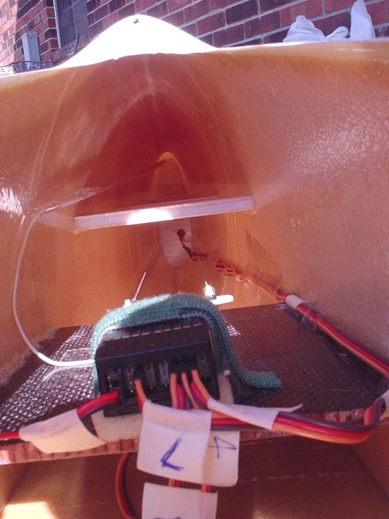

I've just repaired the fuselage on my Impact and have reached the point where I need to re-fit the rudder. Has anyone experimented with static balancing on the rudder? Ive checked mine and it will require 80g in the forward mass balancer to balance the rudder on the hinge line. it has been explained to me that balancing the rudder will eliminate the further possibility of rudder flutter. I'm reluctant to add that much weight to the fuselage rear end but equally don't relish the thought of building a balsa replacement, any ideas?
All replies appreciated!
