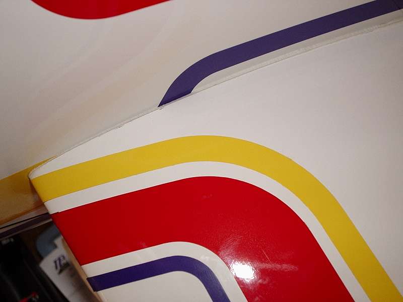

It is the gap on the bottom aileron hinge lines. The gap opens up more during a snap. I have it for years on my racing gliders. No ill effects, just a lot of comments.

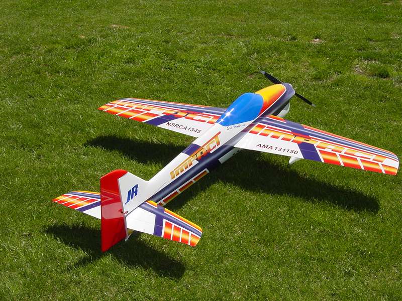

Well here it is, photo taken last Sunday but the wind was blowing like crazy!
The Explorer belongs to my youngest son Ryan (13). Ryan will be using this for the 2005 season in Standard class F3a, whilst I will be using the Impact in Senior class (waiting for the new Masters schedule in 2006 before I move up [8D] ). i'm really happy with the fixes i've made to the fuselage and can't wait for the calmer weather to arrive so that I can finally start to practice!

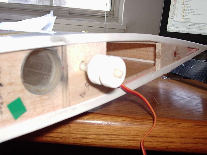

I spent most of yesterday modifying my IMPACT to use 4 bolts to hold on the wings. The single bolt near the wing tube was allowing too much movement and letting the wing move and rub on the fuselage. I fitted the bolts like a pair of wing adjusters and took advantage of the moment to dial in some incidence to remove the current need for left aileron trims. The rear anti-rotation CF tube was removed as it was no longer needed,
I am using a mix-carb and had positioned the two servos for throttle and mixture control back at the rudder servo tray. The OS 1.60 was not as heavy as I thought it might be so these servos were moved to a location above the UC brace formers. The removal of the materials cancelled out the weight of the addition of the extra two bolts and ply plates.
After a dumb-half-hour-of-engine-not-starting I figured out that the mixture control servo was now using the other side of the servo arm and needed to be reversed!
With the engine running a tad rich the test flight was initiated. It went very well indeed. The reset aileron-trim was right on. I had raised the TE of the left wing a 3/32" and lowered the TE of the right wing by the same amount. The up and down lines were still straight with no rolling. The horizontal roll was funky and the nose raised itself when I applied aileron. A field session with two "Magic gadgets" and we had corrected uneven ailerons and poorly implemented negative differental. The instructions used mm's and I had used degrees. I finished up with 10 degrees up and 11 degrees down and no differential dialed in the radio aileron options.
It was all worth it. The new settings made it a lot more fun to fly. Straighter and much more axial. The wings had left no new marks on the fuselage sides and were very solid when used to handle the plane.
I would pronounce this plane now ready to fly in a competition, all we have to do now is wait for mid June in District-1 :-)

I think that all of the wings, going as far back as the Rev-pro have this twist in the wing. Mine was set dead-on using the roots. This left a 1/16" right roll twist at the right wing tip.
It is no big deal, however, because once adjusted I could find no ill effects. Often you get a slight roll in down lines etc. Many of my foam wings have a slight twist. None cause any flying issues. If I climbed to a great height and let it dive hands off it stays straight all of the way down. I did this in all four wind directions. It weather-vanes into the wind a little, but that is just fine by me.
The four bolts just made everything easier, including the positioning of the fuel tank. I now have a long list of what I want to do the second one. :-)
The Pinnacle is a super pattern plane. It is hard to compare because they both do everything very well. If you pay $900 for an IMPACT and build it with all of teh advice in this thread, you will be happy. If you pay $2800 for a PINNACLE and just install the equipment, you will be very happy. Yo need a lot of building skill to put together an IMPACT.
You need the same flying skill to fly either of them. They both make the patterns easier to fly, no kidding! I am much happier in the P-05 rolling maneuvers with these planes. However, if pushed I would say the PINNACLE is a close first.
Here is the wing bolt before, after and the new holes in the sides. You can see the wear on the fuselage sides before I used 4 bolts. None since.
