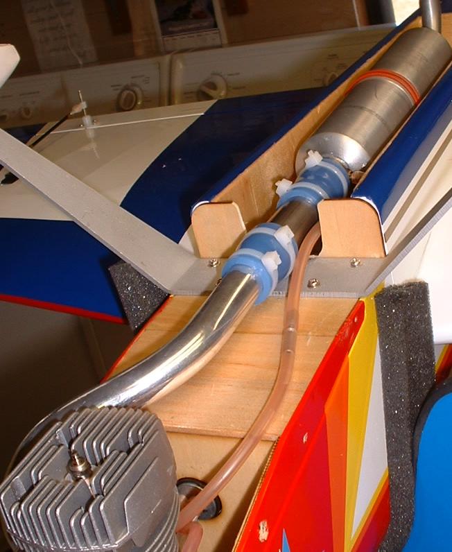

Header received. SLIGHTLY too "low", (close to LG), so...if you order a Mueller, get it 1 11/16, or even 3/4", but not MORE. It's pretty close in there fitting between the cowl and the LG crossplate. Course, if you put on 2 part CF gear, then that adds the clearance you'll need, and the 1 9/16" original measure will work just fine.
I tweaked mine just a skosh...pics show the evidence, but it will work just dandy!!!
I ran the thing, and YEEEE HAAA! OMG the power, the POWER....
Very sweet header... my coupler material worked just fine on it, too!
THank YOU Karl!!!!

This is the one I have. Don't know if it's optimal, but it is very quiet. Significant amount of the noise in this setup is intake and prop. Exhaust is FAR below....
[link=http://www.krumscheid-metallwaren.de/html/gb-extrem-alumininum-schalld.html]KS 76-4[/link]
I think Desert Aircraft and/or Cactus Aviation carries these in the US.

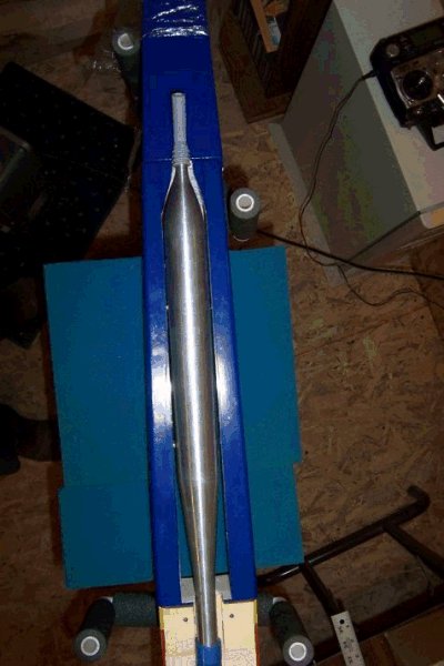

Got a start on the pipe tunnel for the TT 120RP. I had to do a little header warping to align back to center because of the built in right thrust.
[img][/img][img][/img]

Old 12-31-2004 | 09:28 PM
  #275
Bob Pastorello's Avatar
My Feedback: (198)
Posts: 6,707
From: El Reno, OK
Default RE: Excelleron 90
Looking good! You may want to widen the clearance on the sides of the header where it goes over the firewall. My ST thumps pretty hard at low idle, and there's a considerable amount of sideward movement.
Have you started on the wing bottom tunnel?
