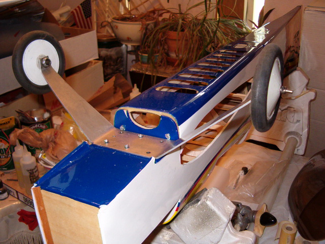

I installed my own LG and tires from my old pattern bird, as I attach using wood screws that will just pull out, not take the whole block if I dink it. The Sullivan tires look good and add (directional stability. ) The wide base also spreads the load over a greater area.

Stretching the load out is a good idea, less stress on the fuse. But, do you think you will have enough ground clearence for the prop?

Looks like I have 2" clearence using a 14" prop and if not I will install a 1/2" block or I do have a longer set of legs if necessary. I am not inpressed with the quality of this bird as every thing is just too lightly built for my type of flying to last 3 years like my old pattern bird. Covering is allready comming off, wrinkles in the covering, wimpy wing hold down bolts, not even plastic 1/4" like every one else uses. Ailerons were warped. I guess one shouldn't expect much for $175/$200 As light as this one is built I expect my 91FX will be pleanty to do the job. We will se how she flys Friday if I can finish getting her together.

Putting on your own gear is fine but please be very carefull and take note of where the wheels are in relation to the CG.
The Quest has swept back landing gear that puts the wheels in the right place. If you move the wheels forward the tail will tend to "bang" down hard on landing. This is not good for the airframe. Try lifting the tail about six inches and then letting it go. With the wheels in the right place it should be a soft bounce.
When the tail goes down too fast it is hard to keep the plane on the ground during any landing.
Try a seach with google using "Bolly landing gear". I use the FAI std swept landing gear. Each site has the dimensions that you need to know. I bought my last set from Dessert Aircraft at the WRAM show.

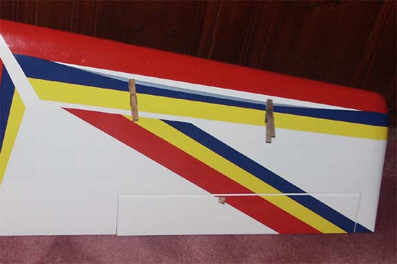

Did you ever hear a whining sound coming from your Quest in flight?
Mine started sounding like a high pitched single note airborne siren. The pitch remained the same regardless of air speed. My first thought was that the louvers in the thin belly pan material were singing.
The next time I took the plane out to fly the whine turned to a loud buzz and the plane went severely out of trim and nearly out of control and when I made an emergency landing the right wing suddenly dropped just before touch down. I managed to get the wing up but made a hard landing. The buzzing continued all the way down to landing speed.
As the photo below shows, the blue trim stripe that runs nearly the full length of the right wing was lifting and causing the noise and unstable flight. The clothes pins are only there to show how the trim is peeling back.
I posted this to point out that loose trim can lead to a really hairy flight.
While I and three other experienced fliers and technical "geniuses" stood there inspecting the plane and coming up with complicated theories for the buzzing, my wife nonchalantly pointed out that the stripe was lifting. I'll bet she thinks she's so smart. Or maybe she can just see better than we can.

ORIGINAL: Rocketman_
Wow, that is quite a turbulator strip you have going there. You are lucky you managed to get it down with any kind of control and not in many pieces. Good reminder to check your covering and trim pieces...

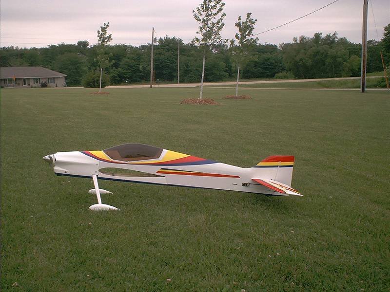

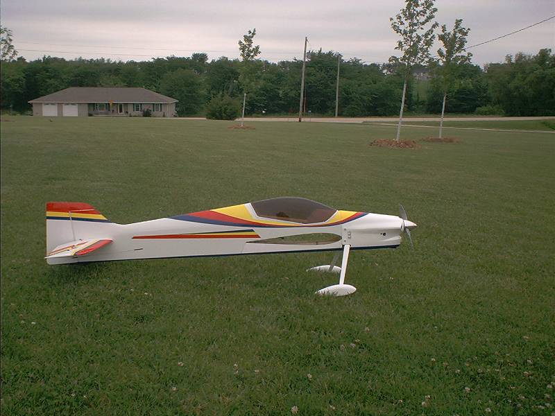

  #325
jlkonn's Avatar
Posts: 1,418
From: Back home in, OH
Default RE: NEW QUEST
Won't be long now!
I know...I know...
I'll need the wing!
It's finished...just too lazy to put it on for the pix.
JLK
