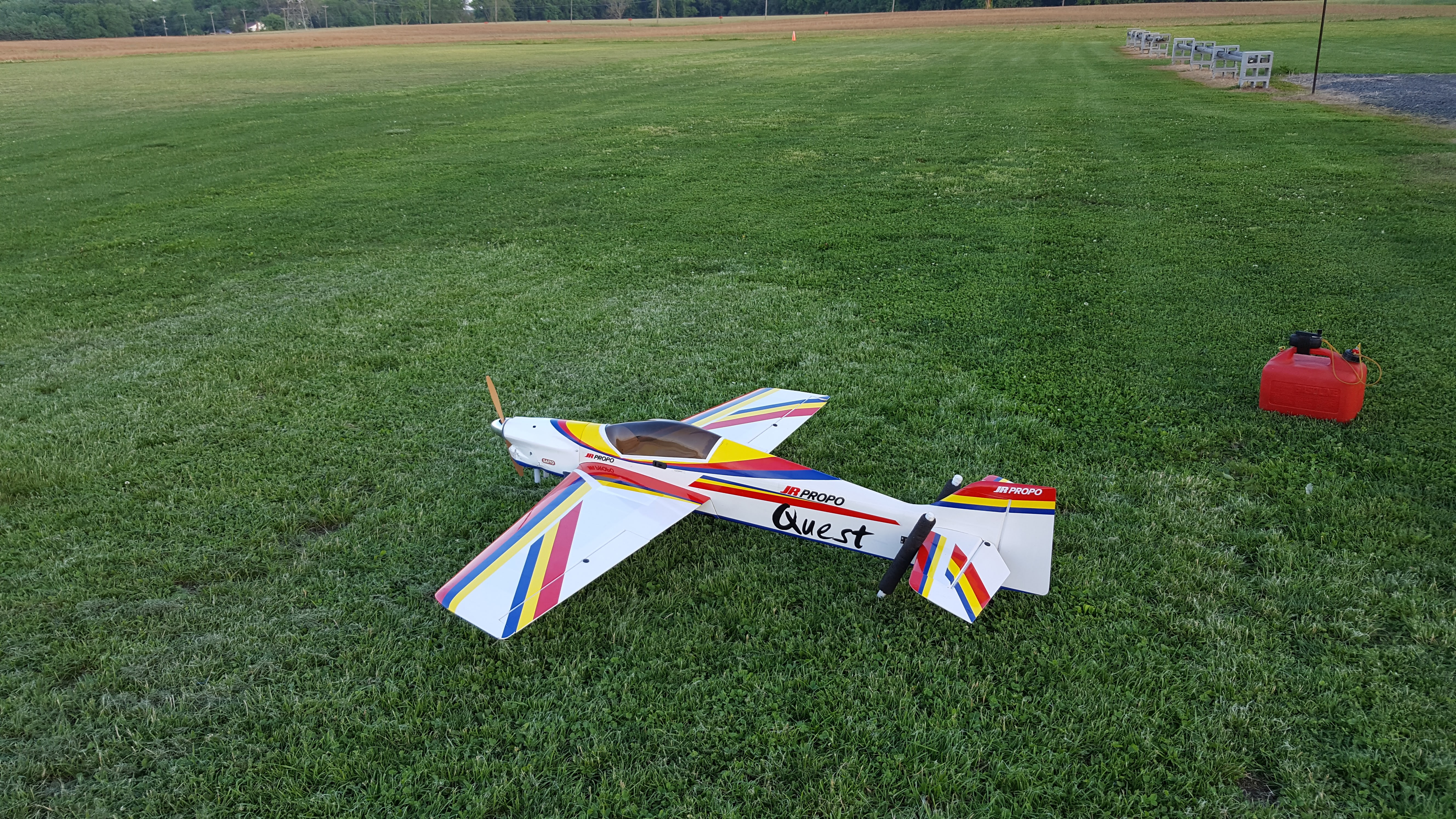

Old 06-03-2016 | 10:00 AM
  #369
Joined: Aug 2002
Posts: 105
From: Cherry Hill, NJ
This plane was ahead of its time. I crushed mine G1 version in summer of 2008 when I lost receiver battery. The damage wasn’t that bad, cowl took the brunt of it. It is finally back flying. I’ve replaced Saito 120 with DLE 20 RE. Engine fits perfectly into the cowl and it has all the power that this plane would ever need.
