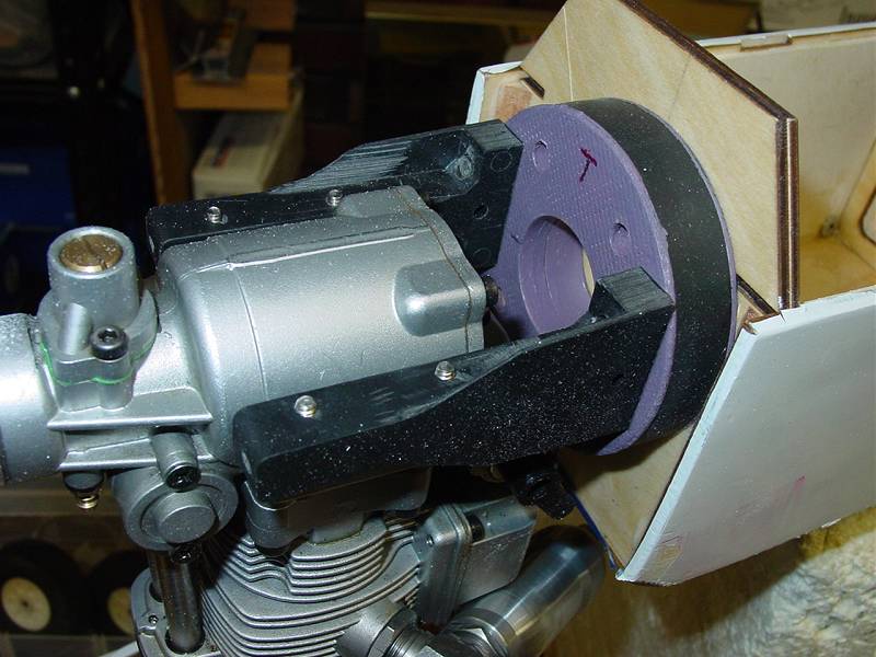

Eric or anyone,
Do you have a picture of the back of the firewall showing the position of the blindnuts relative to the slots for the tank compartment hatch when using a Hyde mount for a YS 1.10?
I have the mount location layed out but it looks a little high.
I wanted to double check before I drill any holes.
Thanks!
JLK

This is all that I have in my photo files. It shows the position of the hydemount and should help you see if yours is close.
This is the latest QUEST. (I will probably get another one when the new batch comes in so that I can take more current photos).
Regards,
Eric.

Eric,
Thanks!
Looks like I need to do some further laying out.
My mount appears higher up on the fuse than yours.
Thanks again!
JLK
