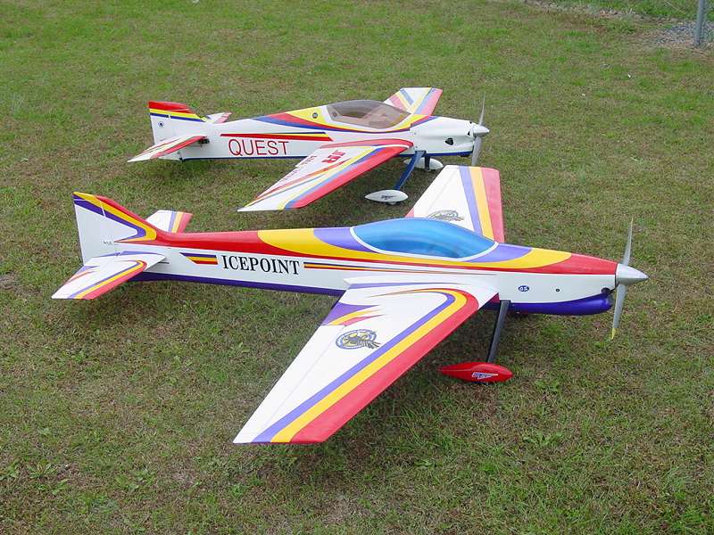

I had a chance to look at the new ULTRA-RC QUEST today. I had gone to pick up a new cowl for my old Quest, (mine had been modified for several different engines and was getting worse than Swiss cheese!).
The first news is that if you have a Quest already and you need spares, they have a contingent of cowls, canopies, U/C, and major parts etc. they even have the colors of the covering available.

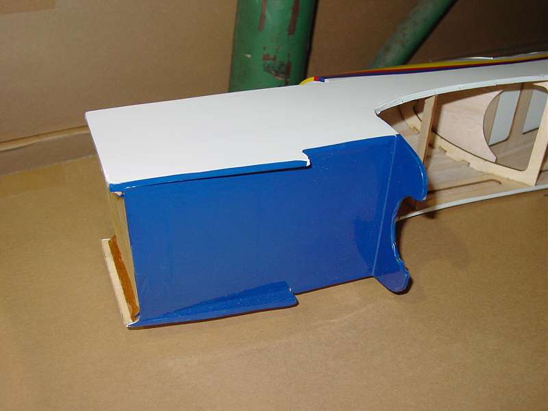

I have built two Quests and was eager to see what was different. This is what I found:-

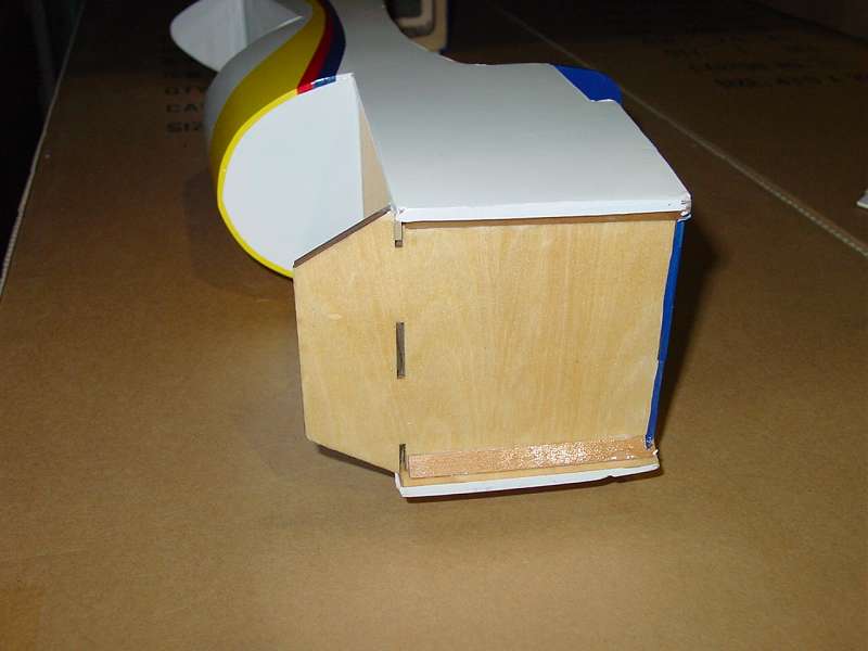

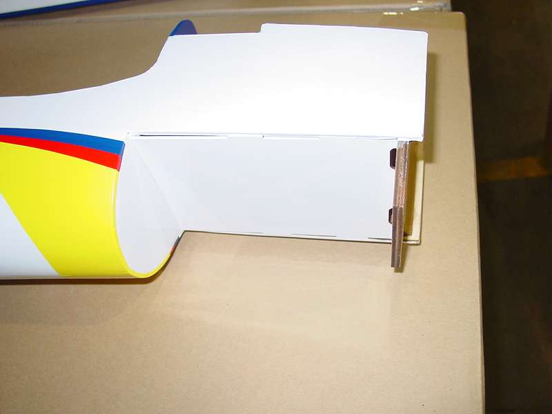

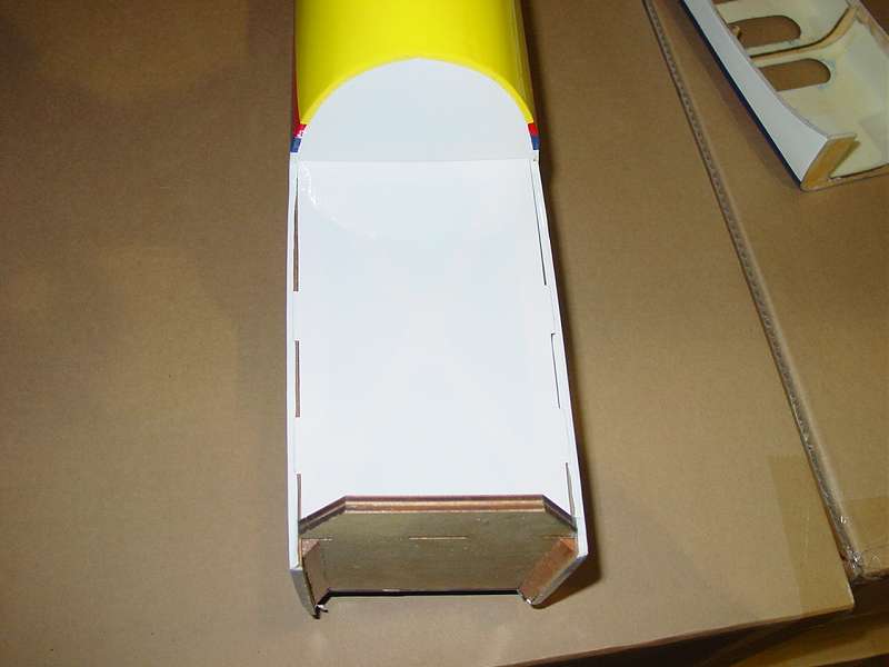

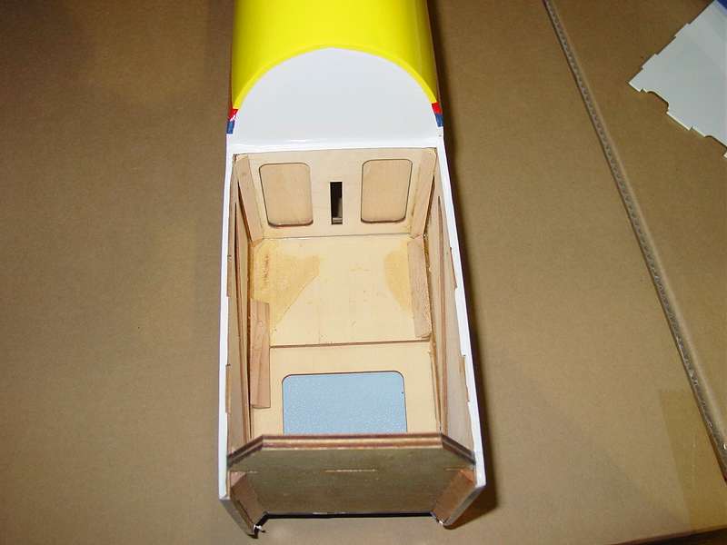

1. The fuselage has a new front end. Much more more conventional with a firewall and a bay/hatch for a fuel tank behind the engine id so desired
2. No more beam mounts. Regular mounts included

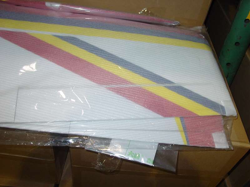

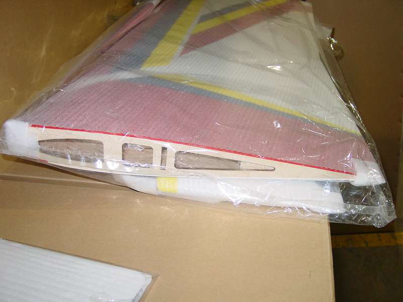

3. The parts are laser cut this time.
4. The Wing is shorter to improve the snaps. 68.5" vs 72".
5. The whole plane is lighter.
I did not see it but I think the stab has moved a tad for better down lines.
Lots of "red" ones available this time.
More pic's in next note

The old QUEST pictured below was very good on a YS .91 or a 1.10. This lighter version looks to be another good match for the YS 1.10 of 2-c .91's.

First, thanks for posting this information. When I built my Quest I referred to your earlier build thread a number of times.
Do you feel the fuel tank/hatch compartment is strong enough on the new one as shipped. I remember on the other one you added some reinforcement. Does the firewall on the new version have right thrust built in?

It looks OK. I would need to get my hands on one to be sure. It would not do any harm to slip in some lite-ply to be sure. I would always put an extra plate of some 1/8" marine-ply on an ARF where the blind nuts go for the UC, just for good measure. [It stops them pulling through the original ply]
It uses regular radial "T" type engine mounts. I always fit a Hydemount, so I would probably move the firewall back my customary 1". I saw (no pun intended) that the side-thrust etc. is already there. I also forgot that it comes with a CF elevator joiner.
Even with a bit of kit-tuning a $250 91-120 4-c plane is a good deal. A bunch of folks used their older 1.20 YS's. FZ's and AC's and even some YS 1.40's (I plead the fifth on the last one). You can still put the rudder servo @ teh back if you go heavy on the nose-noise-maker :-)

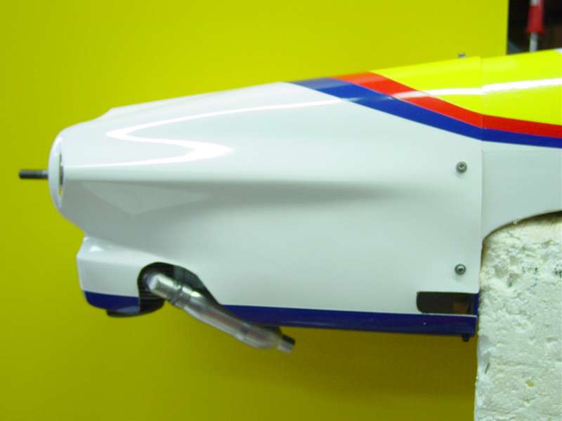

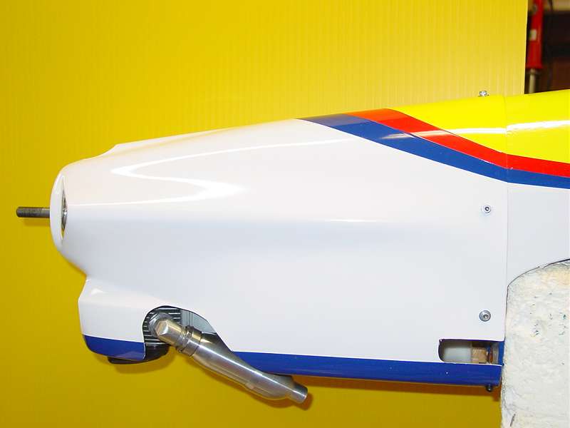

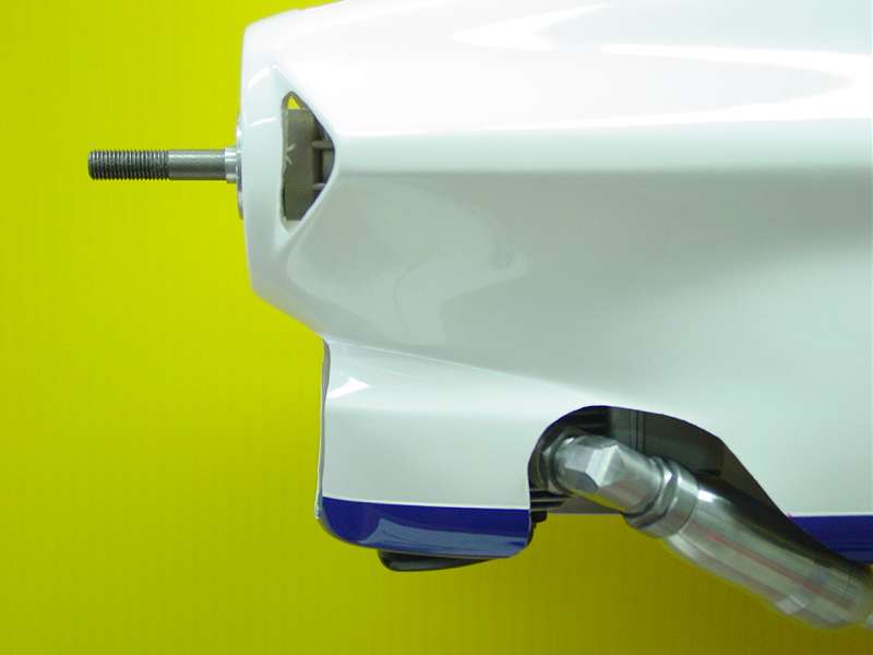

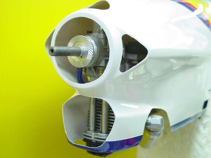

Are you using a Hyde mount? All you are really doing is lining up the cowl/engine relationship.
Either way, on the last two Quests that I built I fitted a firewall and had to figure out the mount position.
First, I taped the cowl in position so that it matched the "lines" of the side view and from above.
Then with a "cross-bar" and a set-square I located the center line by measuring back from the position of the nose ring.
Just lay a short steel ruler horizontally across the nose-ring opening.
Then put the square through the hole until it touches the firewall.
Adjust the square to just be short of that depth.
Place the square on the center of the x-bar. (Spinner opening center)
Now you can see where the horizontal center should be.
Do the same thing in the vertical plane and you can mark the height as well.
You can see through the cheek cowl holes or, as in my case, pre-cut the rear of the cowl for air ducting.
The square that I use is the woodworkers type that has a sliding ruler section in it.
If you are not sure just call me.
Eric.
P.S. A always use Bolly FAI gear. It's lighter and flexes better on landings :-)

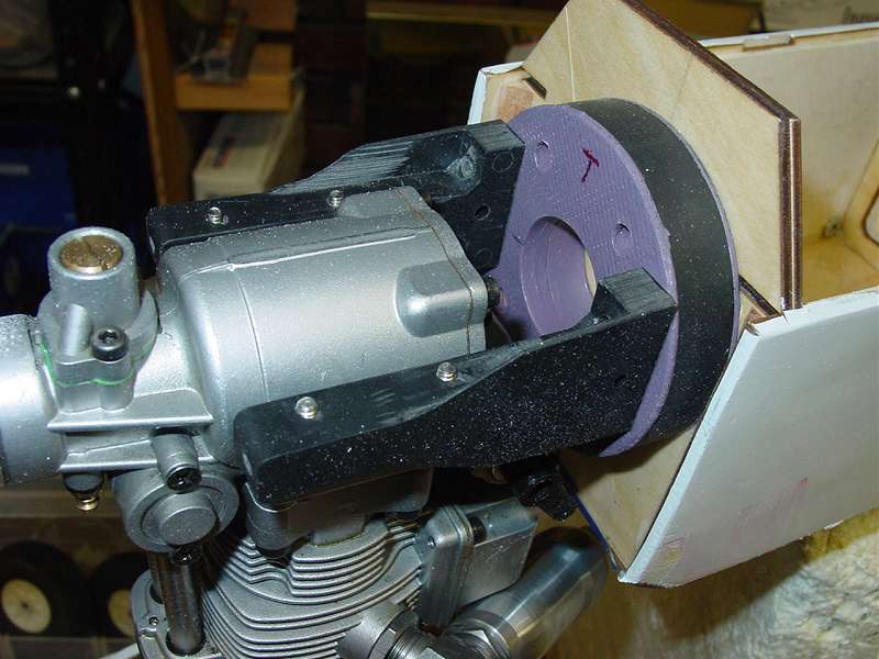

Joined: Sep 2003
Posts: 1,413
From: HENDERSON,
NV
Jon,
I just finished fitting a YS 110 "A-type" Hydemount to my Q2. I remembered to measure the position of the motor.
With the cowl all lined up to match the lines of the fuselage, the center came out as follows.
Vertical Center-line 2-1/16" from the right hand side.
Horizontal Center-line is 2-19/32" from the bottom.
Interestingly enough the Hydemount spaced the engine drive washer out perfectly at 5-3/8" from the fire wall.

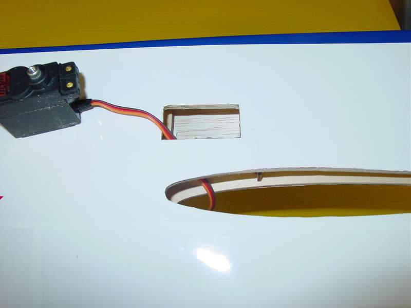

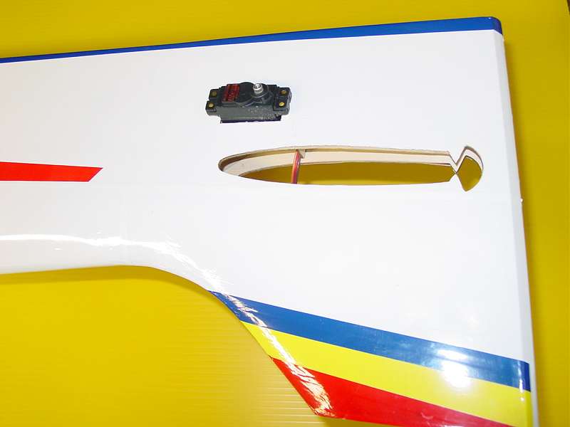

To answer other questions. It looks strong enough but I still added some lite-ply in eitehr side of the wing-dowel-former and I cut into the canopy floor to allow for a center mounted pressurized tank.
Regards,
Eric.
Regards,
Eric.

The Hyde distances and dimensions etc. fitted with no modifications. I went for the rudder servo in the back again. It just seems to save weight and allows the battery to be what is moved to suit my CG. needs.
I did put some lite-ply on the sides behind the firewall. Habit I guess ;-)
I was also given a tip by George Asteris. He told me to lay a 3" wide piece of 20 oz cloth inside the fuselage, down one side, across the landing gear ply-plate and then up the other side. He has built around 12 of these planes and he says that the landing gear plate won't pull out if you do this.
Regards,
Eric.
Regards,
Eric.

Update and Change - I have almost finished the Quest-2 and it does NOT need the rudder servo to be at the back. I had it there to begin with, but now I have taken it out and covered over the hole with some scrap Ultracote. The rudder servo is now in the pull-pull position as per the instructions. The battery is up against the firewall and I now use a the regular spinner backplate instead of the lightened one.
I am also fitting a new Quest cowl to my 1.40L version, so while I have them both in the workshop, I will weigh the Mk-1 and Mk-2 fuselages and wings to see how they compare.
