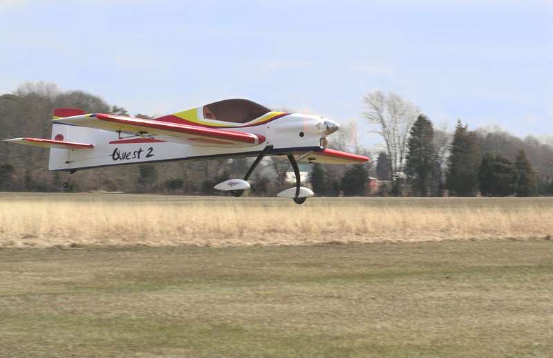

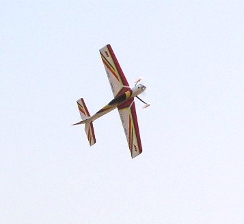

Some in flight pics. Thank to Gerry Geyster for the camera work.
That's a very slow KE in th first picture. You can see that very little rudder is required. In fact I used more rudder for the last picture to do a very slow side slip for the camera.
Although I write this up as a pattern choice for a practice/competition/entry pattern plane, it also has major 3-D capabilities. I just let the young bucks do all of that stuff as my reflexes slow down (BG)
It will do some very good High-Alpha on high pattern high rates. I think that they took some "boring" video while I was in the air. You might keep an eye out for that on the ultra-RC site when they get it loaded.

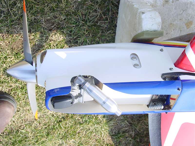

YS 91 needs some cool air. New muffler with steel retainer rring from Dave Schadel.

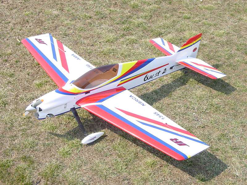

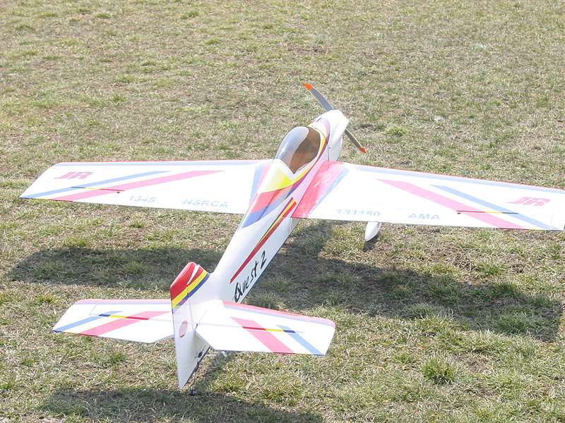

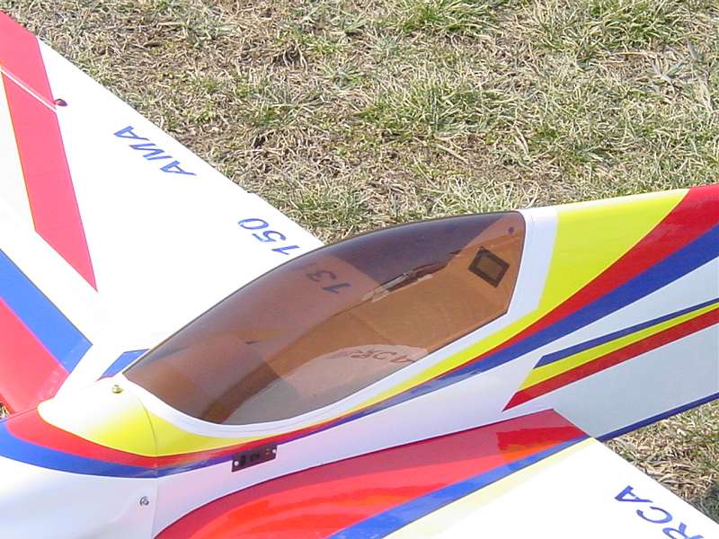

Four more flights today once I fixed a completely stuck closed check valve. (Had a few do this and and I can't see why yet)
Still no KE mixes needed yet. The rolls can be as slow and as long as you like with this plane.
Regards,
Eric.

I did complain about the pipe-tunnel/pan being pre-cut for ventillation. If you use a YS perf muffler then you don't need the cut-outs. I covered the center join with white Ultracote so that you don't see glass-cloth and wing-wood through the slots..
Also I have been using upgraded YS muffler that has a steel ring around the neck near the elbo. It is solid and shows no signs of leaking or comming loose.
