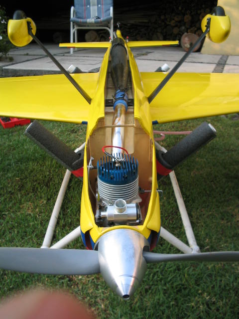

Here are the usual garden shots of the Tempest during yesterdays engine - Mintor 170- break in session . . . the neighbours are away :-)

Looks fantastic, I can't wait ot hear how it flies at that altitude [8D]

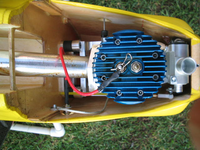

I put a gallon through the Mintor (10% nitro, 20% oil, 17X12), another gallon tomorrow, set the low end and we should be ready for Sunday. Below shows the remote glow setup which, as I learnt later, will not work on a Mintor due to the metal treatment they use. As stated right there on the Mintor instruction sheet, if I had chosen to read it. Ah well. . .
The Mintor runs fine, with power to spare, even at the very rich break in settings.

Rodney,
I had the same remote glow starter problem with my 3M 1.70. This can be solved by running a separate ground wire and connect it to a circular connector. You can get a circular connector with an inside and outside diameter very close to that of a glow plug washer. These appear to be tin plated copper and will substitute for the washer on the other plug. It's a tight fit, but mine works just fine.

Rodney, I have a similar remote glow setup as you have. You can make it work.
Aluminum is a good conductor, you only need to scratch the surface a little.
I tightened the plug once without a copper washer, then scratched surface under one bolt in cylinder/crank joint and under one engine fastening bolt.
After that it worked

Now that is an intelligent, well thought out solution!!! or in other words - Why the hell did´nt I think of that! :-)

Boy, do I feel dumb not thinking of scratching the anodize off the aluminum. However, the bolts connecting the cylinder to the crank case should be properly torqued. It requires a 3MM hexhead socket and an in/lb torque wrench. I got the torque specs from Lance at Aeroslave. It was in Newton meters. I think it converted to 39 in/lb but I could be wrong. Better check with him.

Come to think of it, I don´t really want to fool around with those bolts either. I have heard that the torque has to be just right, or the motor will not run. What is your current pipe, prop, plug set up?
