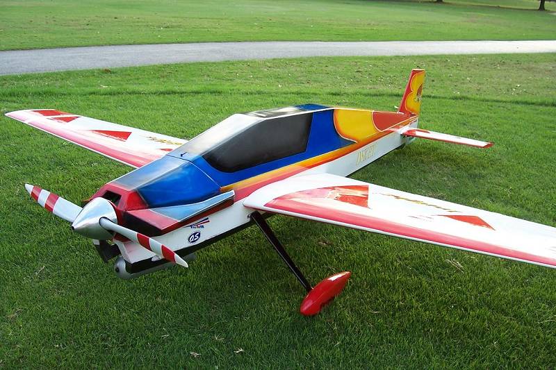

The Insight that most everyone is familiar with (version 4 - see first image) was not designed or ever built with an all built up structure. I have plans...and I believe a set or two of cores (in the attic) for this plane.
There was a version 1 Insight a couple years earlier, which was completely built up (see second image, etc.). Those plans are out on the internet somewhere for free. I can email them to anyone that wants them too.

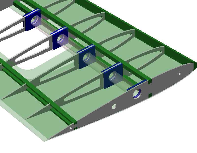

When building the fuse, you will want to keep the fusebox flat and straight on the worktable. When this box is built and sheeted on top and bottom, you can carefully glue in the stab (please see post #34 on page 2 of this thread). Set the stab at -0.5° incidence.
For the wing, it is really important to have a set of adjusters to fine tune the wing position. The wing incidence on my Insight was +0.75° .
In post #49 and #50, you can see the process I used to insert a wing tube sleeve through the fuselage. The wing cores were carefully drilled (home made jig) with a sharpened aluminum 7/8" wing tube. The very first Insight had built up wings which had oversize wing tube holes in each rib. A balsa donut was made to fit tight on the wing tube sleeve at each rib location. The wings were setup straight and level with the fuse, wing tube, and socket, then these balsa donuts were glued in place (see attached image).
I will be glad to answer your questions as often as I can.

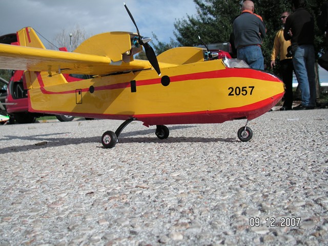

This is a link from our greek forum!!!
I recently had an accident with a QUEST50 (broke the Fuselage) so i had to build one from scratch!!
I picked up the pieces from the scene of crime(!) and re builded it piece by piece and then devided in pieces as from company and then copied them on wood!!!
here are the results
http://www.aeromodelismos.gr/index.p...c,917.260.html

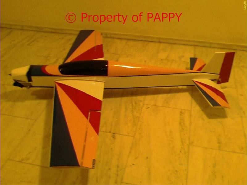

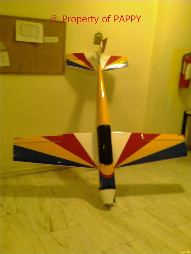

Thats my baby!!
I preferred to alter the canopy design a little bit!!!!

Pappy,
Great job!
Did you use foam for the wings and tail, or are they built up from wood?
-mark
