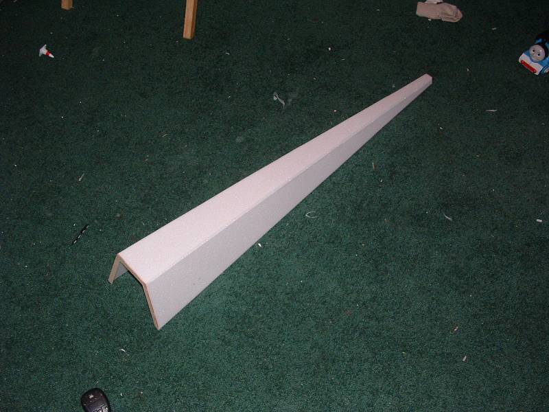

Wanted to add a few pics before the night was over... I will fill in tomorrow with info to go with them.
Enjoy [:-]
The rear top turtle deck built up in depron.

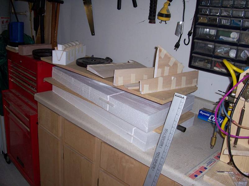

I did get some formers cut out....thought I would try some of this laminate stuff. Weight seems to be about 20% less than 1/8" lite ply and it is plenty stiffer. The c.f. piece will be the firewall.
-mark

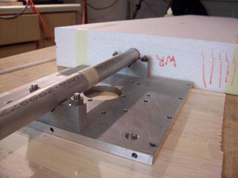

I've got all the foam cores cut for John's Insight.....
Setup and cut the wing tube holes......
-mark

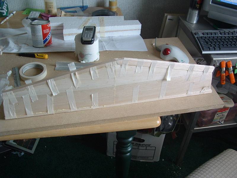

Made a little progress last night on the stab. Glued the sticks on and lots and lots of sanding, and a little drinking.
ok ok , so it was a little sanding and a lot a drinking cause i sanded the trailing edge of the stab for the hingline. DUH! oh well, it will look pretty but a little overboard. oh well.
enjoy... tonight try to align for mating to the fuse and possibly doing the deed. also a shot of the help marks supplied when sending me my cores already sheeted.. what a guy.. still hasnt told me the damage yet
Chuck

With a lack of alcoholic beverages....I was able to start capping all the sheeted tail surfaces. As you can see I cut away the elevators and rudder and capped with 3/8" (light) balsa sheet. I concur with Mr. Hester about using 4-6lb sheets to make the hinge lines and leading edges....hobby store stuff is made for house building.
Also forgot to mention that the sub ribs and sleeves are now in place (glued with polyurethane glue). The wings should soon be ready for sheeting..
