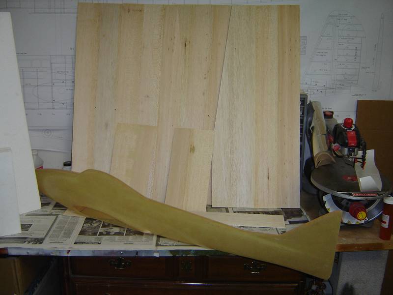

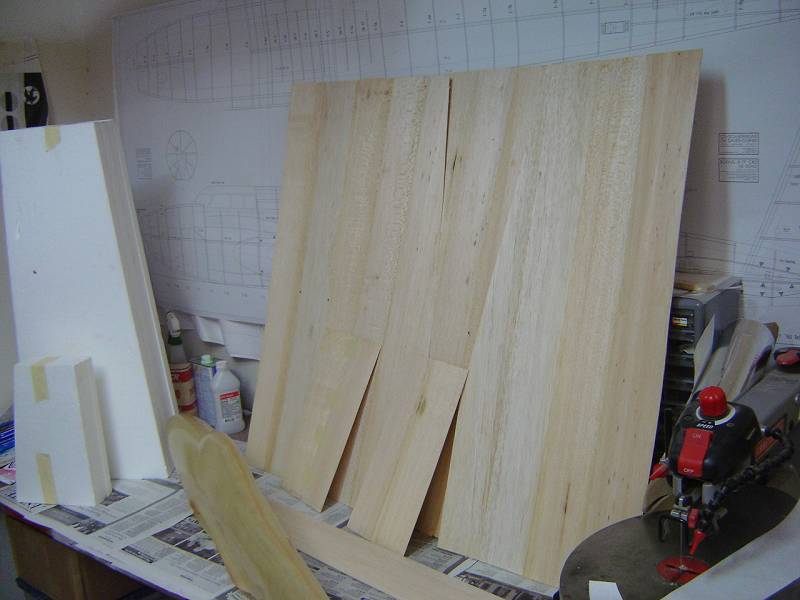

Hi Steve and every one,
I taped the 3/32' wing sheeting together, electing to use wide regular masking tape to hold them in place while the Ambroid Se-Cur-It resin glue drys. There were a couple good ideas here but I ended up using the 'Ambroid white glue,' it dries very fast-Next I will lightly sand the wing sheeting and trim (per plans.)

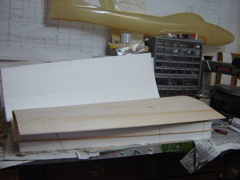

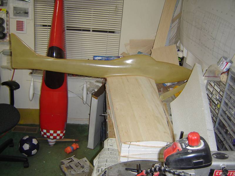

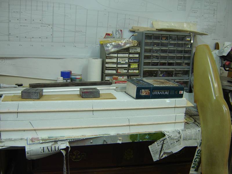

Mixed a batch well maybe two of epoxy and coated just the skins as I put them in the wing cradles . Its been a while so in the morning I will see what we got[sm=thumbdown.gif][sm=thumbup.gif]

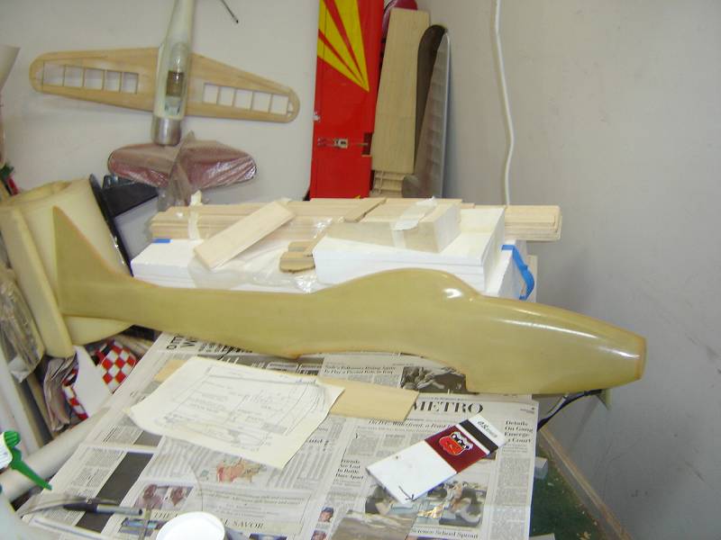

Well here are Pics. of the 3/32" balsa skinned wings for now
