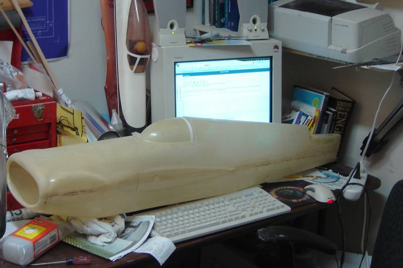

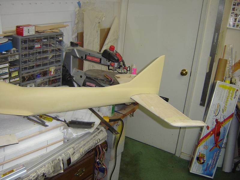

Some up date photos what we got is the necessary material tack glued W/5 Min. Devcon and ready to be carved ,sanded and hollowed. Golly!!! and I just cleaned my little but nice shop[8D]

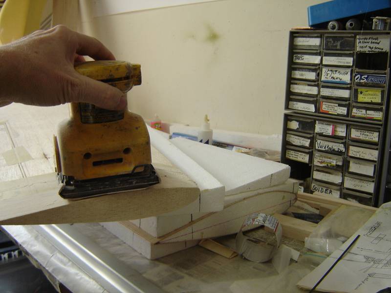

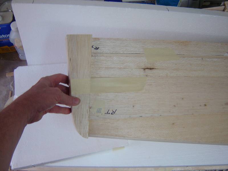

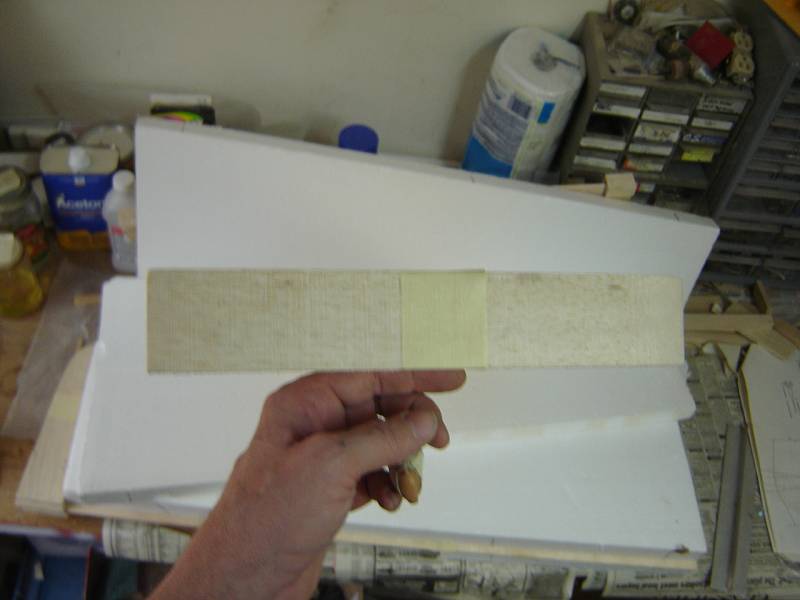

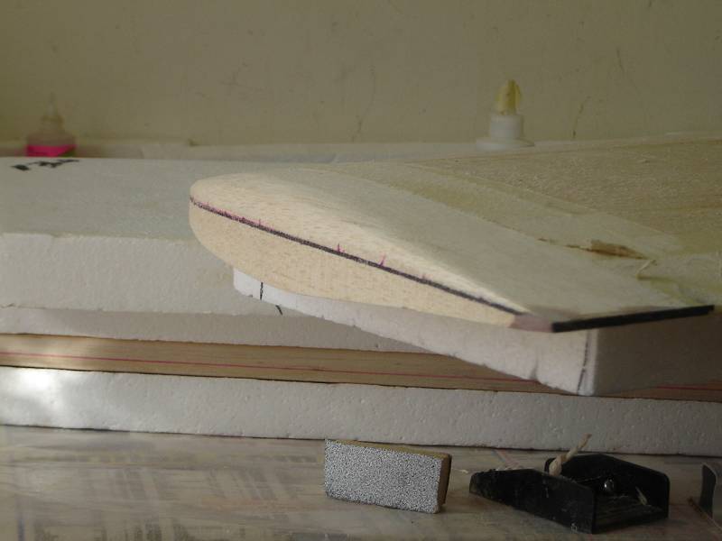

Default RE: Plans or kit :Tigertail IV??
Well now that I have the thread I was looking to post on here are some pictures of the wing tips taking shape and making a mess of the shop but what the heck its BALSA[8D]

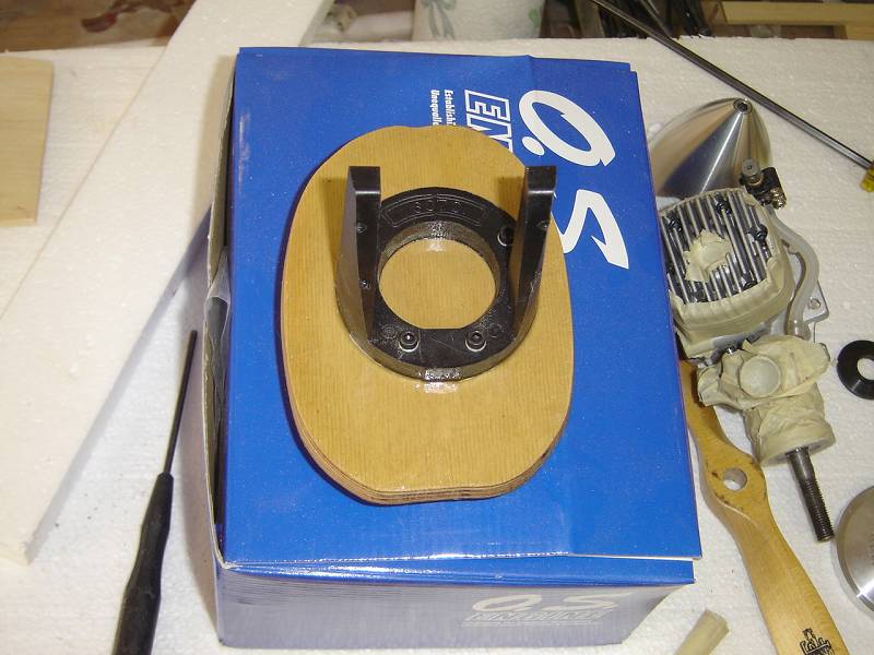

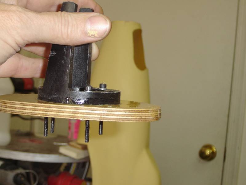

Got the O.S.91FX wanted the new 120 but the 91FX will be good I'm sure.

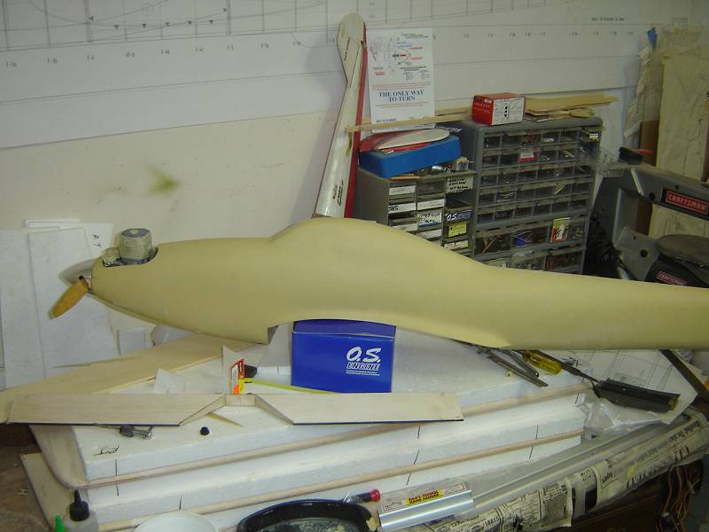

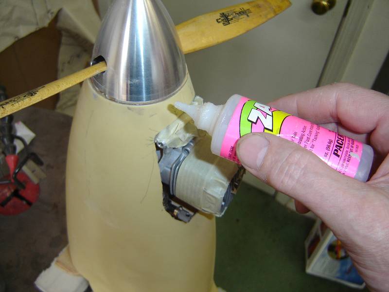

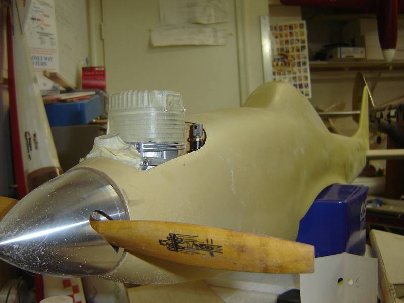

To mount a glow engine in an epoxy glass fuselage like mine you first start with getting the engine inside the nose)-to do that do not sand the seams on the upper nose just yet as you will use this as a "left and right,"measuring reference as you slowly mark and cut.. mark and cut.. UNTIL the engine slips in the fuselage. Think this through as you proceed to position the engine mount on the engine then mark the engine position on the mount remove the engine and mount from the fuselage so you can drill the mount for the engine once thats done tap the engine I went with 6-32 x 1 1/2" socket head bolts which are the same size and length I will use shortly to mount the engine mount to the firewall but thats the next step which begins with placing the engine in the nose---> position the engine mount from the INSIDE of the fuselage and THEN-install your prop spinner with a 1/32 to a 1/16" thickness ply wood spacer situated between the fuselage nose ring and spinners ' back plate.' With the fuselage supported vertically see pictures..center the spinner on the nose ring and tack glue the plwood spacer,which now is an integral part of your engine spinner and back plate assembly! So with this done your engine is in the intended thrust settings of the model in this case my Tiger Tail IV. and you are ready to cut and fit cut and fit cut and fit till the Ply wood firewall fits flush with the rear engine mount. did not confuse any one did I [8D]

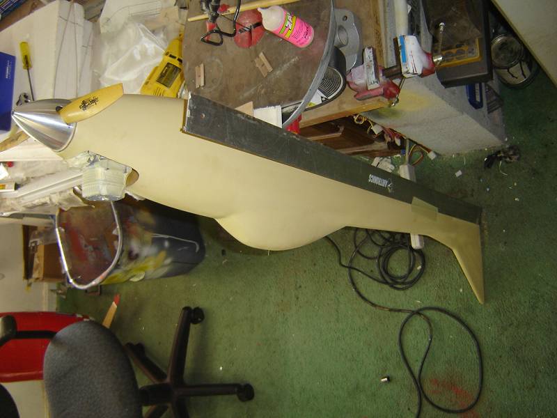

The firewall with engine less muffler is installed and the 30 minute epoxy adding just a touch of chopped glass to the mixture with a 30 minute cure time ,I decded to make some minor (thrust changes,)while the 30 minute is curing and hopefully based on my prevous flying TT IV it might help in dialing it in.
