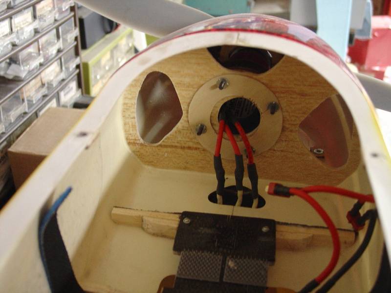

I used the hyde control horns from Central Hobbies, and for the elevator I used 2 servos under the rudder,
mounted to the pipe floor with the carbon pushrod set from Central Hobbies
Aresti-RCU
I would leave the pipe floor in, and for the motor mount just use a lite-ply ring behind your motor mount
to keep the blind nuts from pulling through the balsa firewall. That is how I did it on my ARF Genesis
and it works great. My Genesis ARF with a DZ 140 weight 10.7 oz RTF with NI-Cads

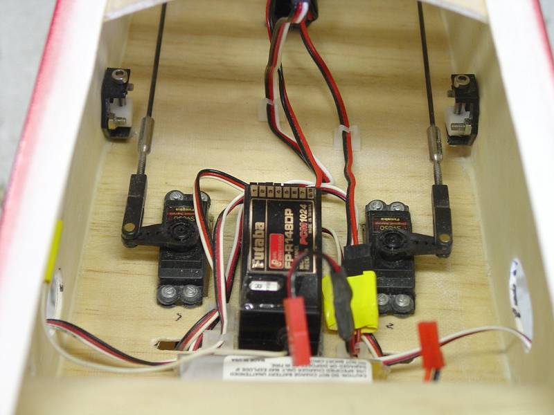

Todd can you show a few more pictures of your electric setup? Are the two servos shown in the picture above controling the elevators?

yes they are the elevator servos. here is a different shot
if you will let me know what you need pic's of I will get them on here

It is hard to tell from the picture but are those elevator pushrods supported? Any reason for switching from servos in the stab with a short connecting rod to this setup?
Which servos are yo using?

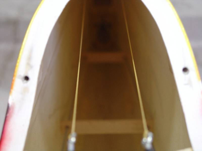

The servos are Futaba 9650's the same as I used in the stab on the glow verson.
The reason for the servos in fuse is some of the of the genesis did not have the
cut outs in the stab for the servos, so it was easier to mount them in the fuse.
The pushrods are supported in the fuse, here is a pic a little blurry but I think you will get the idea.

how did you mount the two 9650 in that position? I see from pictures that these servo have supports for side mouting: how can insert the servo in his hole with those supports? Have you cut them??? ;P

I cut the side mounts off and used 1/16 ply to hold the mounting screws on the bottom of
the floor

Put the tank in just in front of the wing tube and use a lite-ply ring to hold the blind nuts
on the motor mount. I have a pic of the electric that is done the same way but you don't
need to cut the firewall out for the glow
