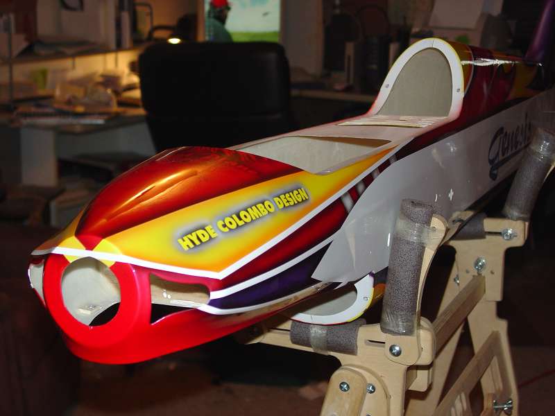

Since noone's submitted Genesis pics, here's a few.......
Old 04-29-2005 | 06:12 PM
rm's Avatar
rm
My Feedback: (27)
Posts: 556
From: ohio
Default RE: Genisis pics

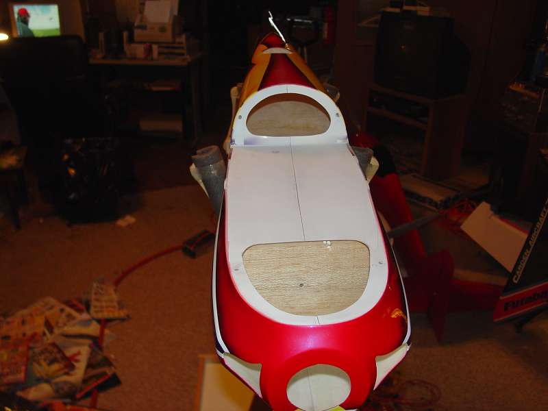

Fuse pics
ID:	264702   Click image for larger version
Old 04-29-2005 | 06:16 PM
rm's Avatar
rm
My Feedback: (27)
Posts: 556
From: ohio
More fuse
ID:	264704   Click image for larger version

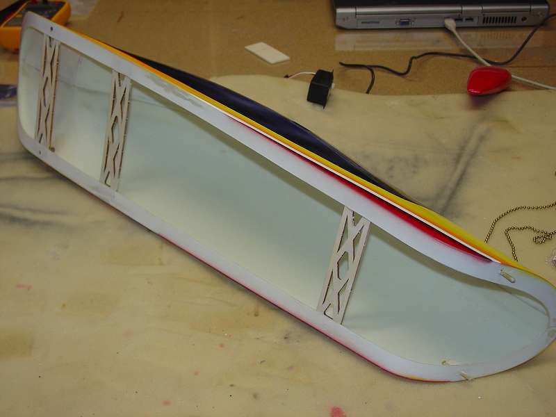

wing top/bottom........servo cut out just right size for a 9150 servo, servo box is lined with balsa, have to add mount.
ID:	264707   Click image for larger version

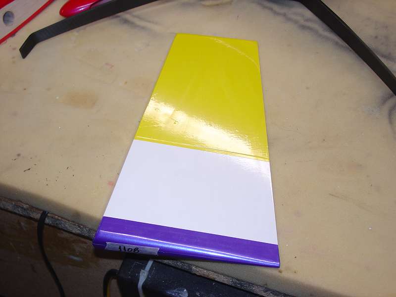

stab top/bottom.....small elevators on this one.
ID:	264711   Click image for larger version

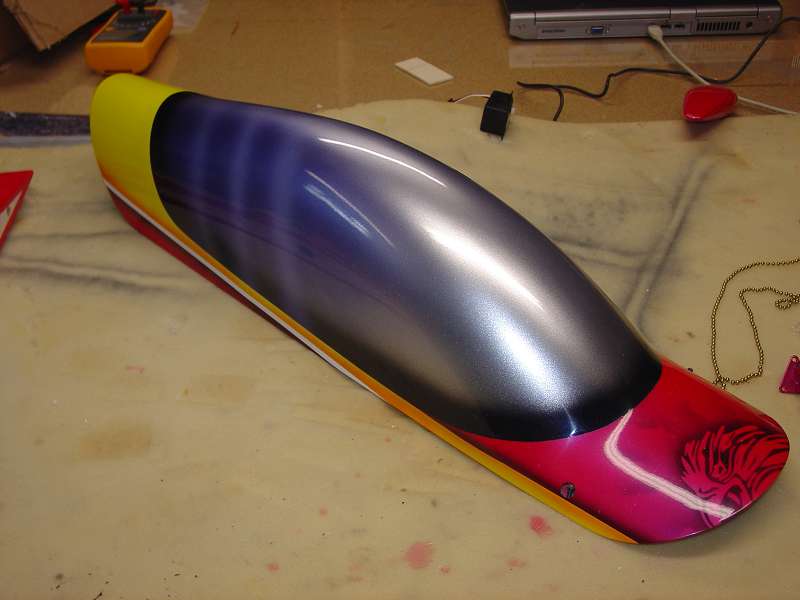

canopy
ID:	264716   Click image for larger version

Misc notes.
Wheel pants, carbon spinner, alum wing/stab tubes 7/8", 7/16, wing/stab adjusters, 2 piece carbon gear measures about 7" come with it. Canopy, chin bolt on with 2 4-40 bolts w/dowels in rear. All hinged surfaces are center beveled. Wing adjusters need to be installed, stab adjusters are preinstalled. I'll post some weights later.
