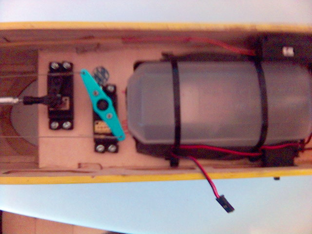

Right, here was my original problem:
I modified the leo for 1 servo per elevator half, so I had 2 servos at the tail. Since I was using 2 servos, I wanted to do some mixing, so I can adjust each half on its own, I set up Ailvator with 0% for the alirons. The two elevator servos plug into ch 2 + 8. From stage one, we had problems. Whenever we moved the rudder, the servo that is plugged into CH 8 starts to glitch and flutter. I even switched the servos round, what ever servo is plugged into ch8, glitchs.
I took the plane to als for troubleshooting. we first added ferrite 'tubes' (jamara ones), now that didnt work. Next thing we tried, was to get the tx, new reciver and servos, away from the plane, and all was good. Next we switched the rudder servo, as we thought it was faulty, still the same!! We tried alot, new RXs new servos! No luck, we even plugged a servo into ch 8, with a extention lead and put the servo miles away from the plane, still the same! We tried everything, but couldnt find the answer! We gave up at the end and used a Y-Lead which I wasnt happy about... at all.

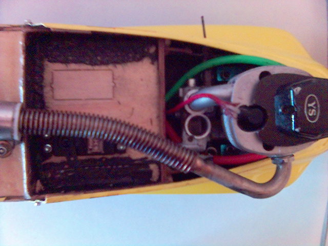

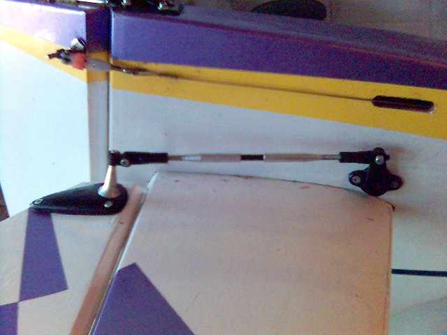

Heres some photos of my Leo...
In photo 13 you should be able to see the carbon cloth reinforcement around the edges that continues up the sides, this is also copied on the Engine mount beams both top and bottom..Essential as the front end has been known to drop off!!
Photo 14 shows the ply plate that has to be carefully removed to gain acces to the undercariage, once removed you will see that theres hardly any material supporting the undercariage. 'Beef Up' with hardwood either triangle or square section, once done replace ply plate and I glassed the entire area with a fine cloth. Anyone using a flexi manifold see the MK manifold support that allows the manifold to move fore and aft to prevent cracking.
Photo 15 shows the 'loading bay'! Tetra tank fitted for use with the YS120FZ servo tray glassed with fine cloth and extra epoxy at the joints, Futaba 9303 on rudder and Futaba 9405 on elevator, note the 6mm carbon push rod fitted with heavy duty ball linkage on the elevator, not the rubbish they provide!
Photo 16 show the rear end fitted with MK Dual Elevator assembly, connected internaly to 6mm carbon rod, 3mm carbon pushrods 3mm clevises and MK large area horns.
Photo 17 shows My Kitchen!! Ohh...with the Leo, Canopy sprayed internaly with metallic car paint (mask the silver area first!) then glued on with Evo Stick Impact adhesive. This makes the plane look FANTASTIC!
Also the undercarriage legs are from my old Flair Yak54 (50size!) exactly the same as the original legs. The ones supplied went all wobbly in the heat one day!!
Hope this helps
