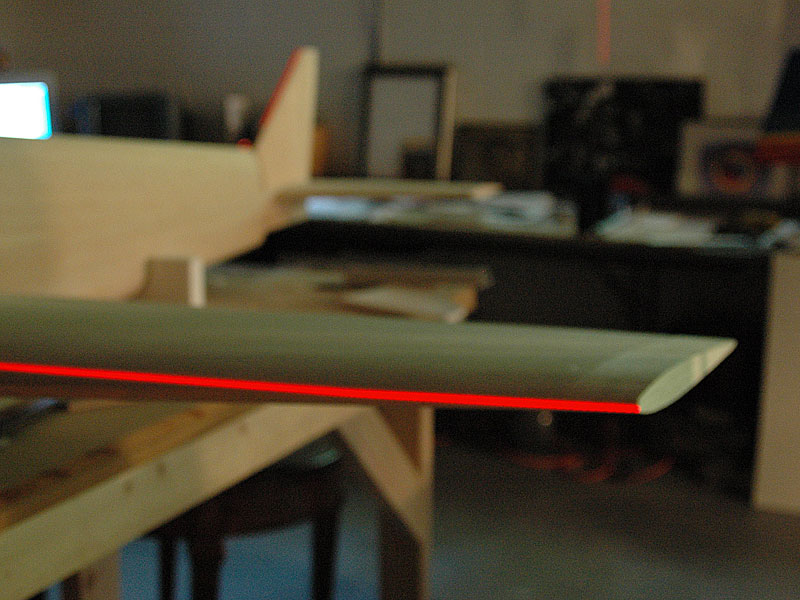

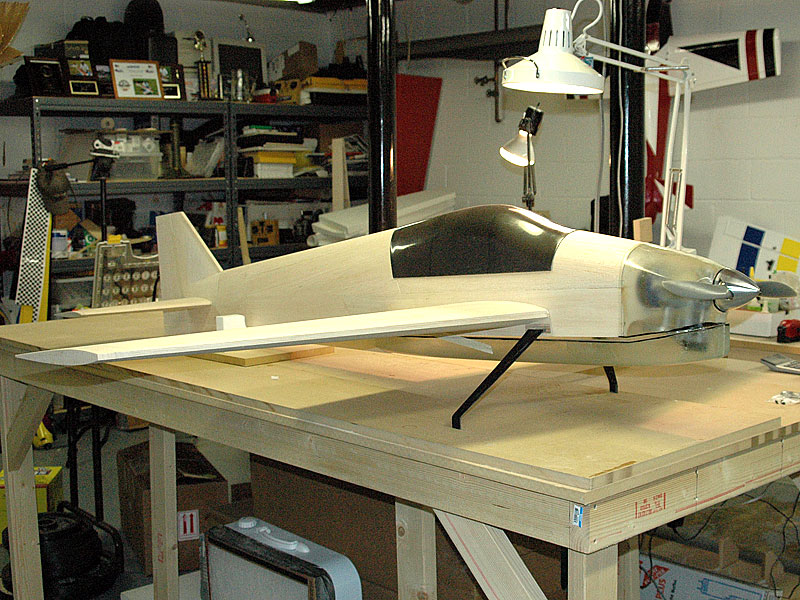

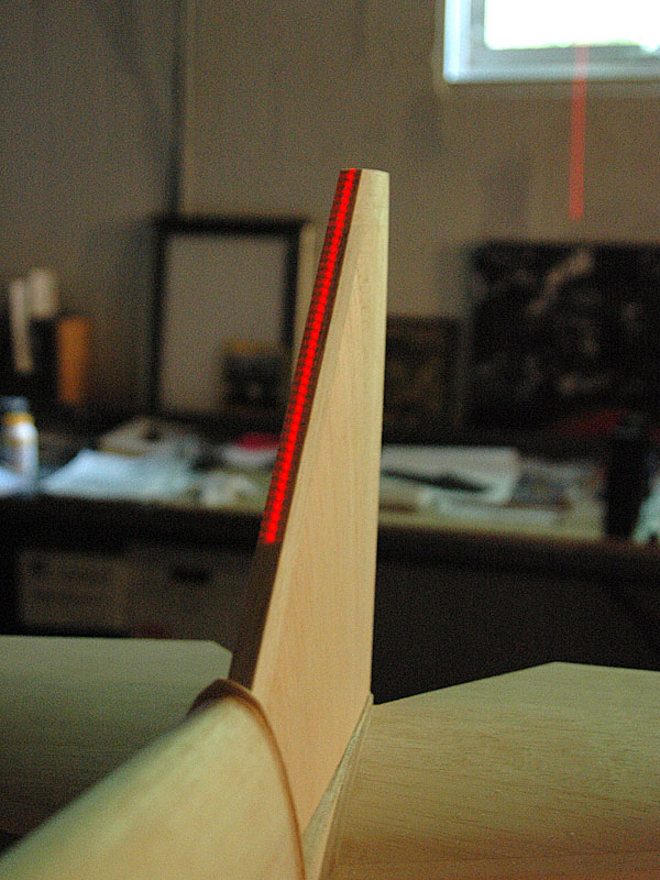

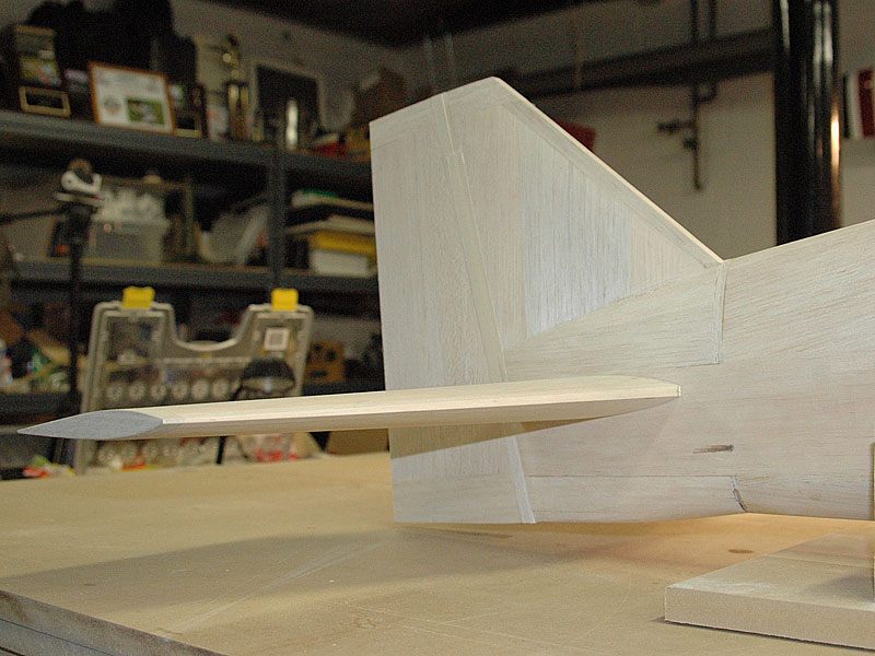

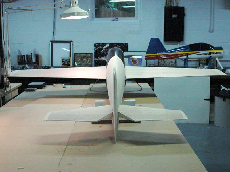

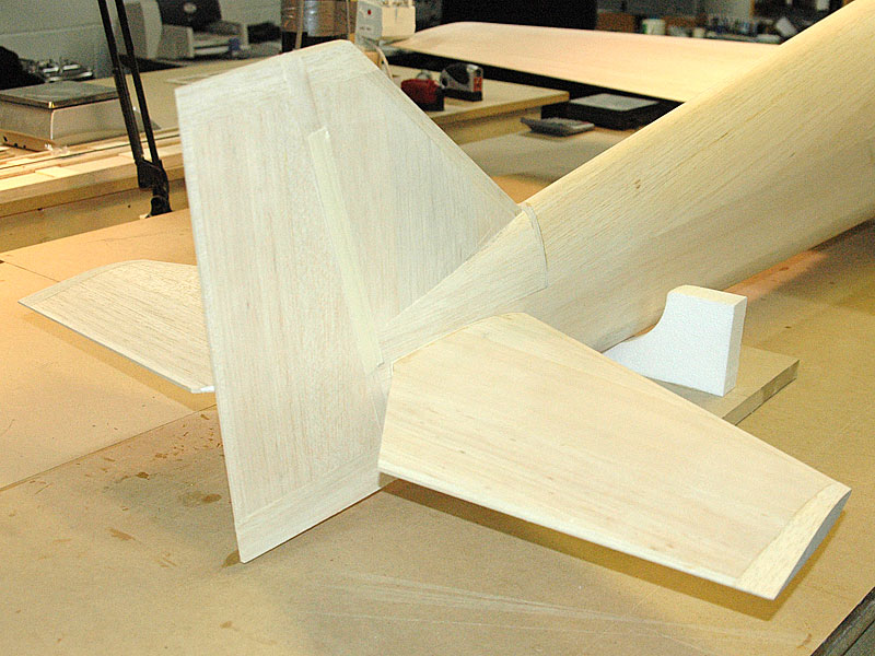

HI All,
Well, I blew off the Culman comp and didn't meet Mike for practice today.
I stayed home and made a big mess of balsa dust. I finished all the major wood builds today. Got the tail together- fin/rudder - my little laser really helped with alignment. - in these pics the lasers look really think, they are actually less than 1/8" wide. really helps to get the fin and everything straight. All the stuff that Mike suggests to eyeball - set up the laser and it just makes it way easier....
The carbon wing and stab tubes are installed. I have the canopy frame cut, just need to glue it all together, and install the cowl and chin install the servos -cut the elevators and ailerons.... a few
more bits than I am ready for final sanding and paint - hopefully not more than another 100 hours : )
good thing this is my therapy.... and the next comp is about 2 months away....
cheers ! ( I am about to crack a beer)
Dean

Old 06-24-2006 | 07:59 PM
  #390
MHester's Avatar
Posts: 2,707
From: Woodstock, GA
Default RE: Black Magic v2 builder's thread! *Updated*
Yeah my Chicago trip got cancelled, but I DID manage to get some practice. Much needed, now I need about 50 more sessions just like that....and there aren't that many days until the nats!
Looking good Dean. You're almost there!
-Mike
Old 06-24-2006 | 08:02 PM
  #391
MHester's Avatar
Posts: 2,707
From: Woodstock, GA
BTW at this point if you haven't already, put the engine and spinner in place, and keep the rudder taped on....and measure the total length. Just make sure, if any mistakes were made and it's a hair too long, it's MUCH easier to fix it now. I seem to remember a certain competitor taking a blade to his wing tips (OUCH!!!) at the Nats a couple of years ago, only to be disqualified anyway...
Since it's home built and very close, it's always a good idea to check at this point.
-Mike
Old 06-24-2006 | 10:59 PM
  #392
handglider's Avatar
My Feedback: (23)
Joined: Mar 2005
Posts: 1,097
From: ,
Hi Mike,
it's 78 7/16 from the tip of the true turn to the back edge of the rudder. whew....
also in that last picture of the plane complete with:
all wood - nothing left to build. landing gear, canopy, canopy frame, all composities, YS 140, Hype ARIS mount, spinner, adapter, apc 16x11 -
I am at 7 lbs 2 oz.
So I am guessing what the additonal 5 JR servos, carbon nomex mounts, JR 649 RX and ext., 2400 lithum, reg and switch, MK links, clips and horns, MK tail wheel, main wheels and cental axels, Tetra Tank, plumbing and final finsih will weigh... ?? - that is all that is left....
I am hoping to get the cowl and chin finished tommorrow....
cya, dean

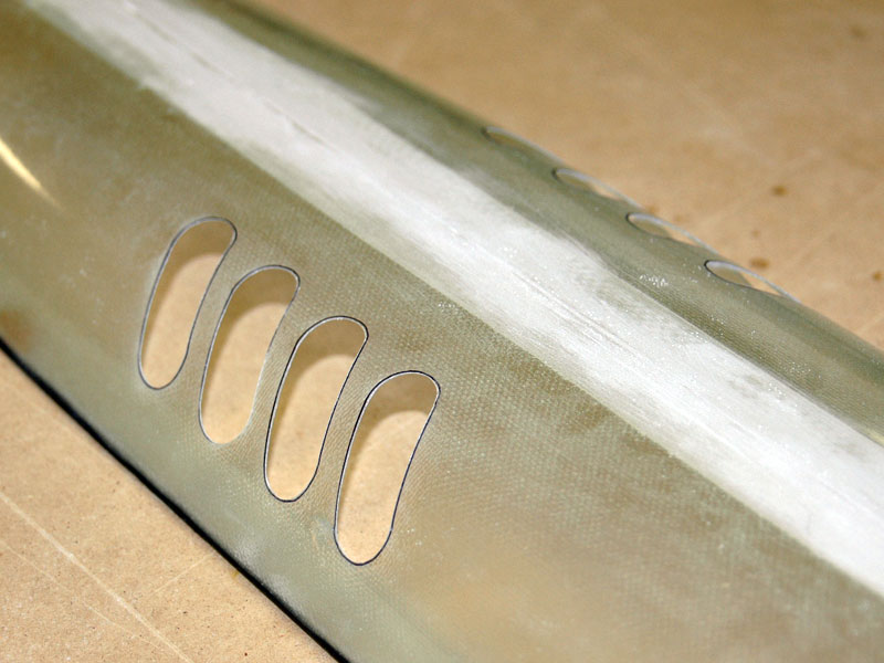

Hi All,
I cut the cowl and chin vents today and cut and faced my stabs....
it's getting closer all the time - I keep telling myself that at least !! ; ) - only joking - but I have spent a lot of quality time in the basement lately....
fun fun fun !!!
later, Dean
