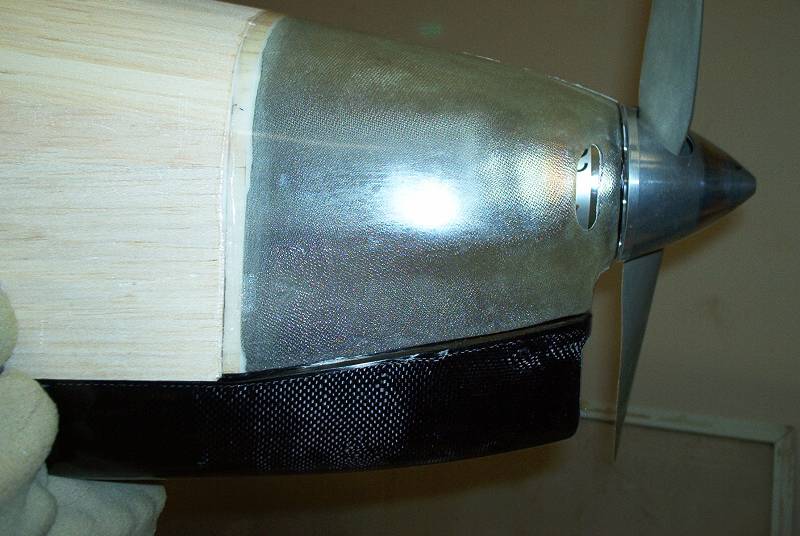

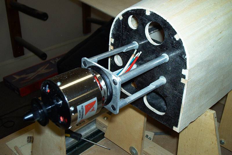

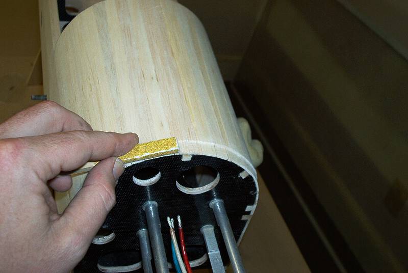

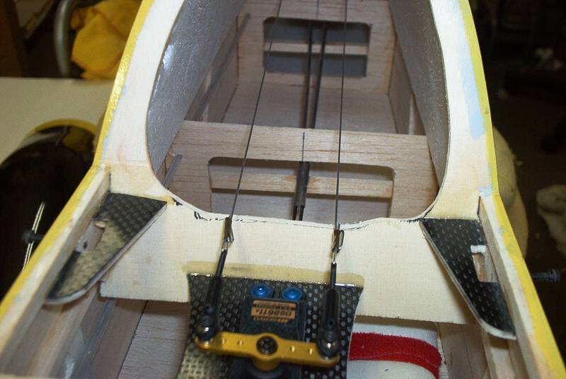

PICTURES!!!!! Post pics!!!

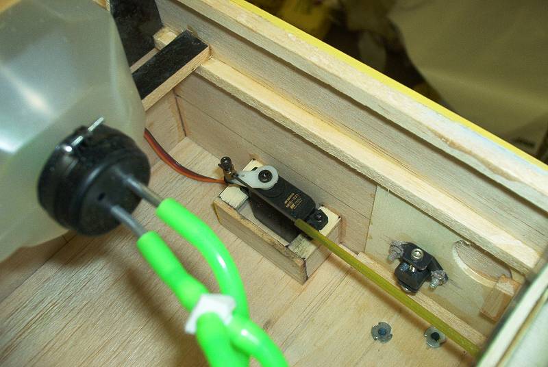

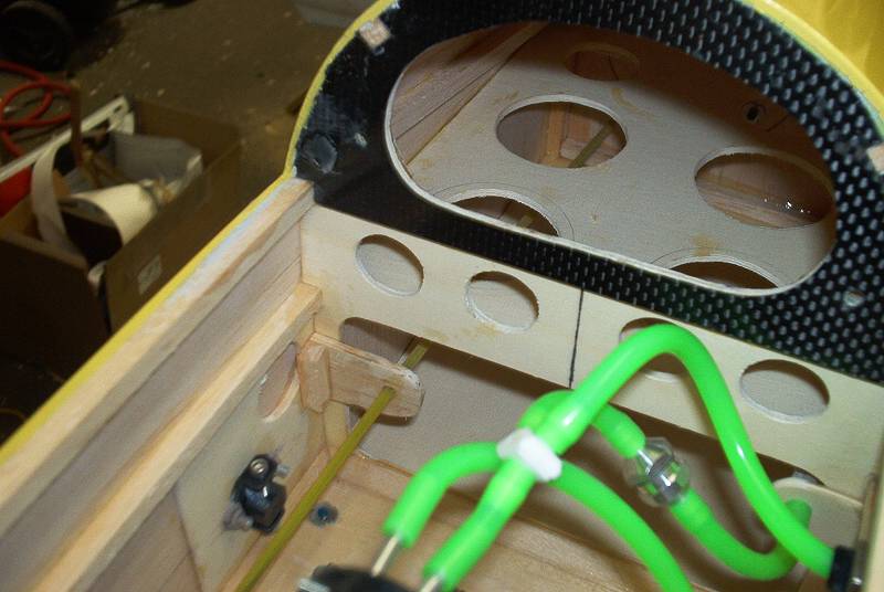

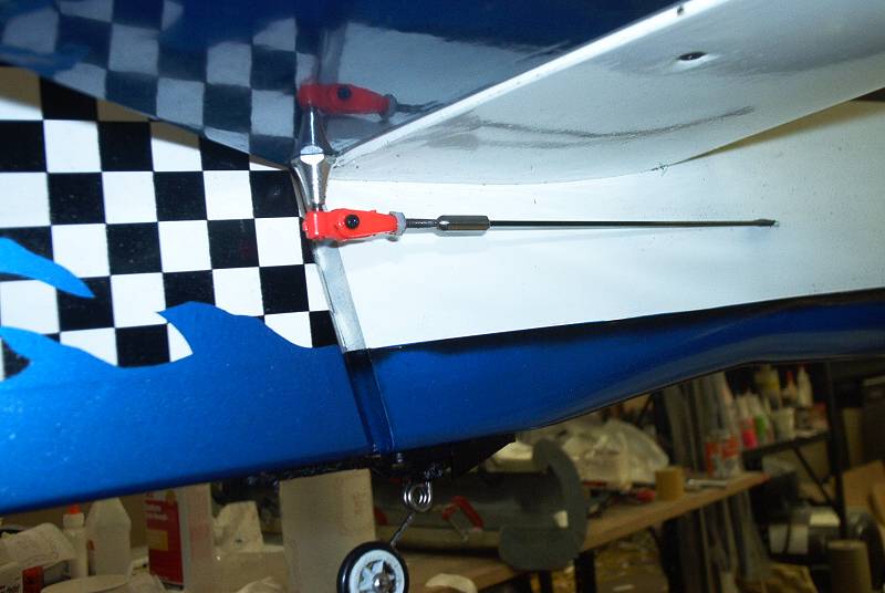

Just a few detail shots. Couple pics of the inside, and take special note of the stiffener at F-4. Also the air dam which I now consider standard equipment.
-Mike

Old 07-04-2006 | 08:07 PM

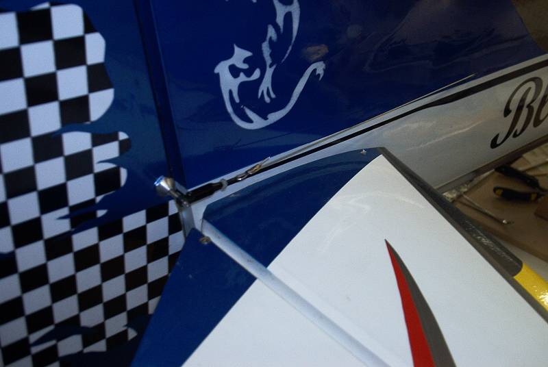

And a couple more....

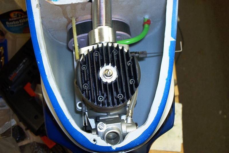

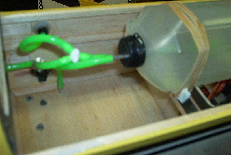

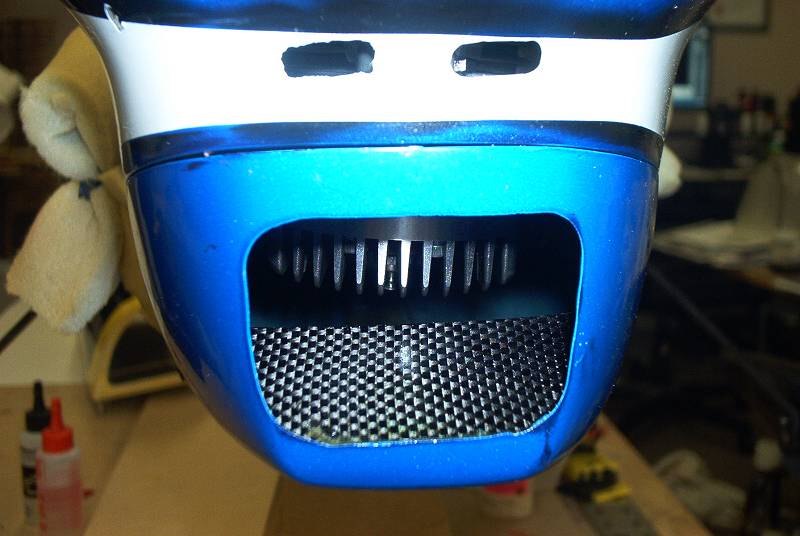

Hey Mike ,
Looks good !! but what is with the funny looking engine , and green tubing and fuel tank...
Hard to run electric that way
Scott Anderson

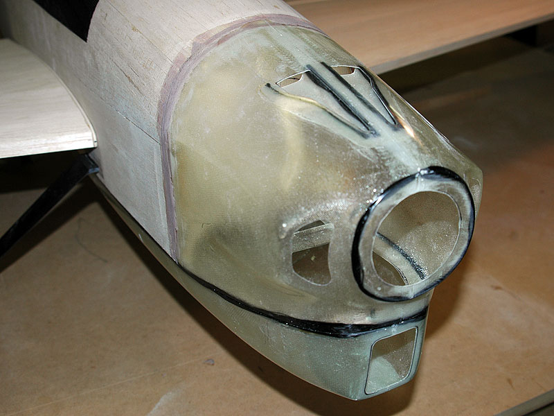

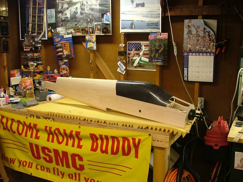

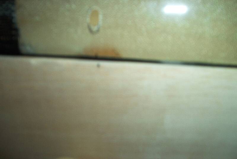

Here's some pic's. Can you post a clean shot of the belly pan. I am having a heck of time trying to get it to line up. I need to slow down on this project. I've made some minor errors. Which cost me even more time. I work alot of hours durning the week so I wont even touch it again till Saturday evening.
Willie B.

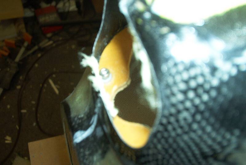

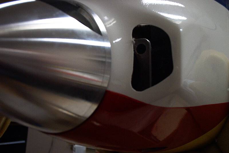

Ok. Lemme dig and see what I can find. I heard Dean had the same problem, which way is it "off"? I garauntee it's something simple (usually is).
This is all I can find right off the bat, I have a bazillion pics.
I do have mine off of #1 right now, so is there any specific area you need to see?
-Mike

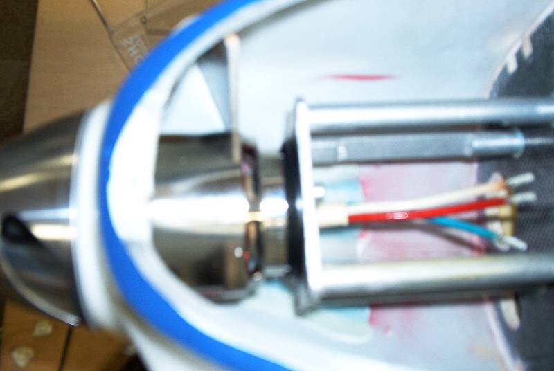

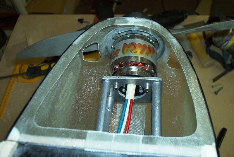

Oh and here ya go Scott, electric Black Magic pics [8D]
Mine are going to have to wait a while.
-Mike

I need to see where it mates to the lower deck and along the frame sides. Mine sits a little low. I will post some pic's later this week.
Thanks For The Help,
Buddy.

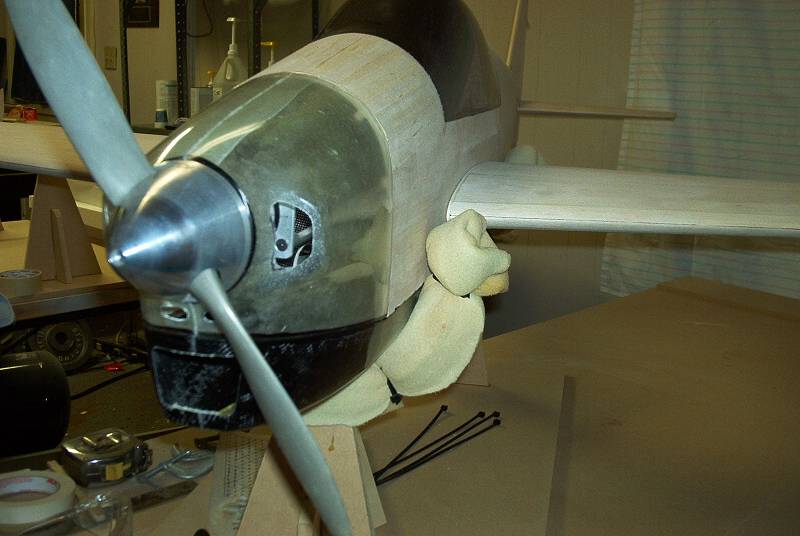

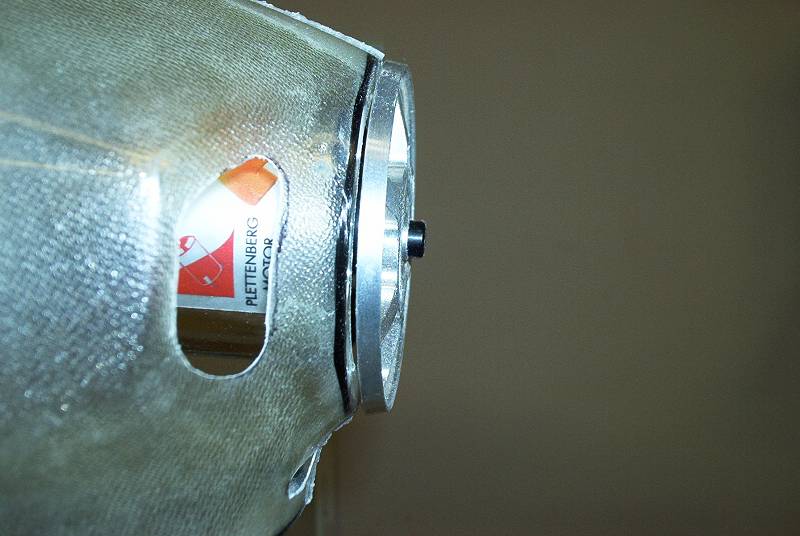

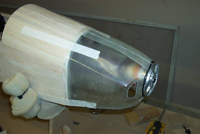

Buddy,
The plane is designed so that you sheet your top around the nose, and rough sand it first.
Then mount the engine.
Sand a lip for the cowl to seat onto the fuse, and slide the cowl on over the engine. The cowl must be trimmed at the rear about 1/4"-3/8", and the distance from the spinner back plate to the firewall is about 6 3/8". Leave a small clearance between the spinner and cowl of about 1/16".
It is common practice to have to sand the bottom there and "raise" the cowl very slightly. This will leave a slight gap between the cowl and belly pan at the engine compartment.
After the cowl is glued on, take a lagre block sander and work the bottom of the fuse so it fits better. you can still leave a slight gap, because of the way the belly pan is shaped, when you tighten your front screw it will pull it all tight.
I hope that made sense. if you need more help, you know my #.
-Mike

Oh and if you mean it's low where it meets the rear belly core, pffft lay down a piece of 1/16" balsa on the fuse and stringers and sand to fit. I love wood.
-Mike

Works for me problem solved. The only way I could see solving my problem is what you desribed. If I flexed the belly pan to raise up to meet the rear belly core then It through everything else off.
Thanks Buddy

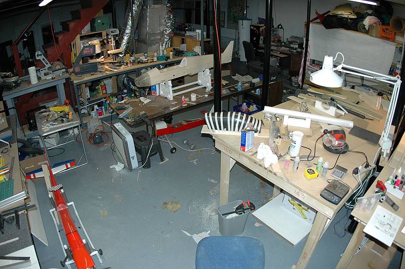

Hi All,

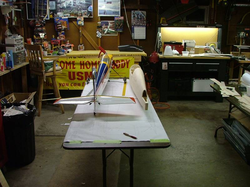

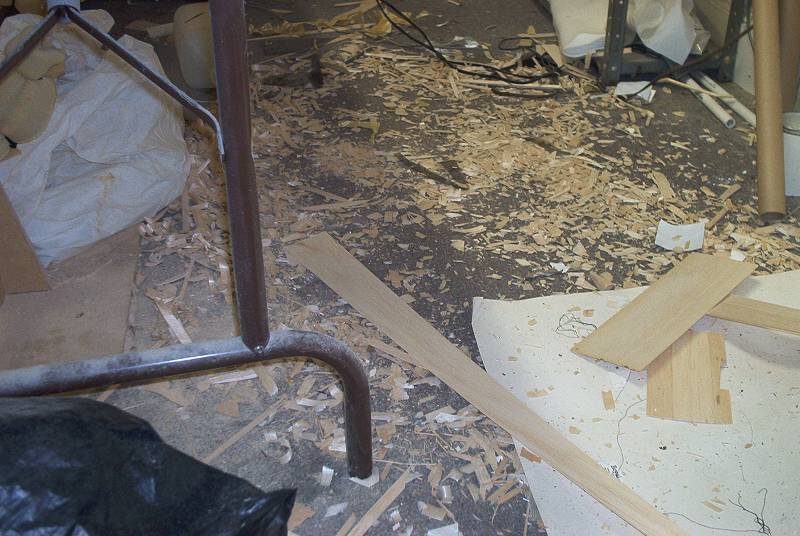

I am trimming my canopy now, just had to share this picture of the big mess in my shop - remember back on page 6 or so.... how nice and neat everything was..
well forget about it. this place is a toxic mess.....
Had a busy few days here - the plane build is done. It's in the bones now.
I need to trial fit the electronics and start finish....
yey-haw...
about to crack another beer! (#150 I think)
I'll post some pictures once I clean up this dump....
Cheers!
dean

ORIGINAL: handglider
Cheers!
dean
pWn3D!!!
LOL
Post those pics!

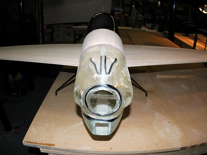

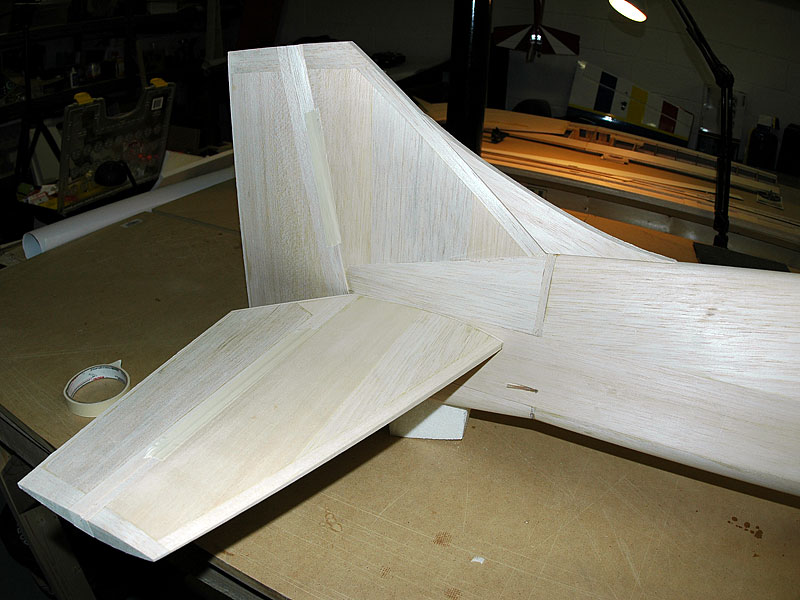

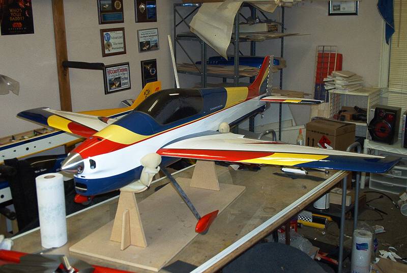

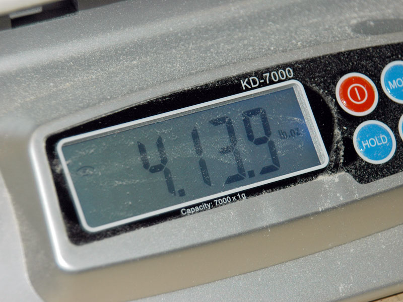

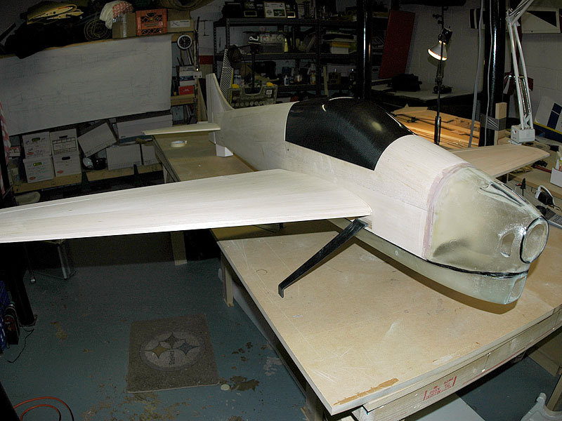

Hi All,
Here are some pics, the build is basicly finished. I have equipment and mounts next. But I am happy happy happy !! This is one bad mother !!!
The airframe fully asambled in these photos is at 4 lbs 13.9 oz - that's the complete airframe. Not sure where it's going to end up at but this thing is really really big, really strong and very light....
the cowl and belly went on nice and the canopy fit is tight.
Dang this beer is tasting GREAT !!!!
loving this plane, man it's awesome !!! it's beautfull !! loving it!!!
cheers, Dean

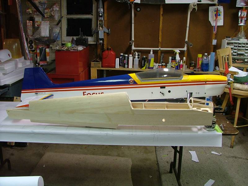

here is the one of the scale
