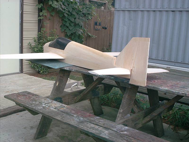

I got my wings sheeted yesterday an installed the wing tubes an said to my self lets see how they look an when I put the wings an stab on an steped back, I said to my self " DAM thats thing is big"

Yeah, just wait until you try and fit it in your car! I had to rethink my method of transport.

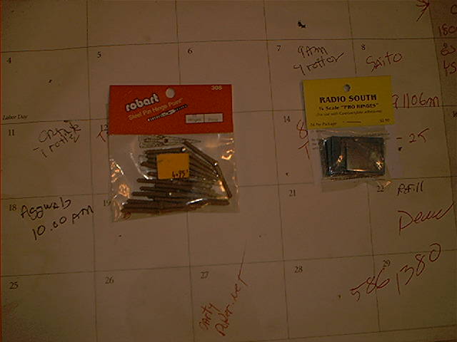

Default RE: Black Magic v2 builder's thread! *Updated*
which of the two would you use for the BM. I,ve used both with good results. The Robart have good holding power using monkey grip but the Radio South hinges allow for sealing the aili real tight Any sugestions before I slot the T E an L E.
Old 09-13-2006 | 06:28 AM

Here's what they look like.

Radio south, no question. Think light.
