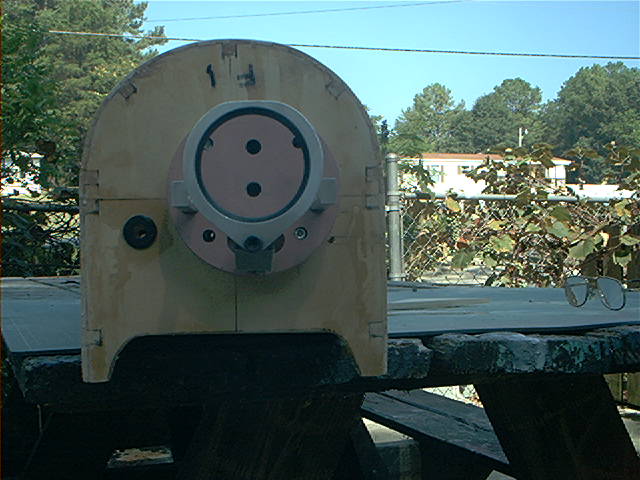

I.am trying to button up inside the fuse so I want scratch up the paint, Trying to locate the fuel tank an the hold downs. I went to Wally-World this morning an found 2 different type of straps an I think both would work great, well see. Both are Velcro

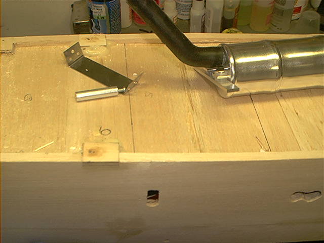

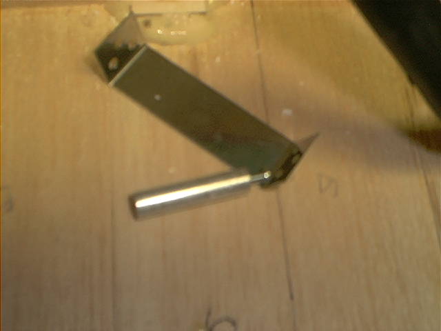

Her I am with more ?'sOn the photes of the muffler brackets what are they an how are these used, I just cant figure these out. No Instructions for this.An on the photes of the covering an paint, I am not fiber glassing, I am Monotcoting except for the composites.I aplyed coving to balsa ( Insigna Blue )on both. On one I sprayed missle red with a top coat of Plasti-kote Super EnamelWith a great finish except as yoyu can see rain drops other that that it would have been perfect. An on the other I aplyed covering an then the plasti-kote Enamel with out paint an it blistered real bad so that one is out of the ? The first one has some hope, weather it will last

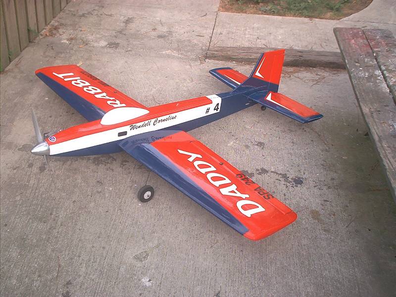

Her is a piture of the last plane I built, All I had was a set of plans An got the cores from Dennis Hunt for a Daddy Rabbit.The Black Magis scheme is just to complex for me an on the fiber glass, o- Well I have to much money an time involed in it to ruin it. So I am going to Lustrekote an monokote. I am pertty good on the iron an spry cans as you can see. With that what do you all think of this red, white an blue color scheme along with the need vinyal,s. Or how about a copy of this plane.

Here's the pic.

Looks great but to me a dark leading edge is difficult to see coming out of turn-arounds.

These colores have been used a long time in SPA with no complaints from the Novice, Sportman an experts in the SPA. As for me I have had no problems seeing the plane on turn-arounds. I have my first place awards in Novice an starting in 2007 will move up to Sprorsman. If this BM flys real good I will use it next year in the AMA.
